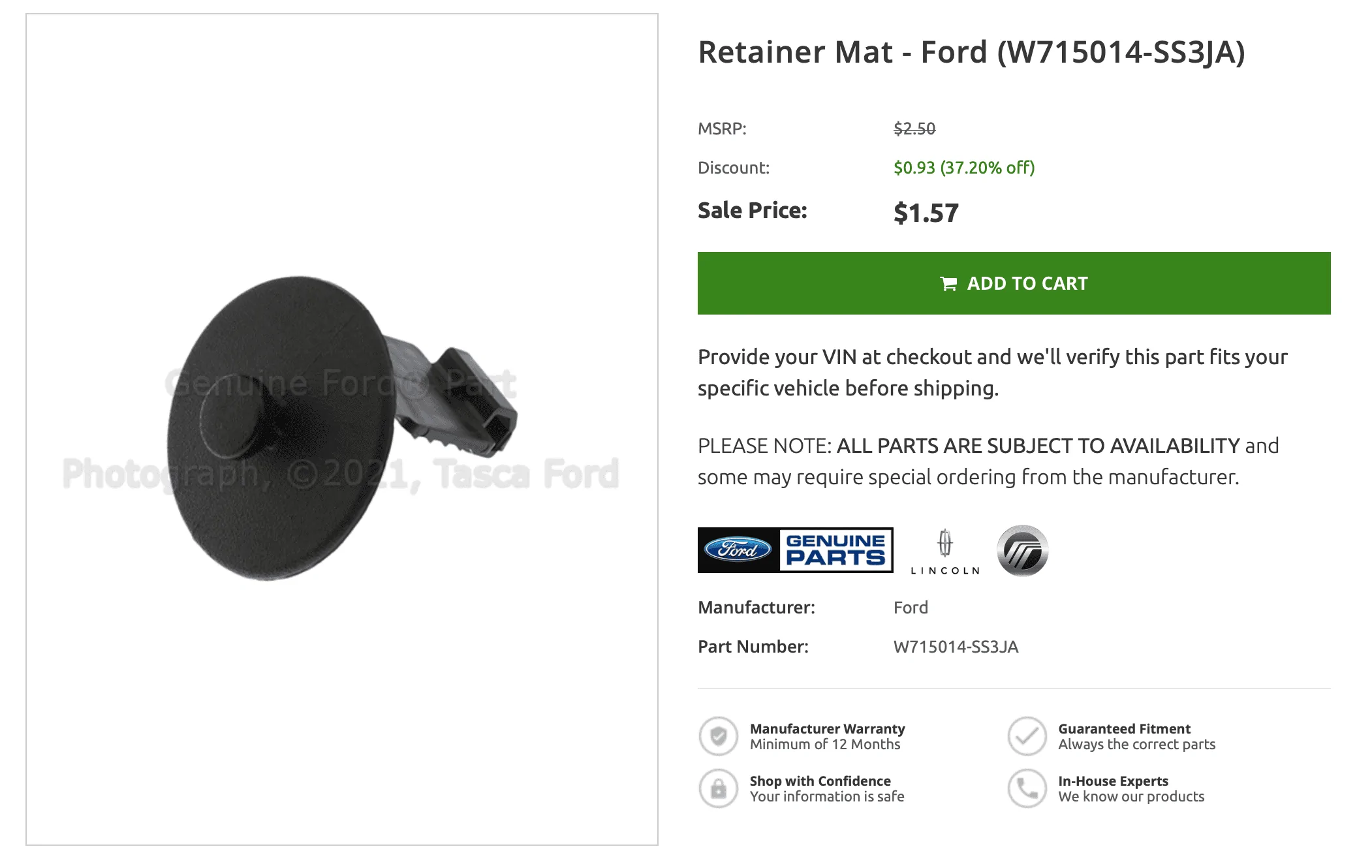

Has anyone added these to their passenger side carpet so that floor mats similar to WeatherTech can clip in like the driver side mat does? My 2022 does not have them.

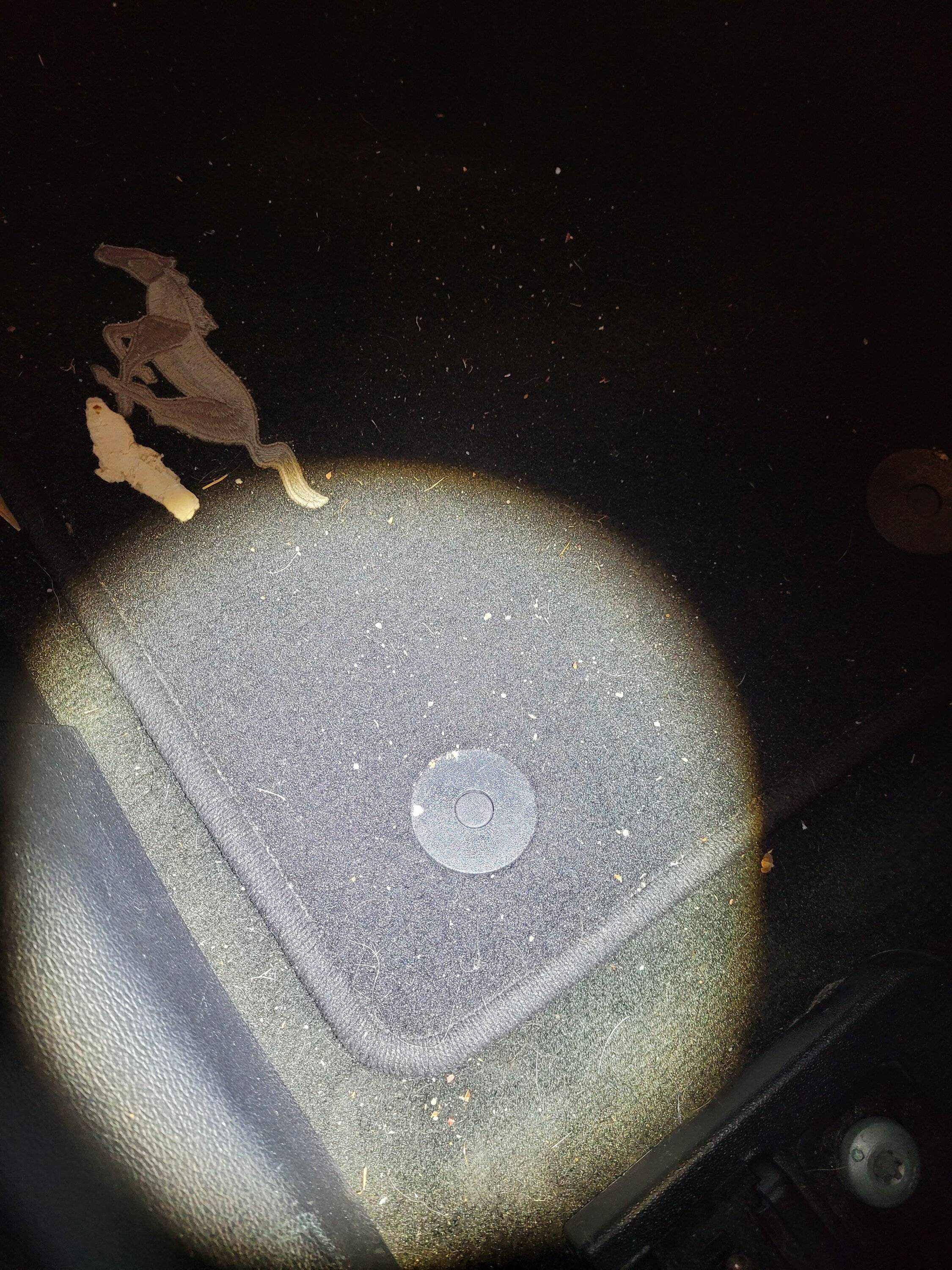

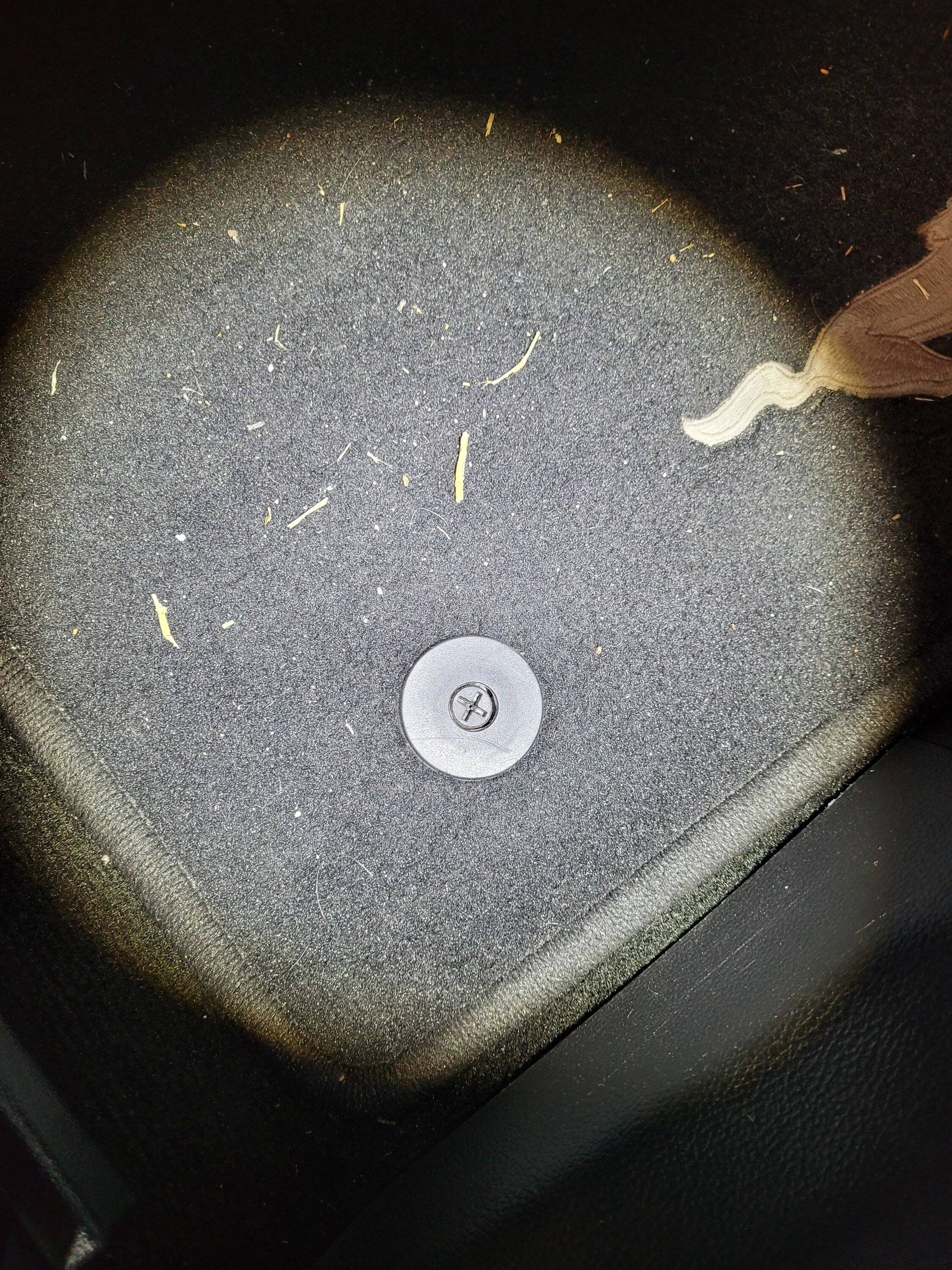

Not those exact ones but something similar. Mine required drilling/cutting a hole into the mat then a two part piece sandwiched the mat and clicked together. The button screwed into the carpet. I love the results. In the pictures the factory ones are plain and the added ones have a cross in them to screw in with. You'll have to excuse the dirt, it's my DD and I haven't vacuumed it in a couple of weeks.

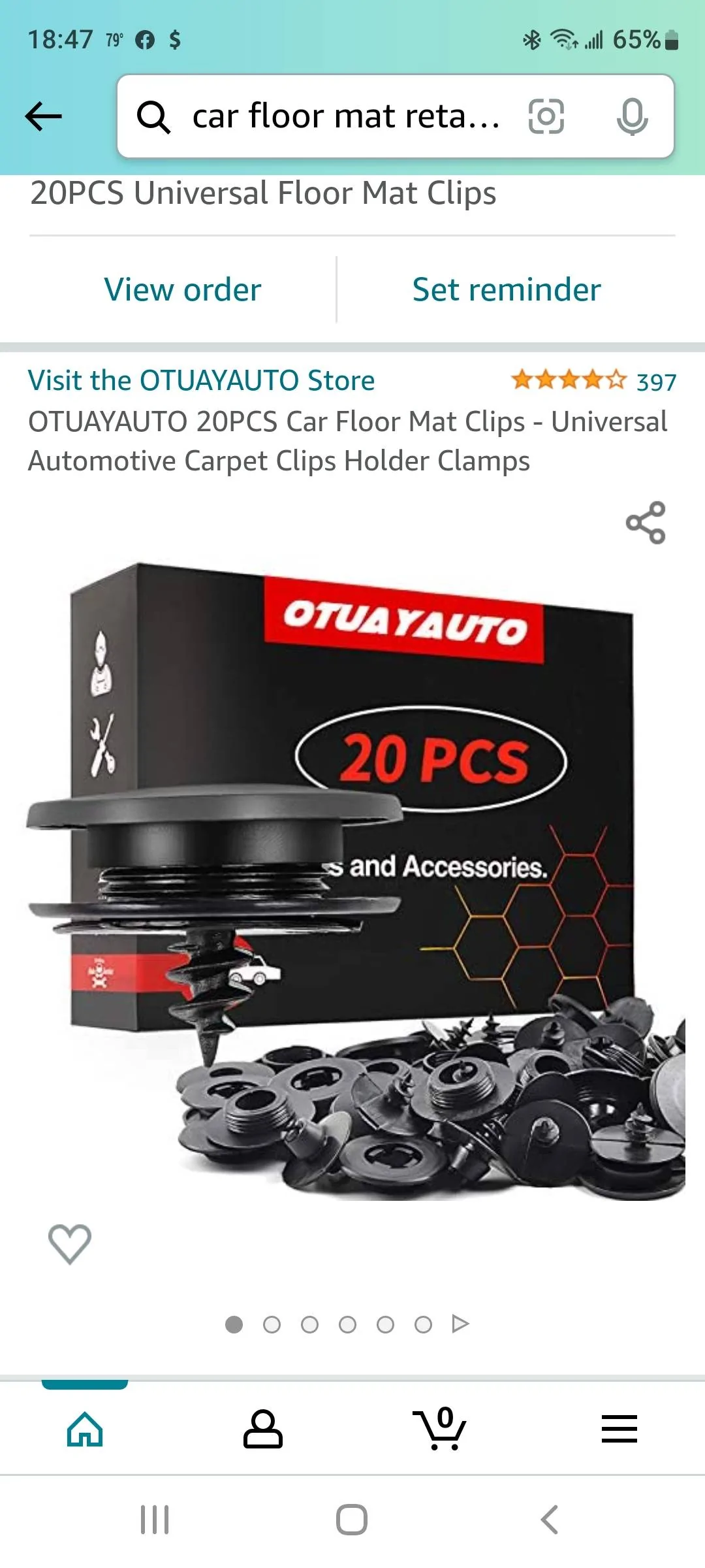

Not a link but they're still on Amazon.
I used my smallest hole saw attached to a drill and backed by a scrap piece of wood and the hole was perfect.
