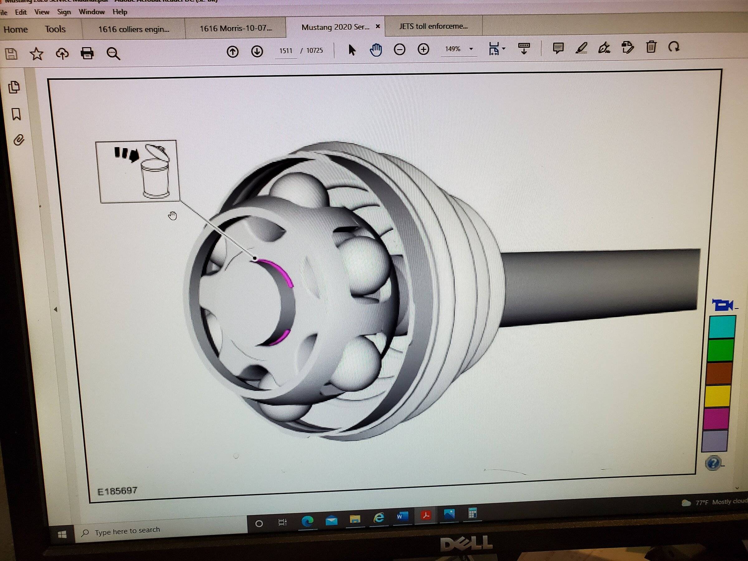

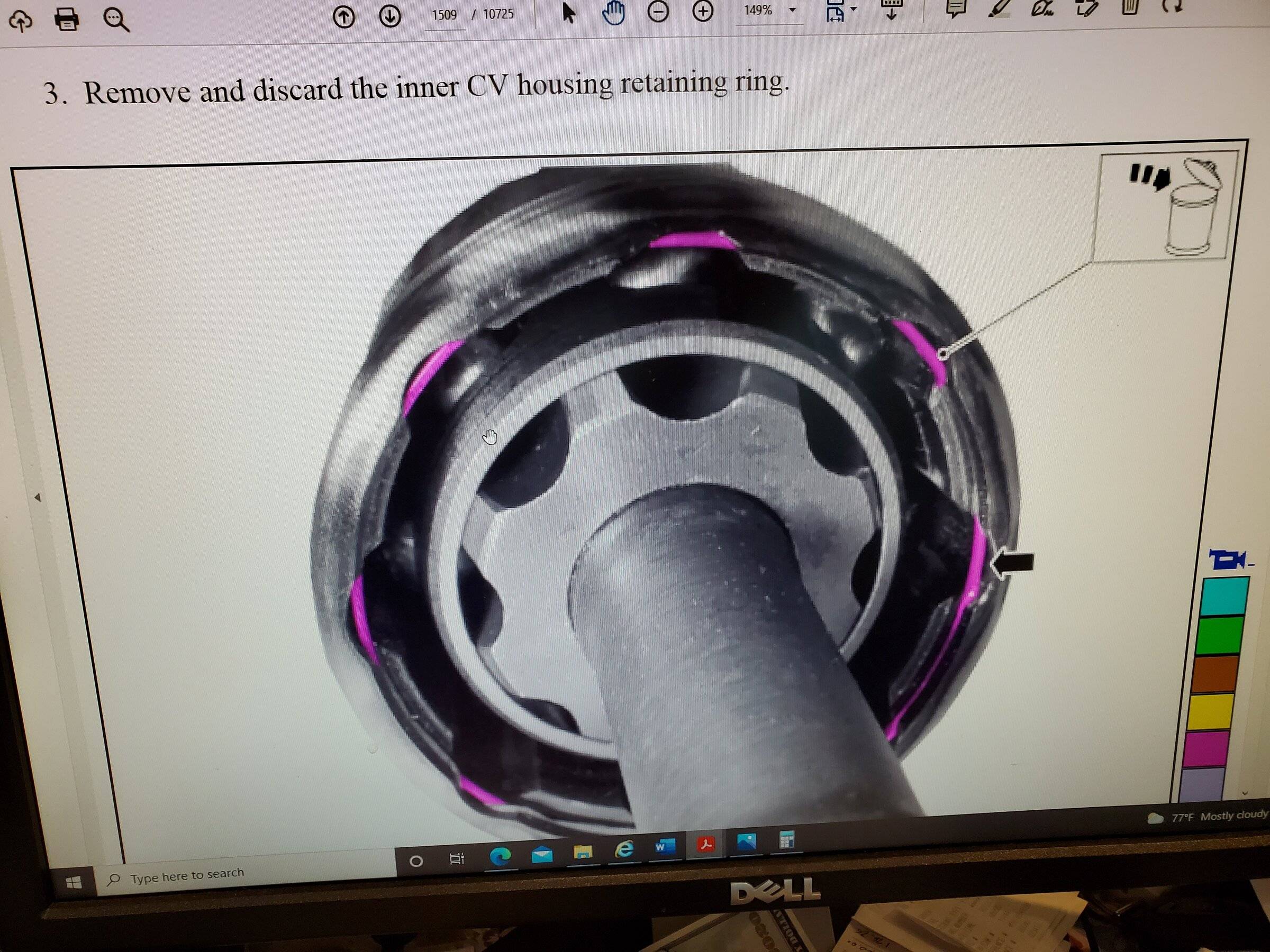

I plan to do an inner CV joint rebuild on several like new half shaft takeoffs. The shop manual has the procedure and it is very straight forward. However the procedure directs that the joint cage circlip and the housing retaining ring be discarded after removal.
I stopped by my parts department today and I was told you can't buy those parts.
Does anyone have any idea if these parts are available as standalone parts? I dont get how the shop manual would direct that they are a one time use, but you can't buy the parts as standalone.
See diagrams below.

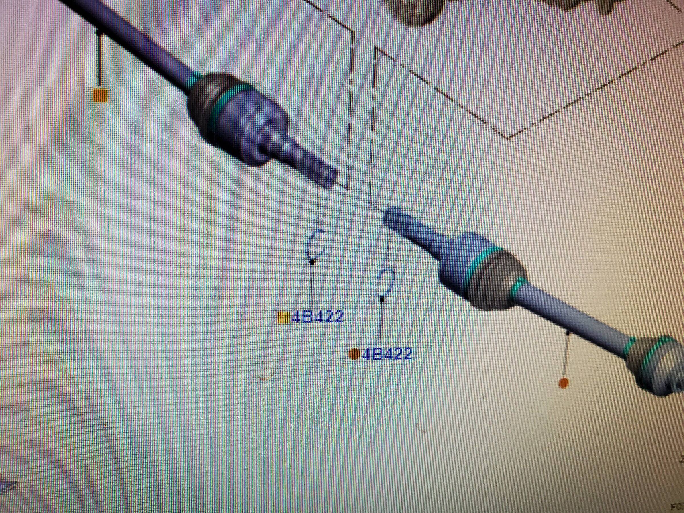

1L2Z-4B422-BA

There all the same from 07-21.
The reason I say is that the oem boot size is specific to the 500.
Do you have any more info on this part?

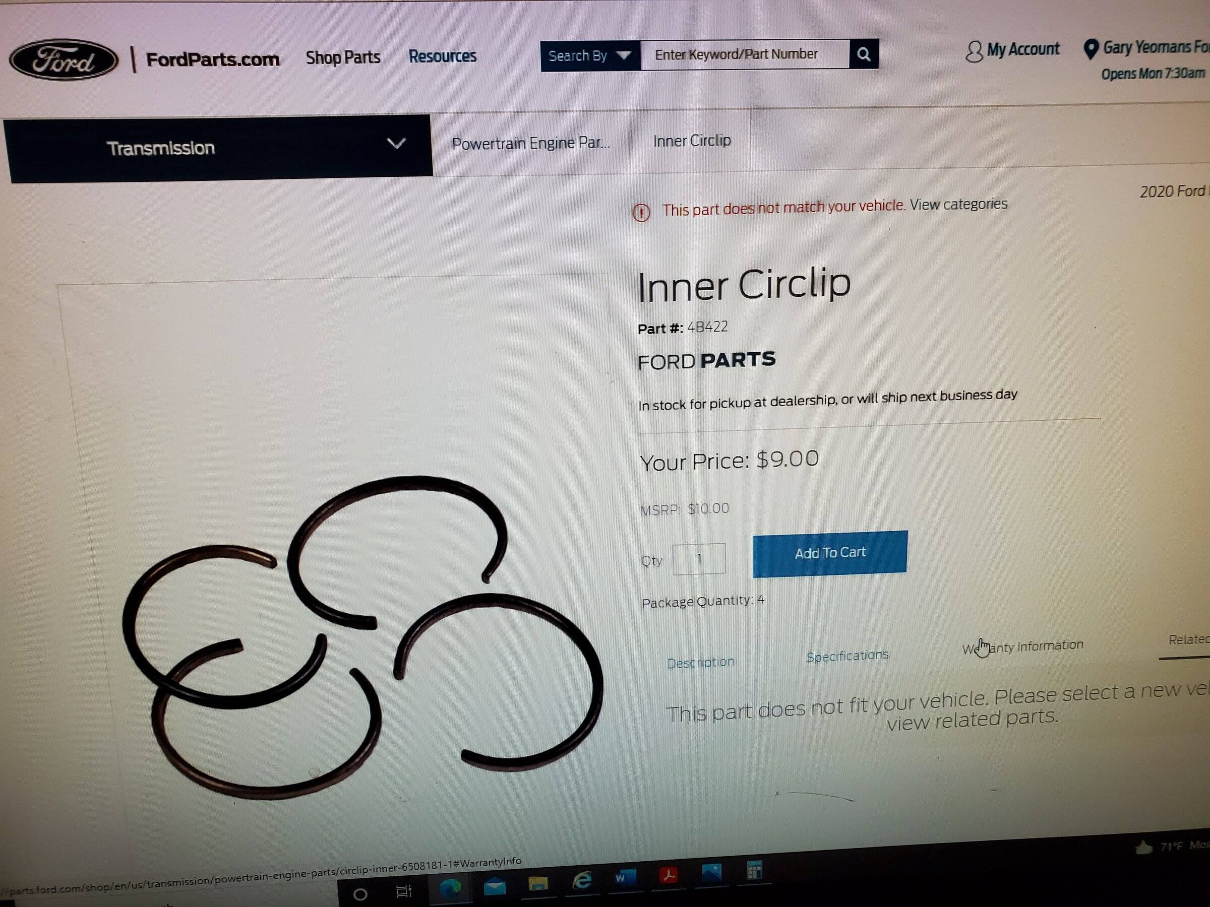

I went to parts.ford.com and using my VIN, it says the part does not fit my vehicle.

4b422 designates the inner circlip for the 500 shaft which locks it into the differential.
