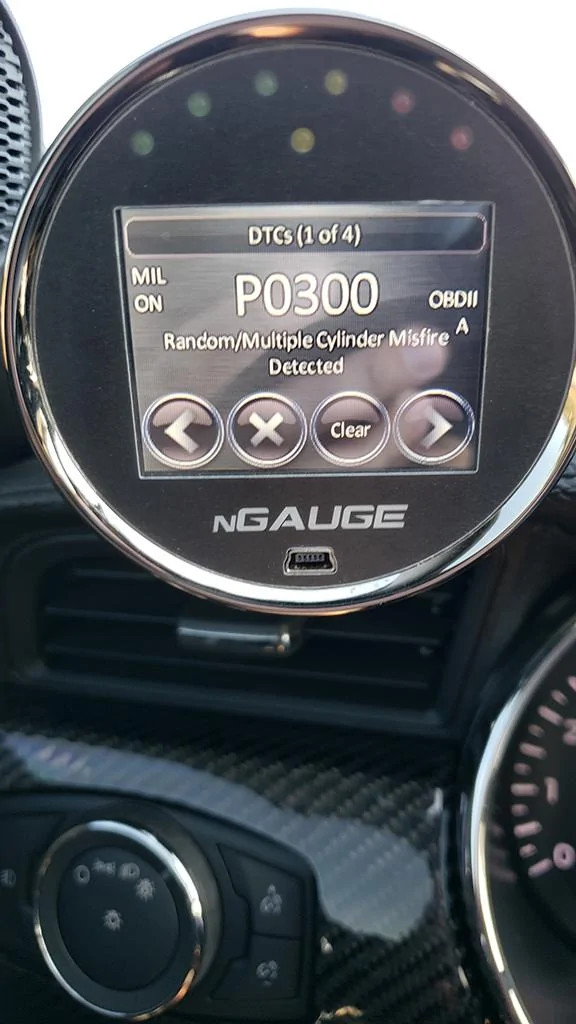

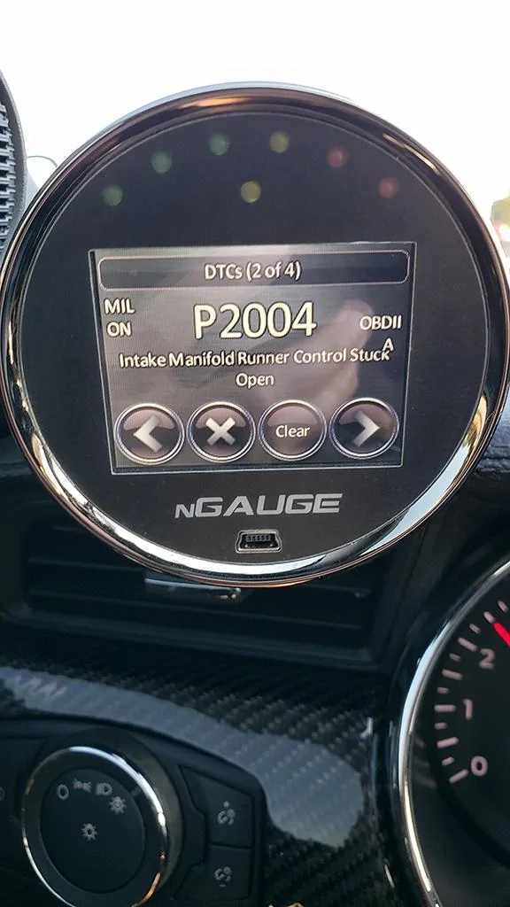

I have a similar issue with my motor throwing codes for IMRC stuck open which is resulting in misfires.
Similar to OP I have a ported GT-350 IM, TB, CAI, LU47's and tunes by Rob Shoemaker @ PBD. I just clear the codes on the Ngauge as closed IMRC is mostly for low RPM driving.
I have not sensed a loss in power and I have found that the RC shaft is plastic and prone to breaking easily but not too sure how to replace that shaft(s).
Anyone have experience with either this issue and/or replacing the shafts? TIA.
