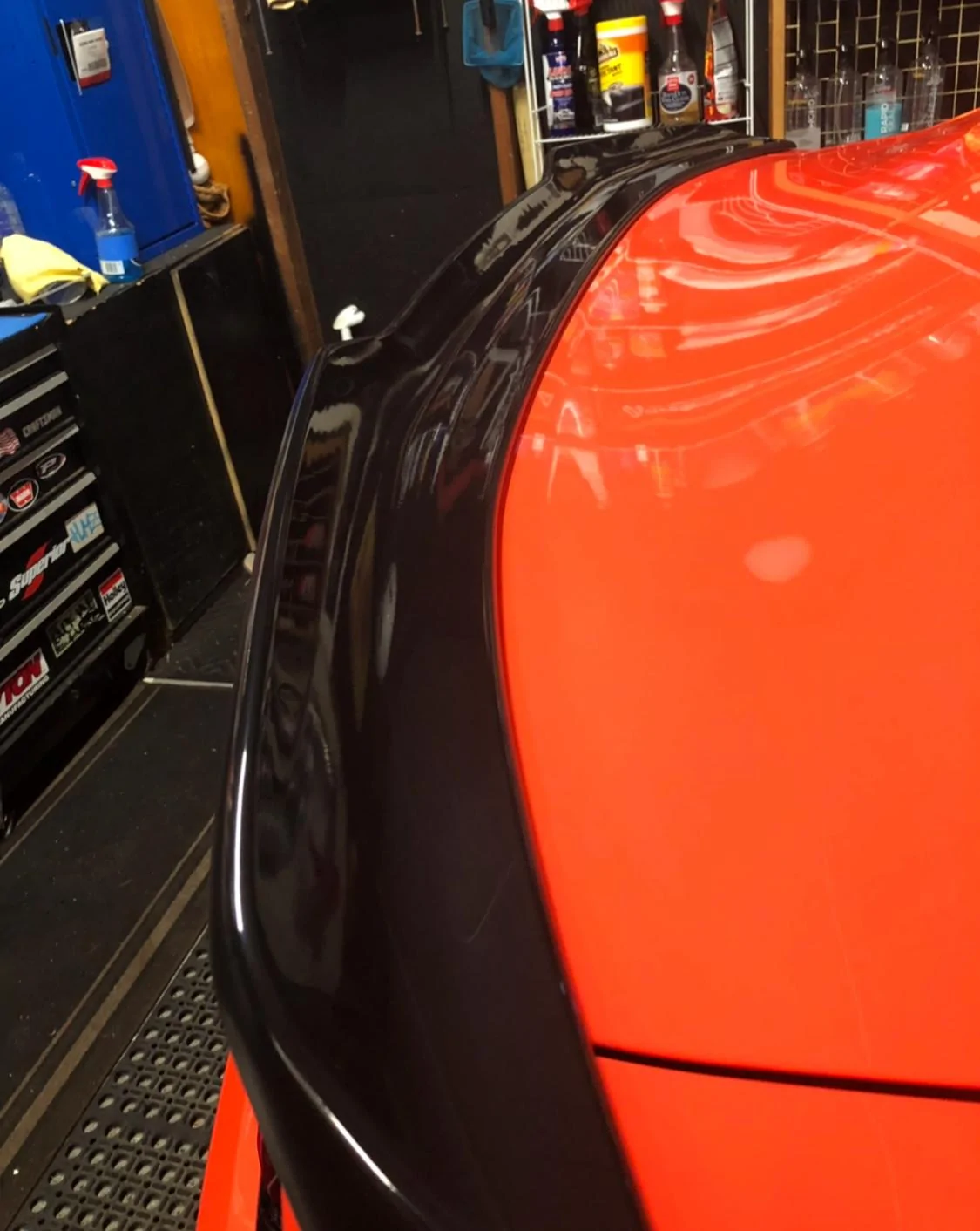

So I was on the fence about keeping matte, wrapping gloss or even painting one of the two. SO, before I pulled the trigger on either I ended up doing the best of both worlds and I’m stoked! Top Gloss, bottom/back matte.
Taped off, wet sanded 1500> 2500 > then 3 step compound and polish then wax. I can say it came out fantastic for an “unpainted piece” that was half the cost of a painted piece. Well worth the “lets See how this ends up” lol

From how the description started out I was worried, but it looks like it came out damn nice! That shine was just from using the polisher?

Hahah thanks, well a few steps. Wet sanded 1500 then 2500. The cut, less cut , polish, Selant/ was about 90%
Of it all ;p

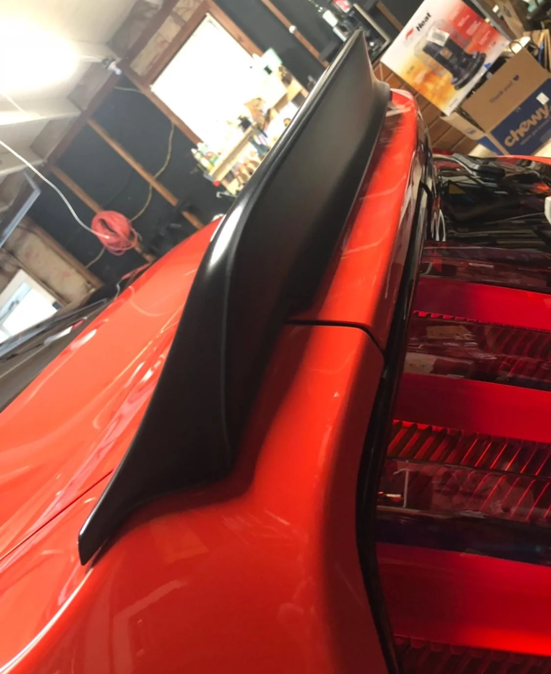

What model of Icon wing is that? Would this line up with existing wing holes??

It’s the “15-18 Ford Mustang Coupe H Style High Kick V Unpainted Trunk Spoiler - ABS”
I’m not sure if it’ll cover existing holes. I have the spoiler delete so luckily had no holes to cover. I’m guessing it wouldn’t because it doesn’t come more than an inch up on the deck lid.
