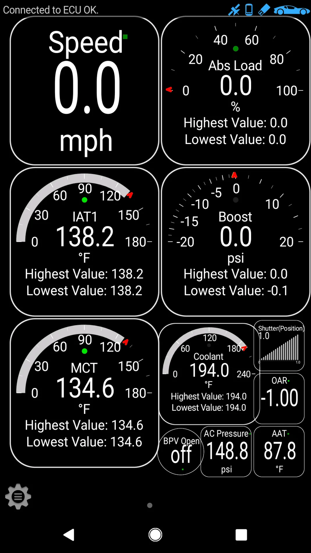

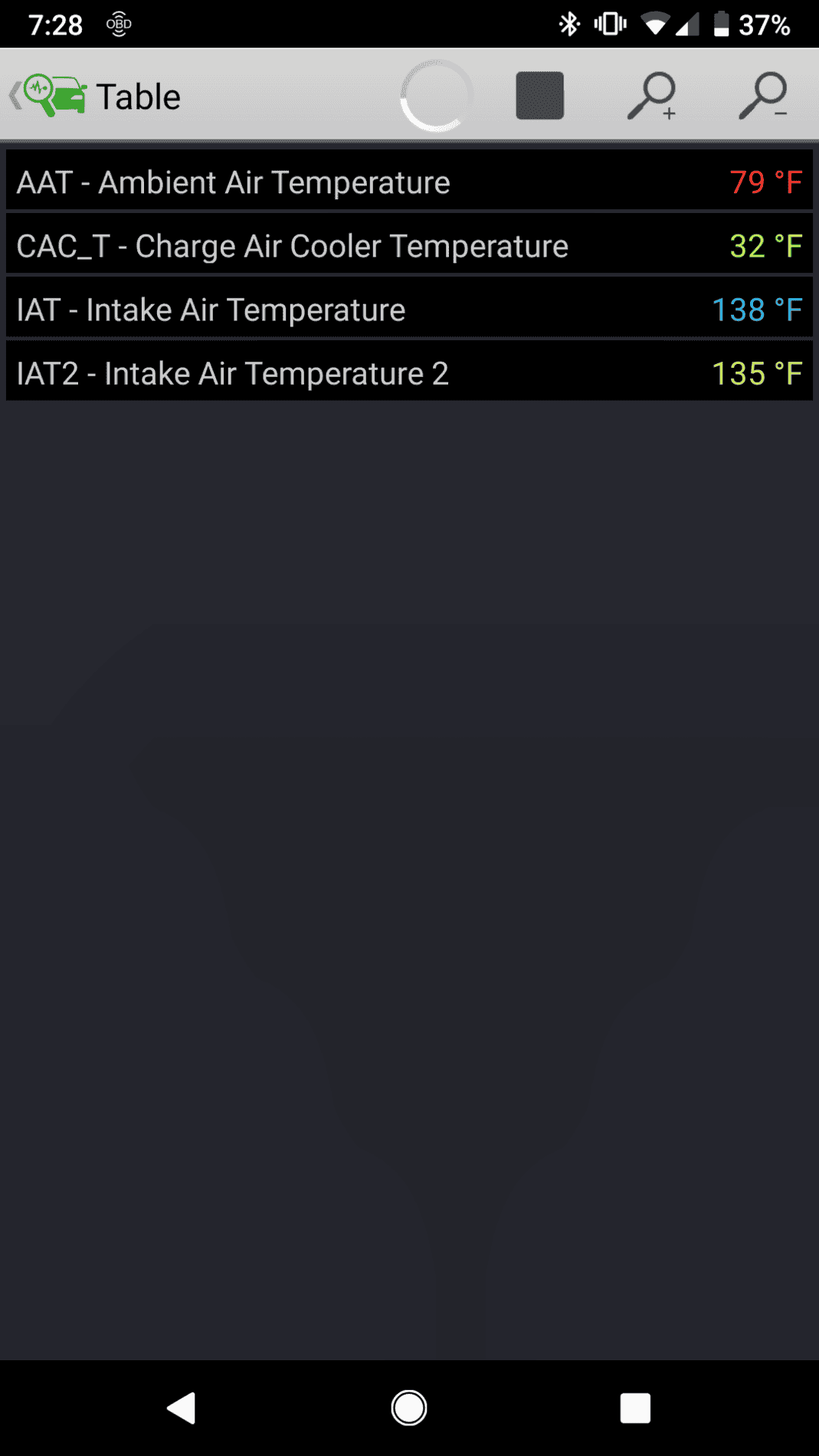

One thing I never quite figured out - where is the sensor for the post-intercooler temps? The reason I ask is because I use a different PID that I found labeled as IAT2, and from what I've read elsewhere online and in ForScan, it suggests this is somewhere near or in the intake manifold. However, I've seen there is a sensor near the outlet side of the intercooler, so maybe that's it? I've seen PIDs for the charge temp, but could never get them to work. For reference, the PID header for IAT2 is 2203ca and the formula is (A-40)*1.8+32.
Below is a screenshot from torque pro showing both temps. I've labeled IAT2 as "MCT" in the app.
Below is a screenshot from ForScan showing IAT1 and IAT2. As you can see, the "charge air cooler temperature" is a dummy value which seems to be a function of the celcius/fahrenheit conversion, suggesting a value of 0. When I change the units to celcius, sure enough the value is 0.
