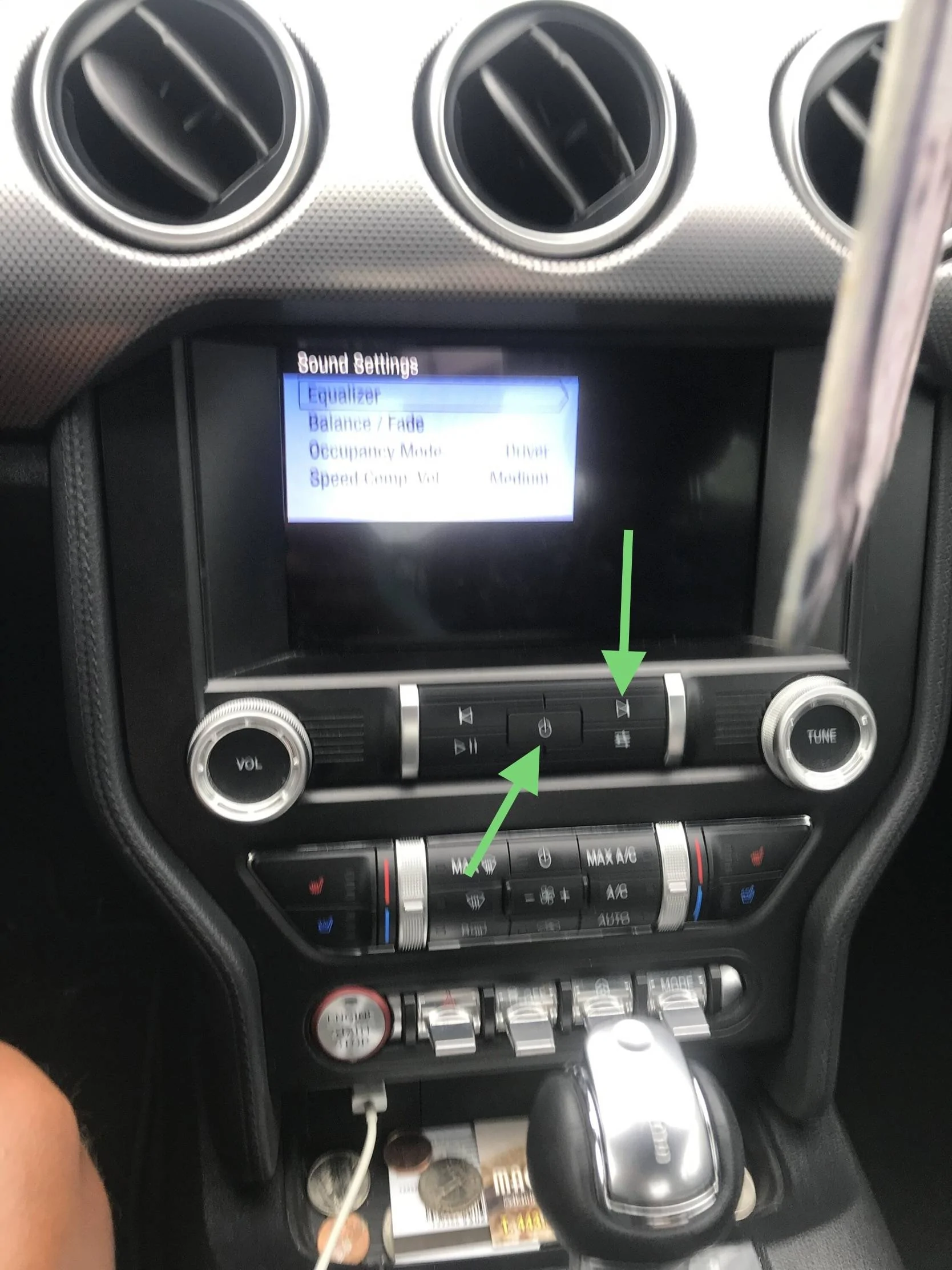

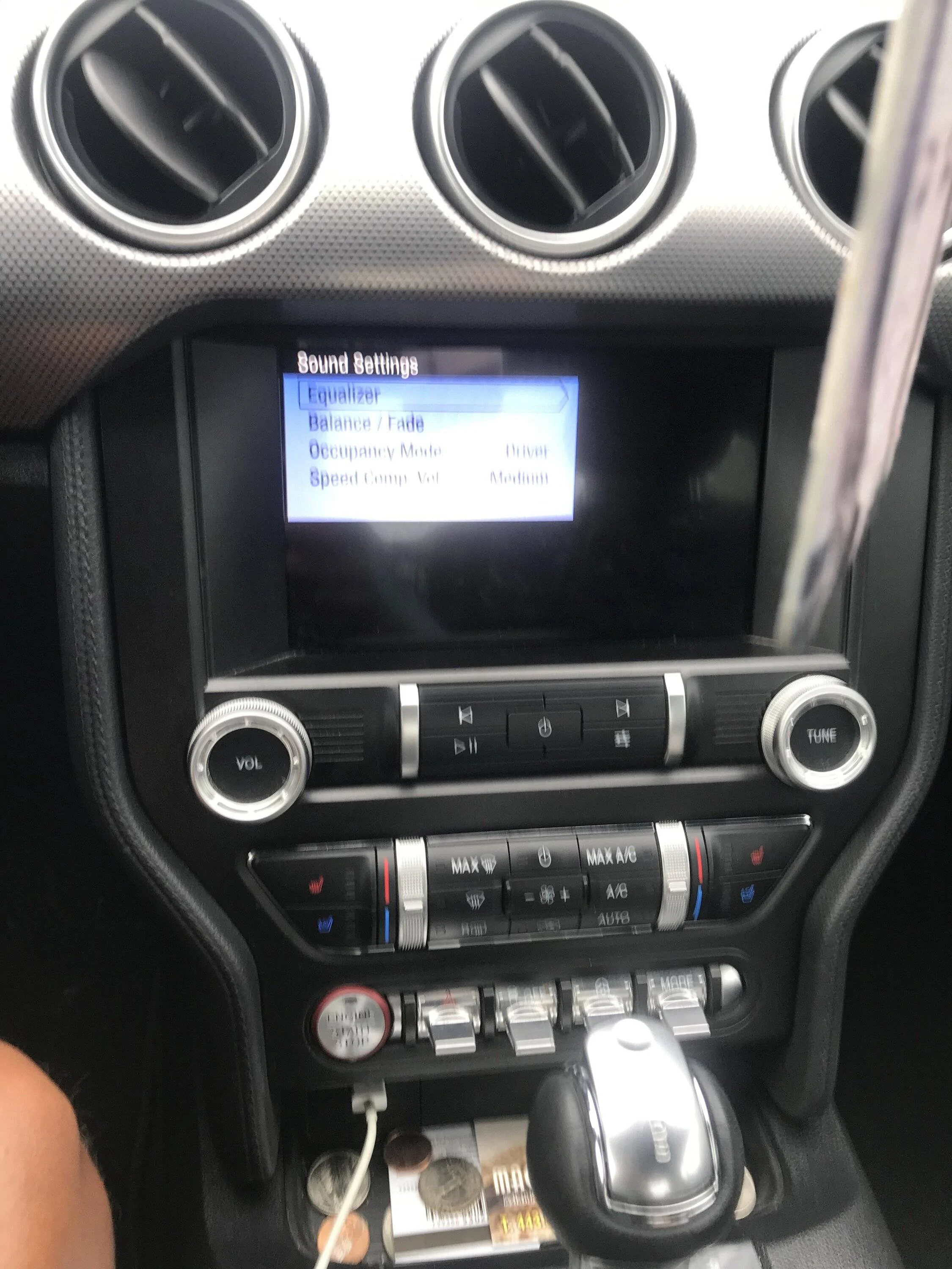

I upgraded my base radio to the 8in screen no problems for 2 years yesterday i updated the car and now this is the screen I see any help on switching it back to the full screen radio works back up camera and everything

Not sure if you’re saying the screen is stuck. If so, hold down these two buttons for 5-10 seconds and it will reboot the radio.
What did you update?
