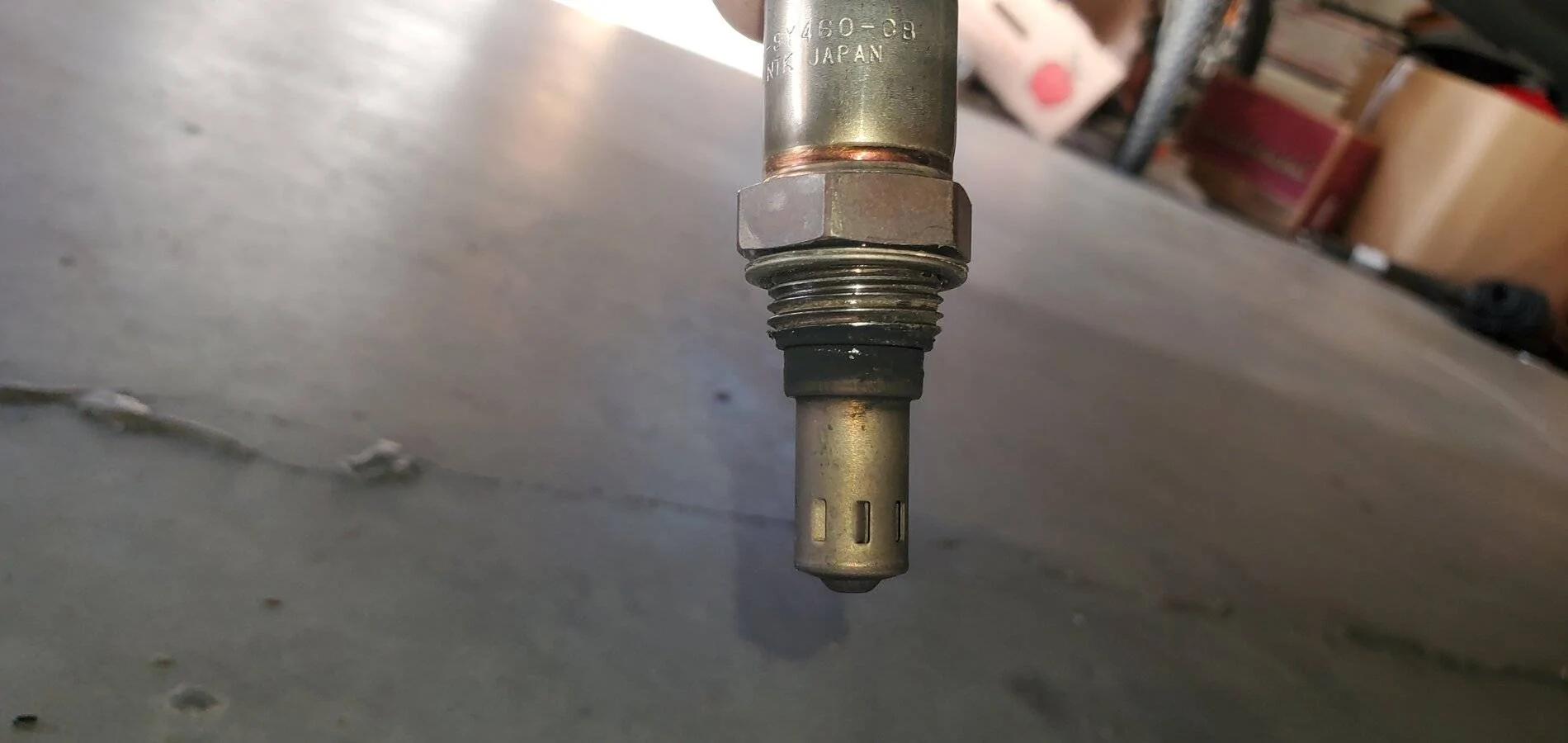

This is the 3rd or 4th 02 sensor I've had to buy in 3 or 4 months. This time it says P2243. 02 sensor reference voltage circuit/ open bank 1 sensor 1. The last time it said p2251 negative current control/open bank 1 sensor 1. I just replaced the extension harness. I have longtubes on my car without cats. Recently just started having this problem. What can it be? Should I replace thr harness again?? I don't know what else to do. I replaced the extension harness and the 02 sensor... what else could it be? Thanks

Oct 31 2020-02 sensor negative current control circuit OPEN BANK 2 SENSOR 1
Replaced both 02 SENSORS ( just because you replace one side.. you replace the other)
Dec 5 2020- 02 sensor negative current control circuit OPEN BANK 1 Sensor 1
Replaced bank 1 sensor 1
Feb 11 2021- 02 sensor negative current control circuit -OPEN BANK 1 SENSOR 1
Replaced 02 sensor BANK 1 sensor 1
Replaced 02 extension harness
April 5 2021- 02 sensor negative current control circuit OPEN BANK 1 SENSOR 1
WtF??
