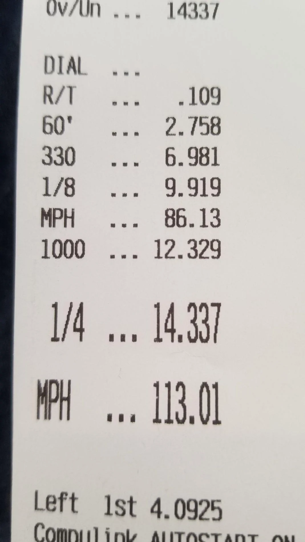

Second outing in the gt.
2018, a10, pp1. Stock.
My 1/8th mile experience wasn't bad. Small learning curve. I've got 100s of passes under my belt, but all in a high torque vehicle on slicks. So much different than my gt.
However after two passes today I parked it.
First pass was awful due to weather. It had rained, they let us run, but the track wasnt dry. I left @ 1800ish, spun and lifted. 2.78 60'. It felt like ice. I was watching big tire cars get real sideways after me.
Car ran a 14.337 @ 113.1
Any and all data was useless.

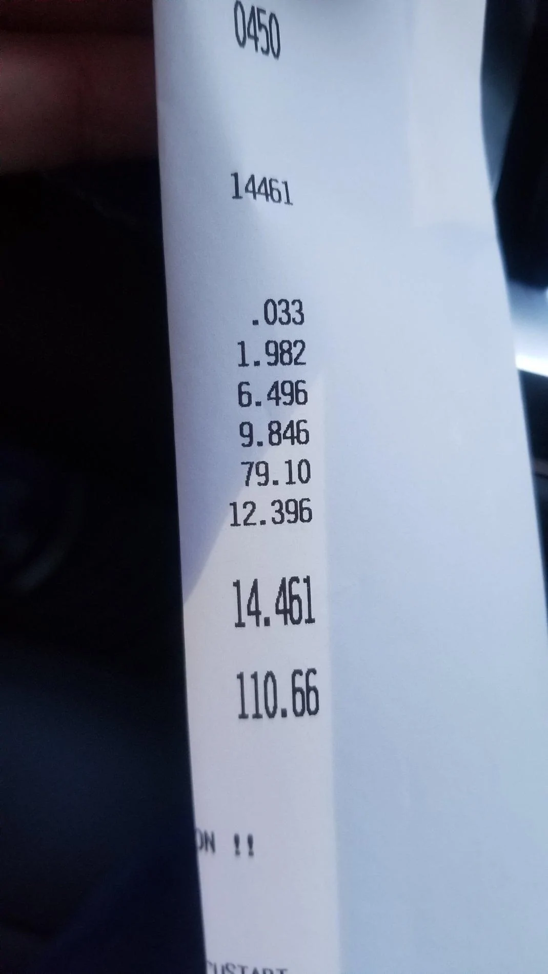

Second pass, car in drive, advance trac off, drag mode on.
Left @ 1300, car hooked ok. 1.9 60'
Car shifted into Second, I got the expected wheel hop, and it basically shut down. I had to hit the pedal 3 or 4 times before anything happened.
14.4 @ 110
I dont know why it shut down like that, but I think I'll stick to my lightning for straight line stuff.

For B, you have to look at the 60' separate from the run. The car shut down on the 1-2 shift after the sixty foot. So anything beyond that is useless.

You are not the first person I have read that experienced this with a 2018+ 10 speed. From what I've read its boils down to the shifting being so aggressive and it causes bad wheel hop that triggers the advancetrac. Just to confirm, are you certain that you turned off the advancetrac before the run? Does Drag Mode disable it? I know for my 2017 GT, I would press and hold the traction control for a few seconds to disable both Traction control and Advancetrac. Just toggling it once would only disable Traction control.

I had the shut down at the 1-2 shift when I was running P-zeros and had the wheel hop. I am not sure if it hit the rev limiter, went into limp mode or exactly what happened but wheel hop is the enemy. I had the CB005 kit and still had violent wheel hop. With the stock tires, I could not use drag mode. I had to just run in sport mode so the shifts were less violent. Once I got DRs, my problems were solved, I could use drag mode and my wheel hop was gone with high 11 times.
Since you do not want to mess with DRs, at least do something to eliminate the wheel hop....Steeda stop the hop and/or stickier tires.

You're not tuned, but you can bet your bottom dollar there is STILL some torque management on a stock car even in DRAG mode. That's where your problem is.

I'm positive I turned it off. You hold the tc switch till the dash says advance trac off. No drag mode doesnt disable it.
