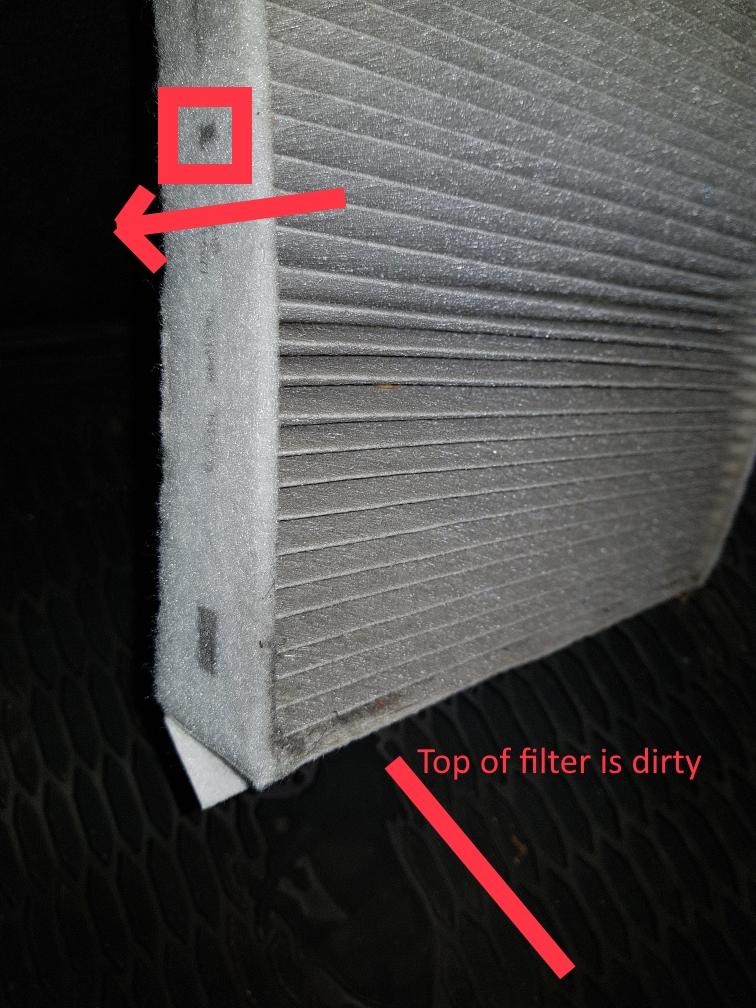

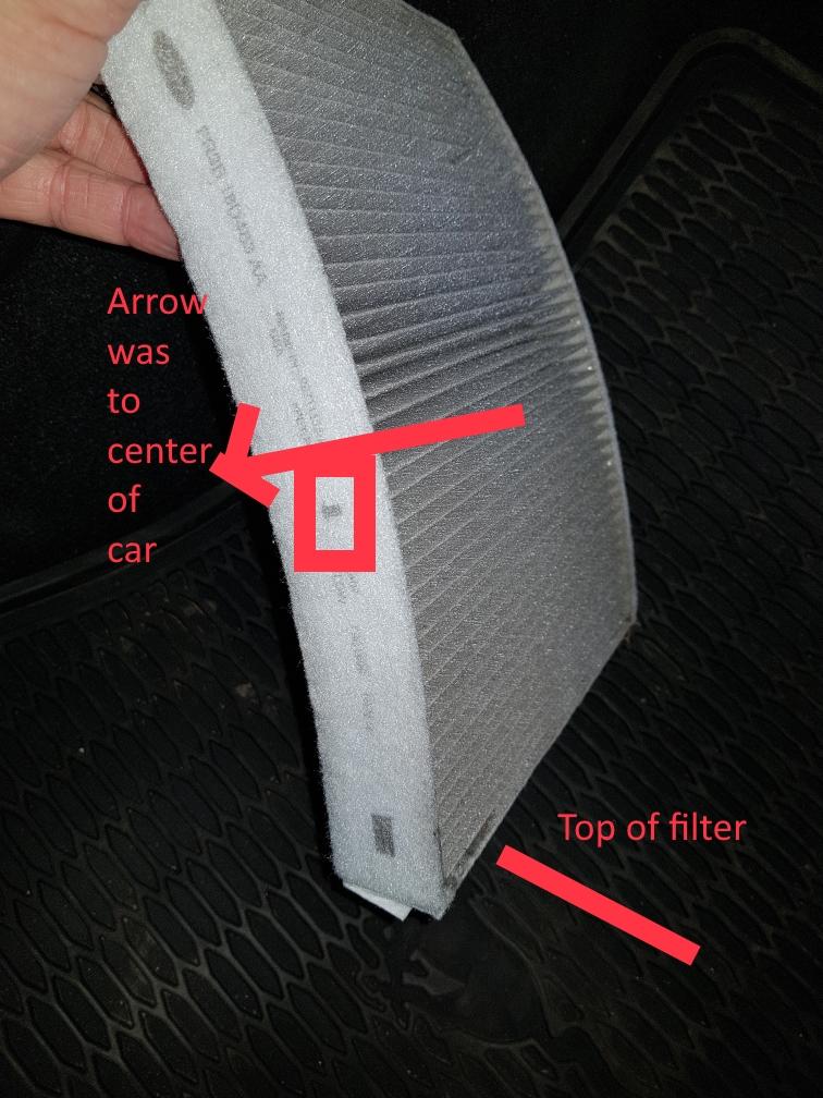

I just did this (mostly out of curiosity from the posts discussing airflow. I pulled the filter straight out and looked at the marking and debris. The arrow pointed to the center of the car (down) and all of the dirt and bugs were on the top of the filter. No matter what direction the arrow was pointing, the debris tells me the air flows to the middle of the car and the airflow should point down (to the center of the car). Just like the CJ pony parts video.
