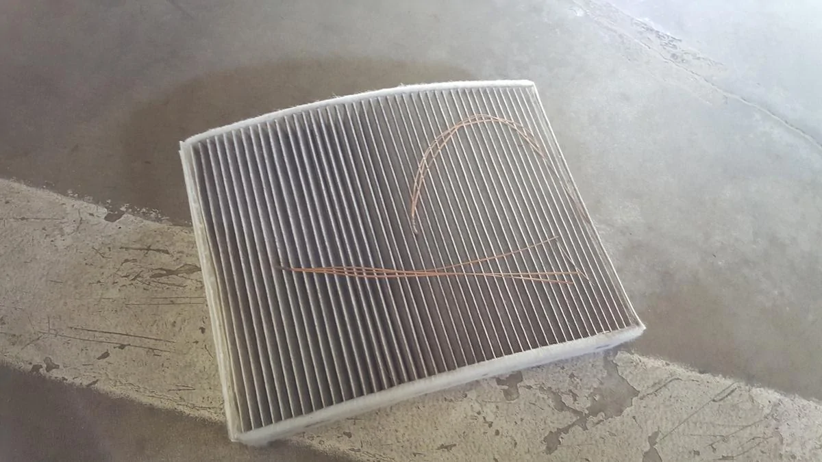

I did mine last weekend. Car has 18,000 miles on it. The filter came out dirty as hell and had frickin' pine needles in it.
Glad I changed it out. I sprang for one that that has activated carbon in it to cut down on stank. This one: https://www.amazon.com/gp/product/B01IW17KQA/ref=oh_aui_detailpage_o00_s00?ie=UTF8&psc=1
I suppose it's working seeing as how I haven't noticed any stank yet this week. So far so good.
