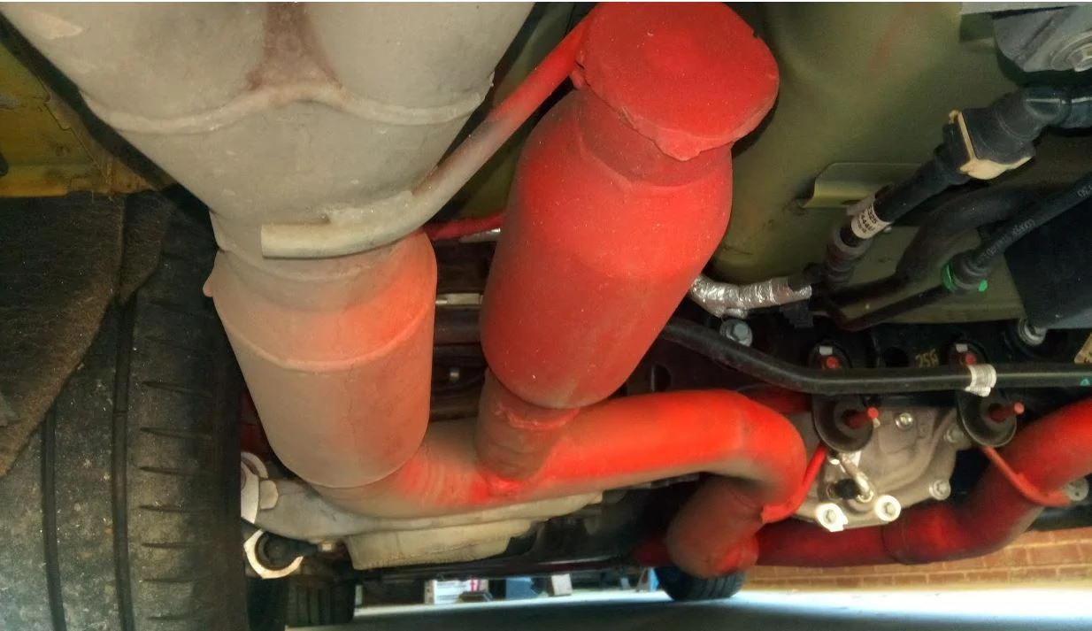

Barring that,, I installed the 3" Outlaw's on my 2018, Yes ... I knew they would drone, and did it ever .. Absolutely ear bleed drone on the highway.
I installed a pair of old Vibrant 2.5" bottle resonators I had laying around as a Helmholtz resonator like MBRP did on their race exhaust and actually killed the drone.
I have LT's and will be installing a mid-point muffler in the near future as these Outlaws are crazy loud ...
