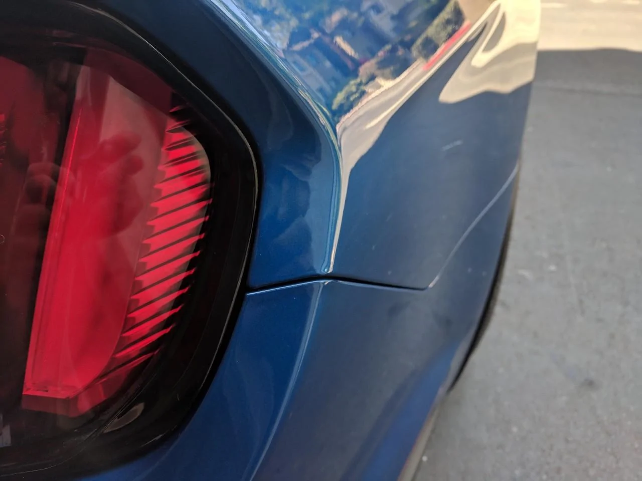

I am just glad the gap is gone. It made the car look really awful specially a 60k + car.

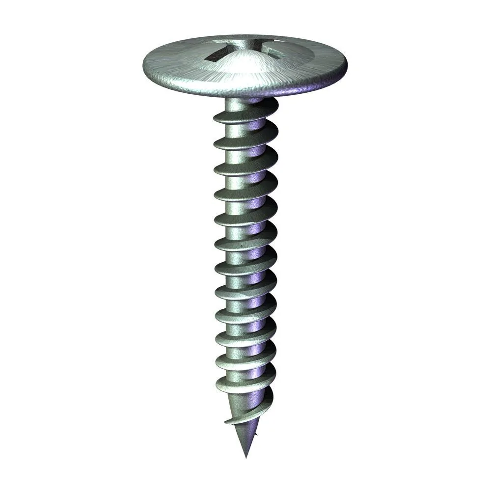

Truss head screw

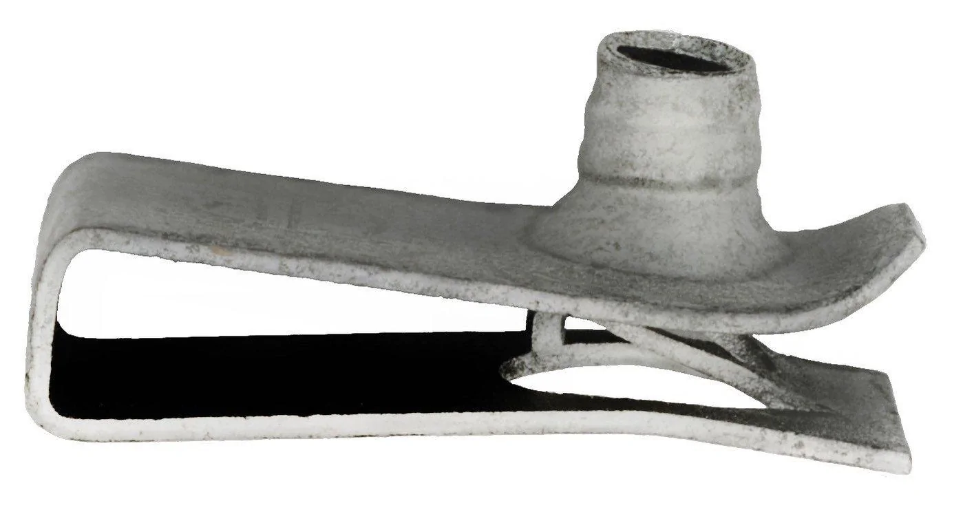

Nylon insert. Shorten the insert so it will only go deep as the cars bumper and not into the bracket. By doing this it will have more reinforcement and the screw will not contact the hole that you drilled.
Rubber bondded washer to keep the paint from getting scratched and better contact with the bumper.
Buy a longer u nut but not too long. Drill a hole towards the middle corner of the bumper so the hole and u nut line up.

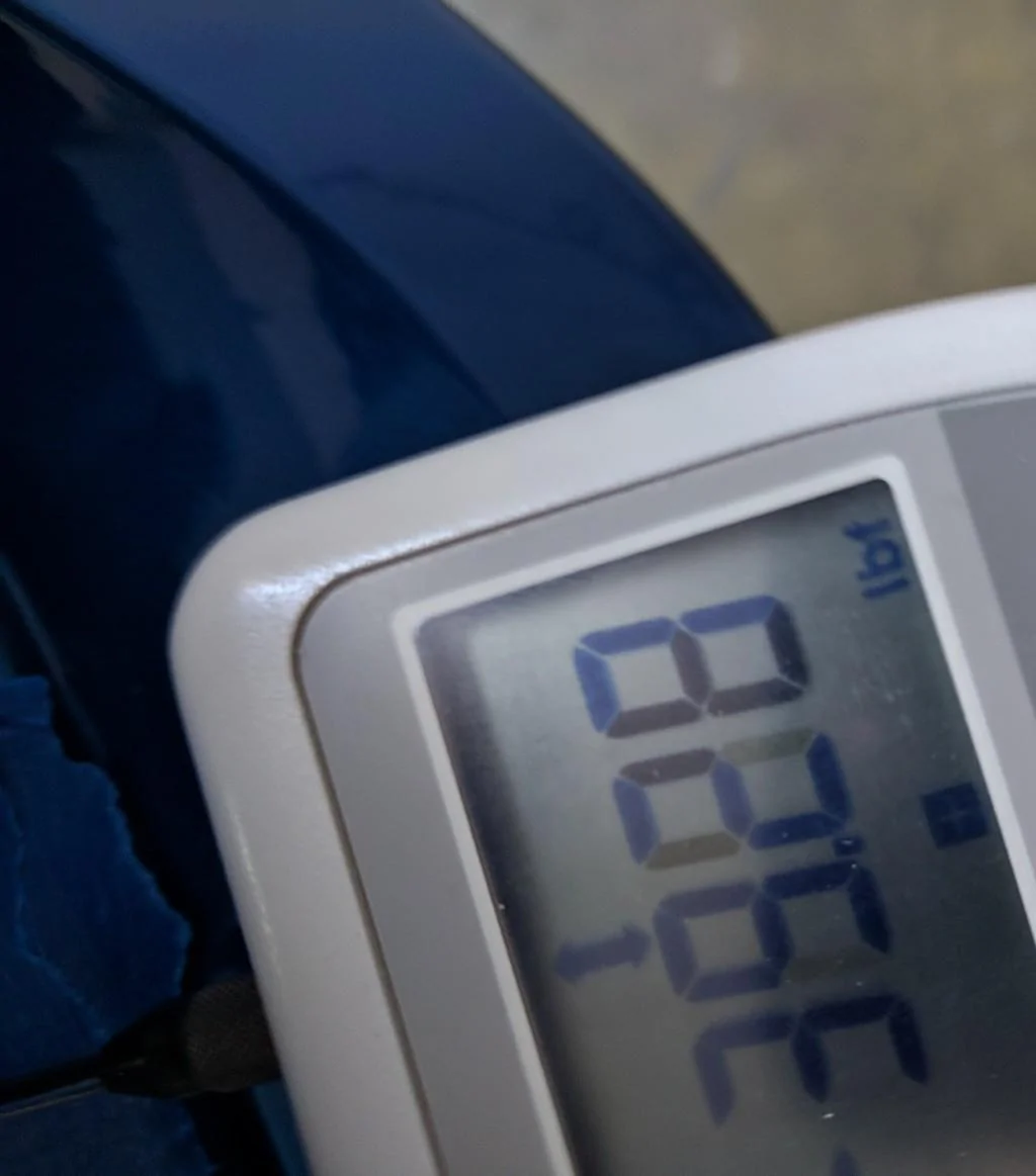

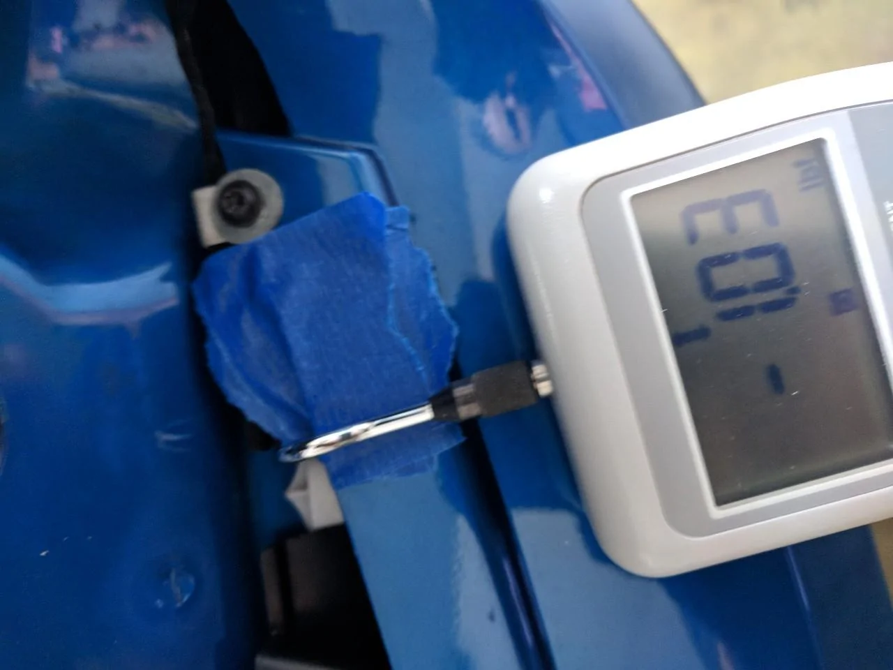

Force gauge attached to the bumper.sorry for the bad quality pictures but holding the force gauge and pulling on it and taking picture is little difficult. I pulled on it as hard as I could and as you can see almost 40 lbs of force and the bumper didn't even budge.

Pulled as hard as you could? Does this mean we have a quantifiable measure of Niz55's max strength at 40 pounds? :D
Kidding. Nice work, and will keep in mind for future. I think my bumper senses when people on the forums talk about the gap, and then it opens up more just to spite me. Some kind of strange cosmic car connection.
