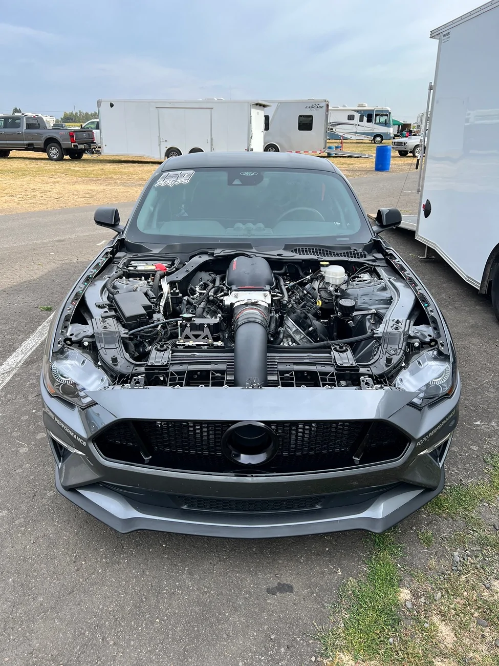

Well, after approximately 150 1/4 mile passes, the 10R80 has decided it’s done. Almost all the passes were with the 3:55 rear gear and car weighing about 3300 lbs. The last 30 passes were with a Circle D converter. This car has spent its entire life shifting at 7500+ RPM. Car made 500 HP last time on the dyno. The car will shift at low rpm but any high rpm attempts, it says NOPE😂. Car was built at the beginning of 2022 so it doesn’t have the updated CDF drum or the hard anodized shell. I believe cars built after Aug 15/16 22’ received the updated parts. It’ll get rebuilt and we’ll be ready for the 2027 season. Car has 900 miles on it…..it’s not street driven.

Car looks great! That aardvark style intake looks like it can really draw some air. Do you expect to run quicker/faster after the tranny rebuild?

Thanks! I’m going to a 3.73 rear gear at the same time as the rebuild, I expect to improve the ET. The actually “shifting” should happen quicker and be more consistent for sure. Unfortunately, I won’t know until March/April when the new season starts up.
