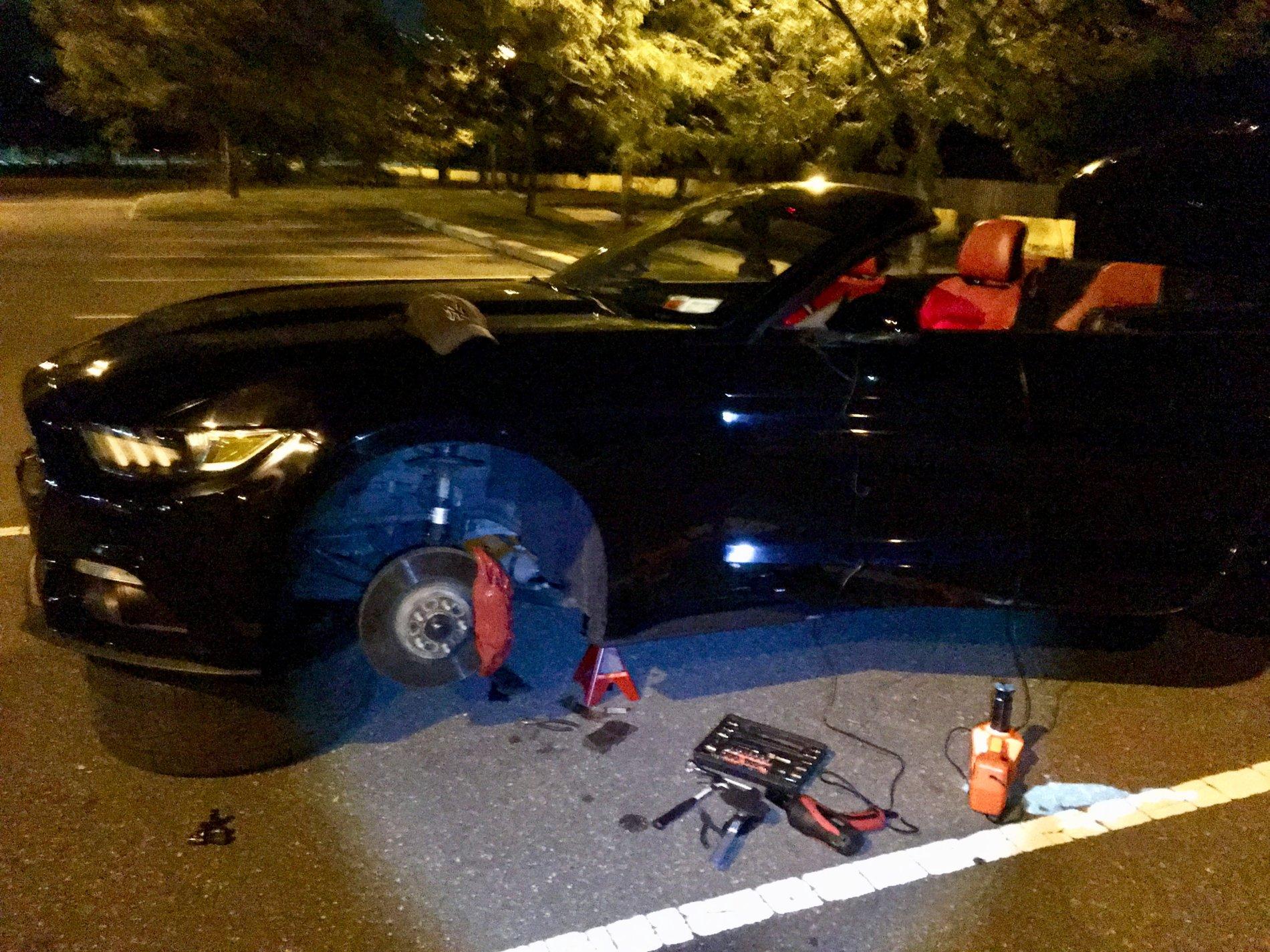

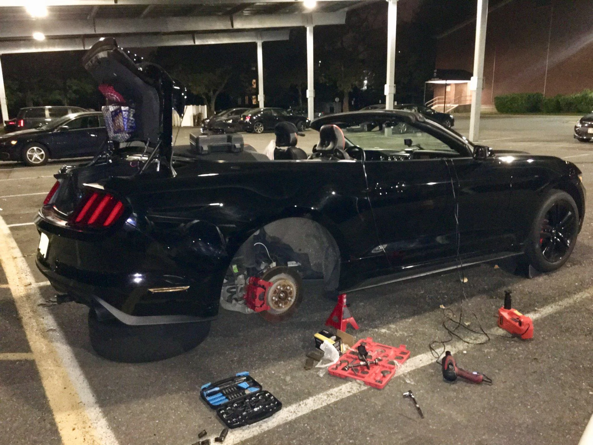

Front pads started squeaking at 30k with maybe 10% left and the rear pads still had a good 30% I’d say. Just changed them to akebono pads recommended by Scotty Kilmer

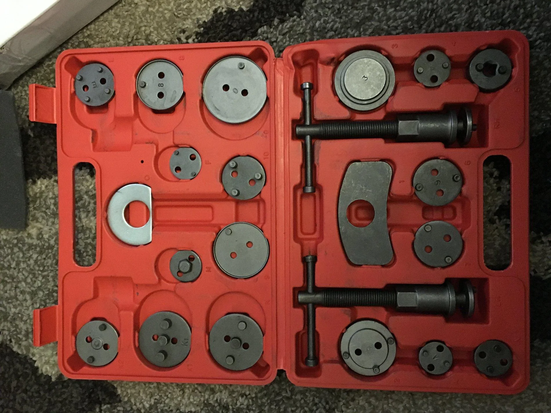

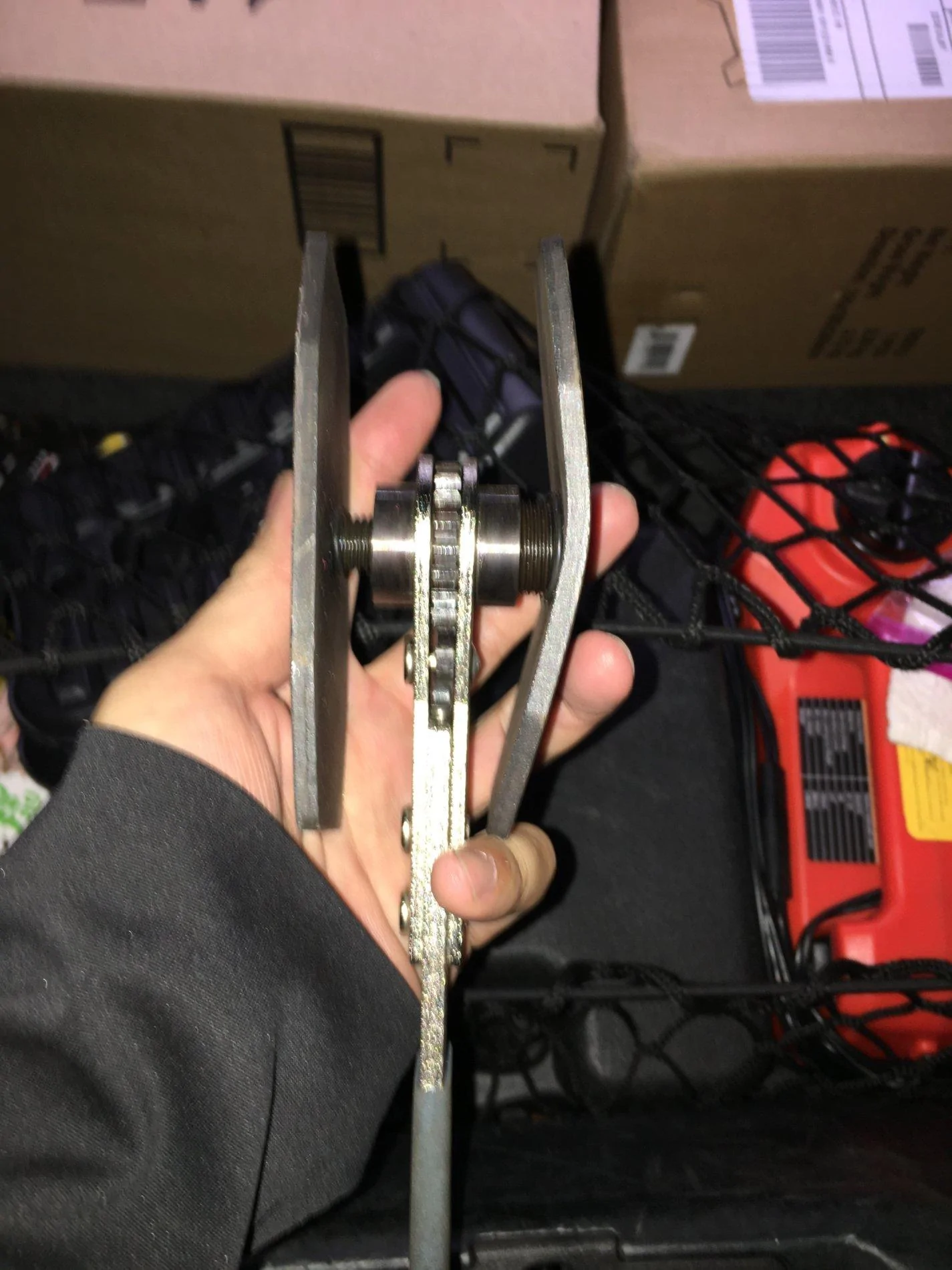

I made the mistake of using a spreader on the rear brakes which need to turn and bent the shit out of it
