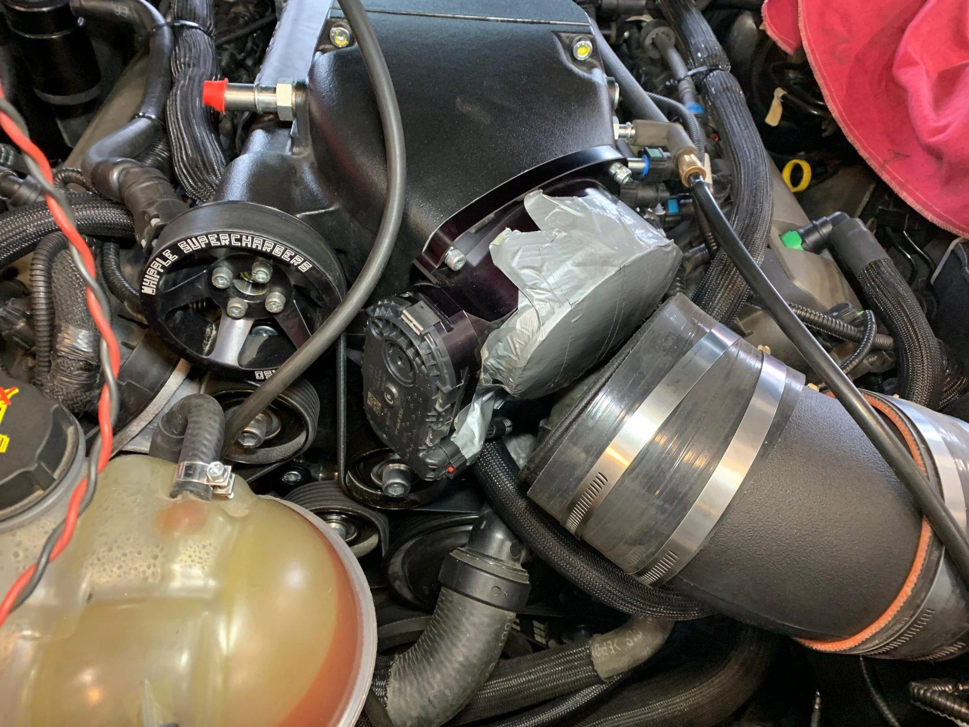

I did pull off the TB last night and everything is all connected... and moves... the spring has a good amount of tension on it to... holding it closed.
If the O-ring is inserted incorrectly, this could be your leak.

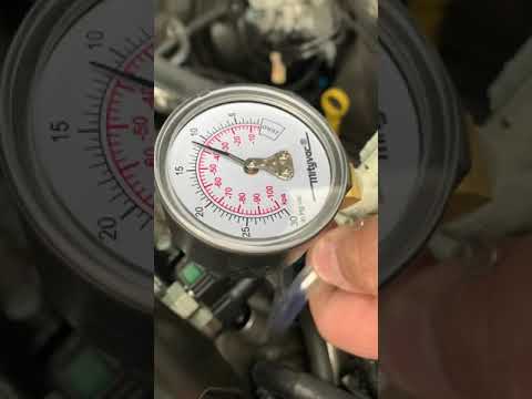

1. Okay ran the test it held for 10 seconds and I could hear it snap close when released... it passed...
2. I also tested the other way... vacuum on idle it was 20 PSI and when you hit the gas switched back... Does this look right... I think it does... please let me know your thoughts.
