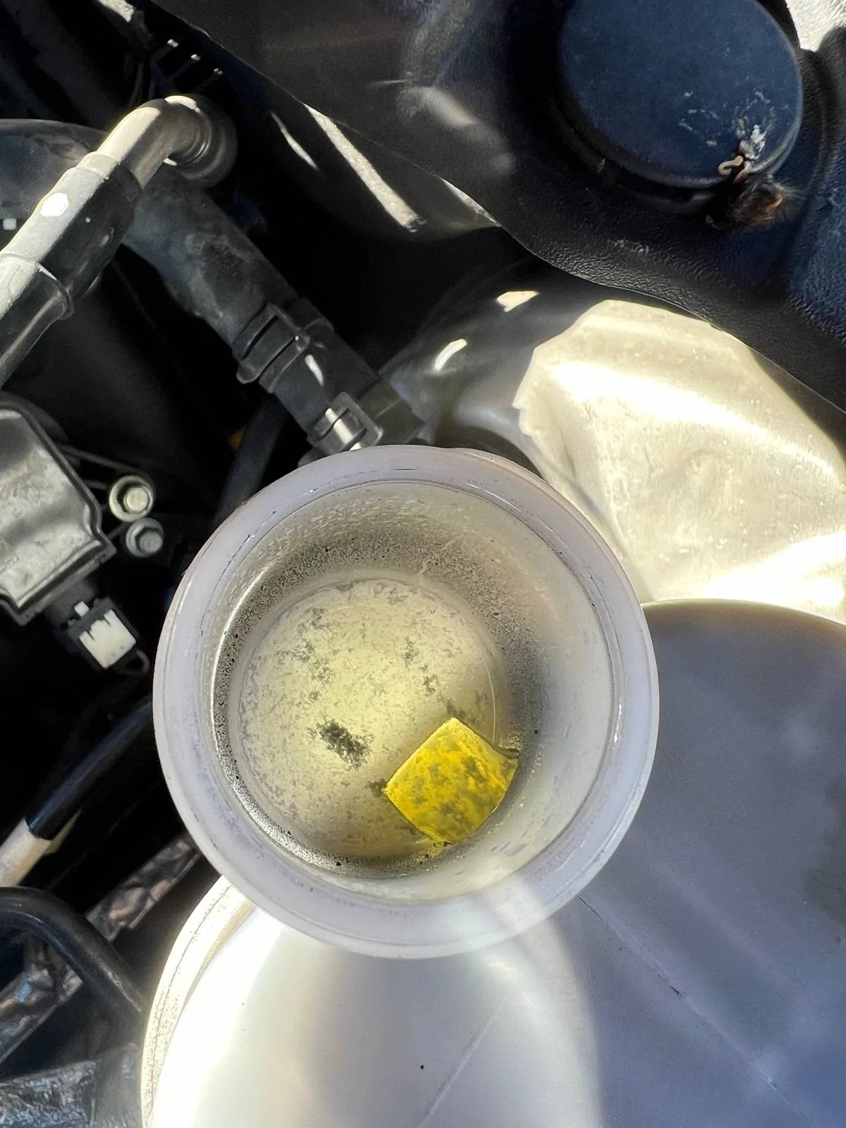

Can you take a pic of your brake fluid reservoir and post it here? I’m curious as to whether or not your fluid could stand a flush (dark and dirty are indicative of maintenance required).

Yeah I’ll go and take a photo.
Because I had my clutch and slave cylinder replaced, would they flush the whole system or just add more fluid when bleeding it?
It’s hard to say. Anything is possible though. Unfortunately, It seems like we’ve reached a point in time where it’s not a question of if a dealer tech is capable of doing the work properly, but rather, does he take enough pride in what he does and care enough to do it properly? With that being said, it makes sense to double check what you can yourself.
