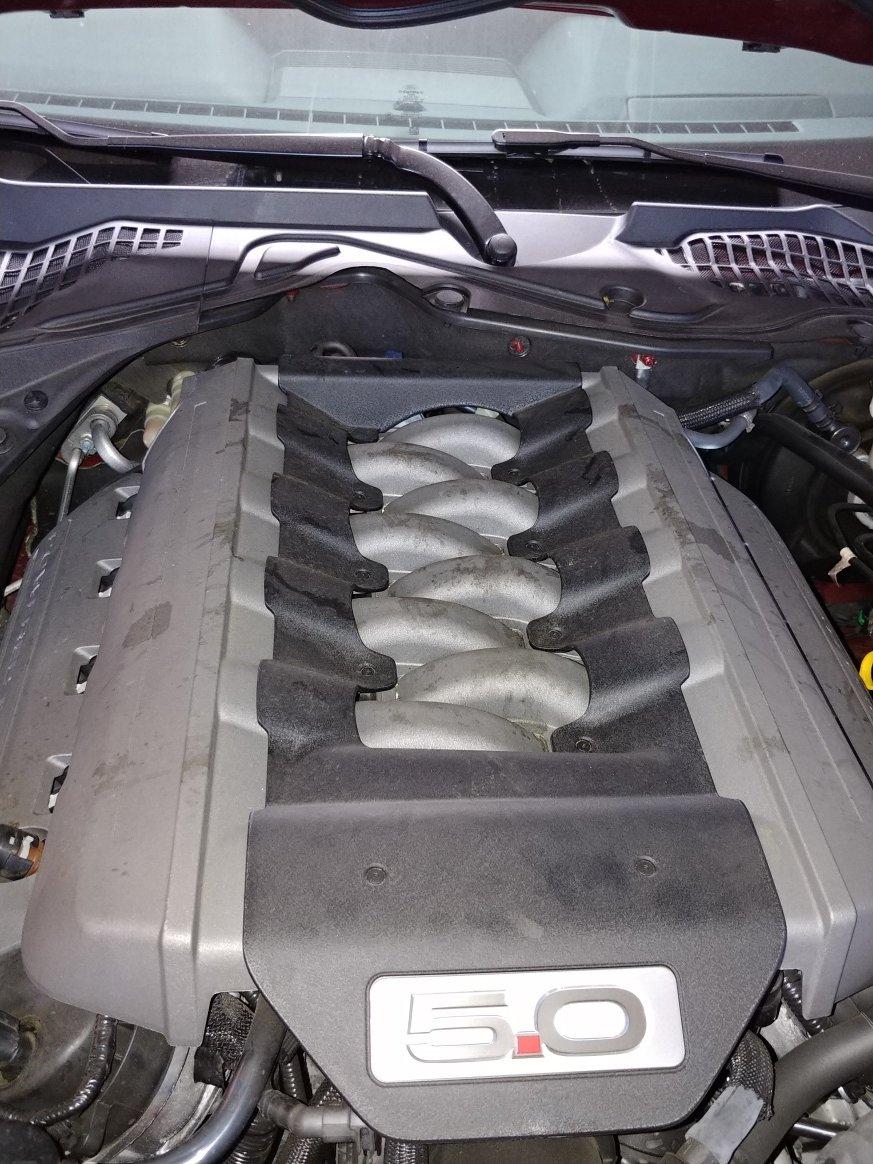

So everything in my engine bay is totally stock except the oil catch can. Do I need to cover snything before hosing it down? I'm pretty sure the stock with box is closed?
PS if you haven't guess already I'm a noob
