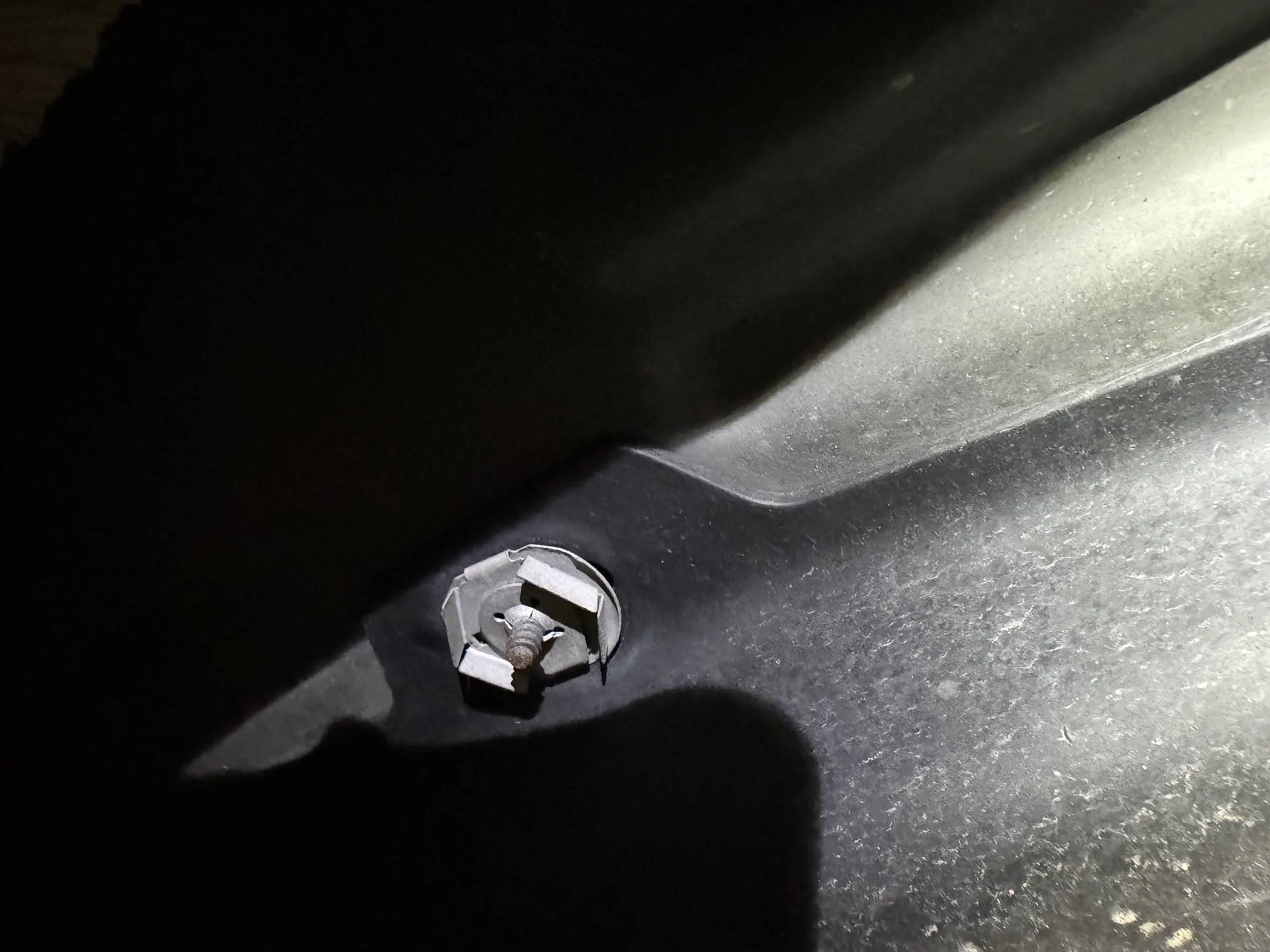

How do I remove this?
Prevail
Sep 17, 2017
Topeka, Kansas
2019 Mustang GT PP2
Never seen one of these before. Trying to access fuel lines, videos online just show torx and nuts not these.

It is a nut. Just turn counter-clockwise to remove.

I put a socket on mine and turn by hand. No need for a ratchet. Same thing when reinstalling. If memory serves me correctly, I want to say it’s a 1” socket.

Don't overtighten it when re-installing either. It's basically a piece of sheet metal formed into a nut.
