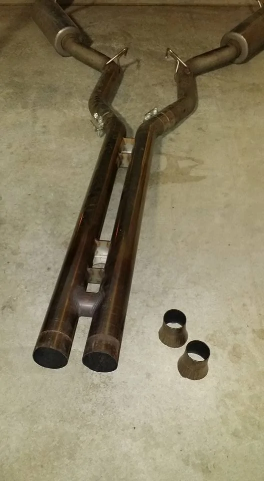

Like everyone says....easy. I take mine off frequently as I'm always trying different things. Now, when I take them off I leave them in one piece and only remove the rear most hangers, this leaves me the hangers at the IRS cradle to hang them in. Here's a pic. I've since modified mine, that's why the ends are cut off. You do NOT want to do this. This was my mod after I went to long tubes and keep everything 3" and it still wasn't necessary, just what I wanted.
I also upgraded my clamps, since I remove them frequently.
