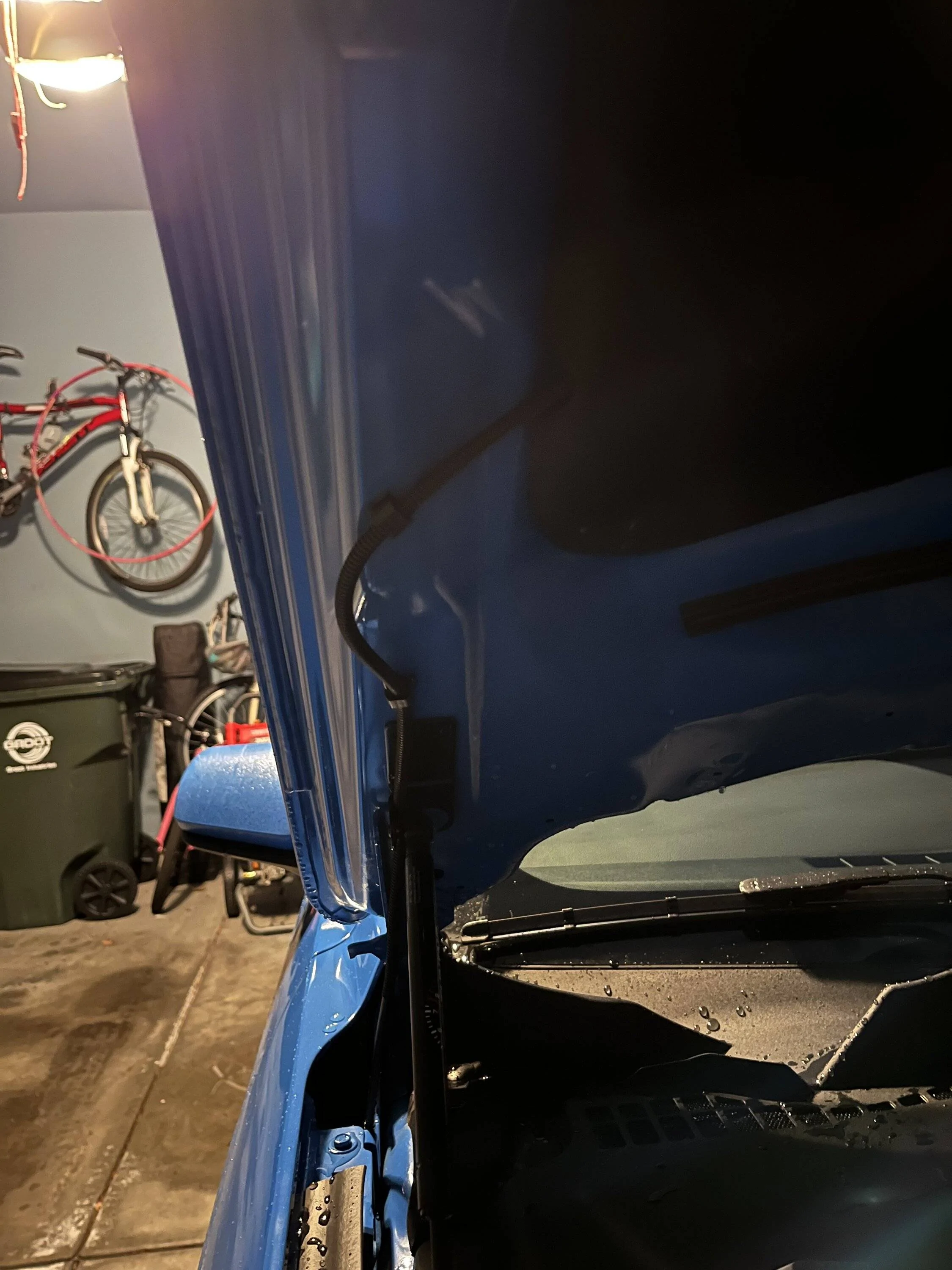

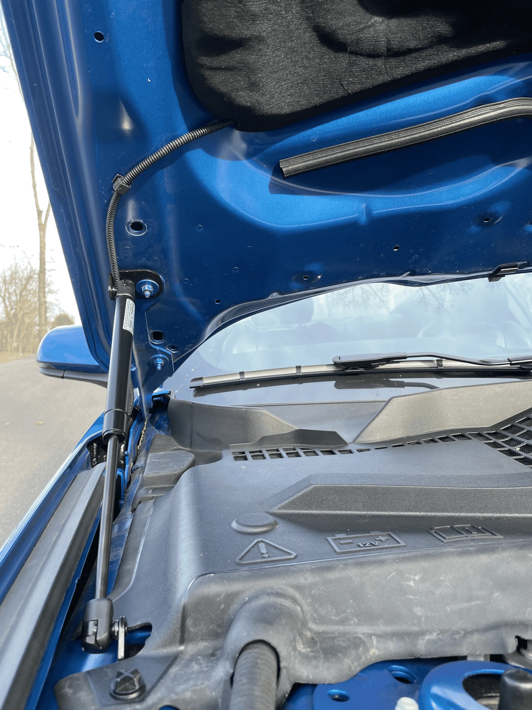

How are we routing that washer fluid line on the passenger side? There really is not enough slack to just push outward as Redline suggest. I know that line can get pinched on 2018+ S550s.
Any thoughts?

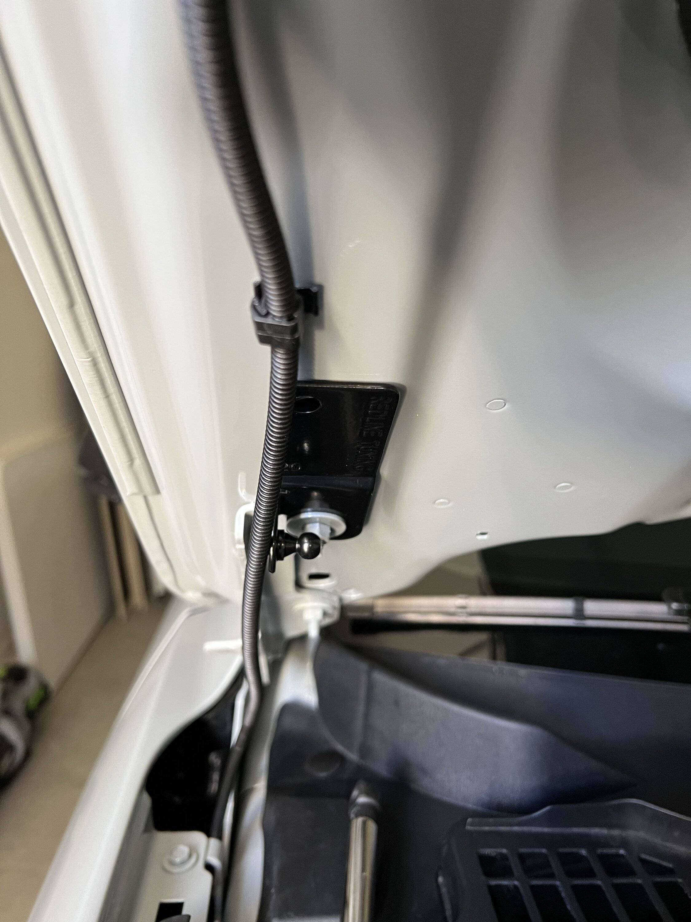

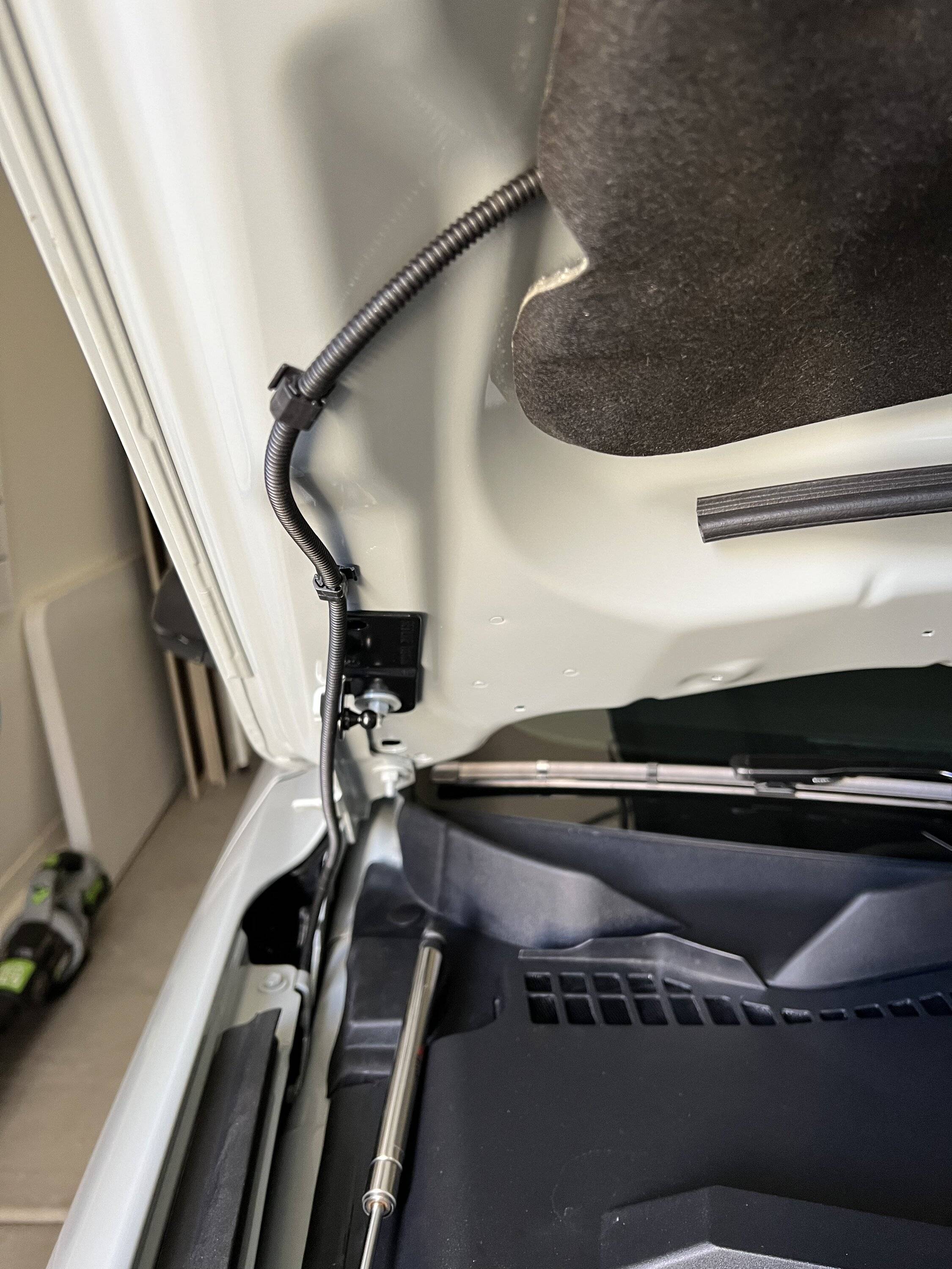

The little clips that hold the washer fluid line are grooves and kind of grip down on the line so they don’t move. Take a flat head screwdriver and pop one the clip open that’s closest to the strut and you should be able to pull just enough. You don’t need much, I’ll try to remember to snap a pic when I get home from work.

This is how much I pulled on mine. Doesn’t get pinched by the strut or by the hood
