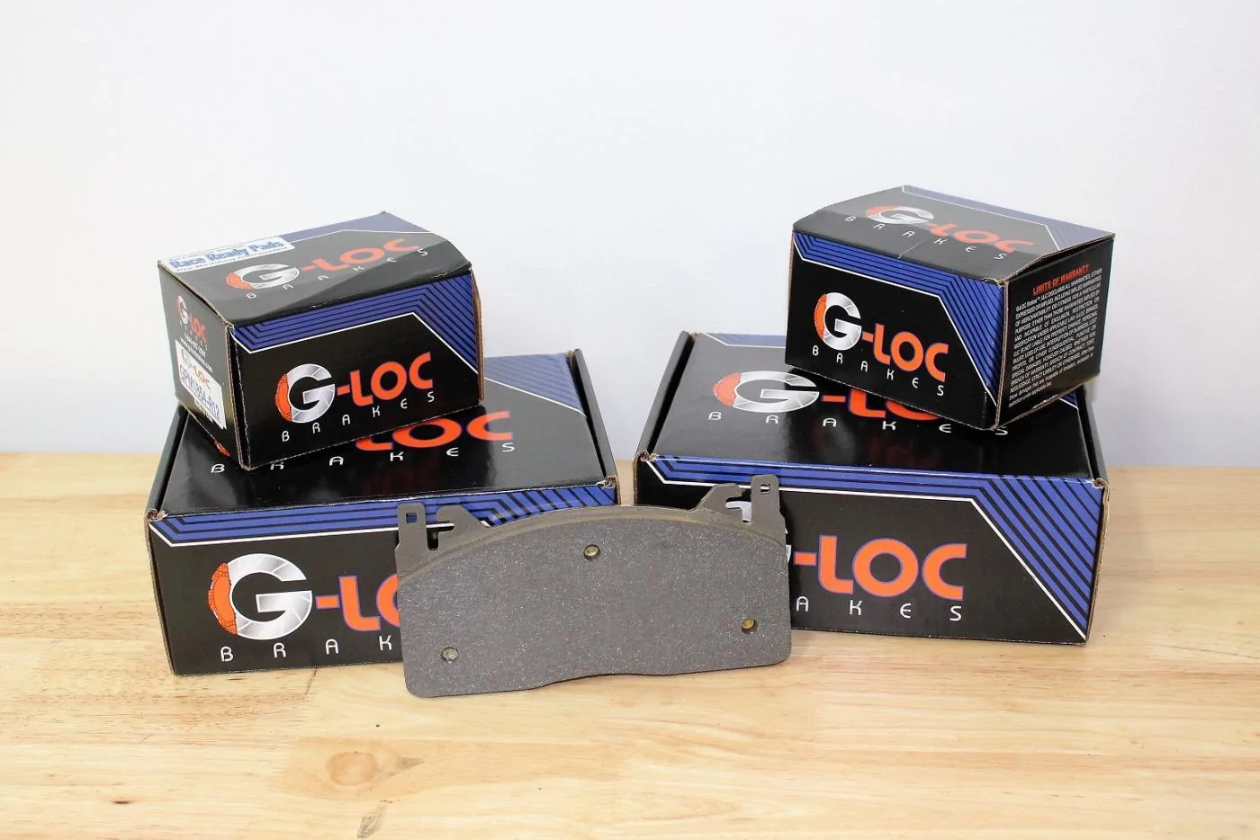

After my track days in March and my road trip, brakes were hurting. I was starting to hear tons of noise and definitely didn't have enough pad life left to complete my upcoming weekend at The Ridge.
After talking in Optimum Performance, I decided to test out a set of street and track pads from them. I went with their street pads GS-1s and then R16s (front) and R12s (rear) for the track. I went with this over the R12s because I wanted a more aggressive initial bite and Optimum was fairly sure I wouldn't overload the stock MPSS tires (more on that later).

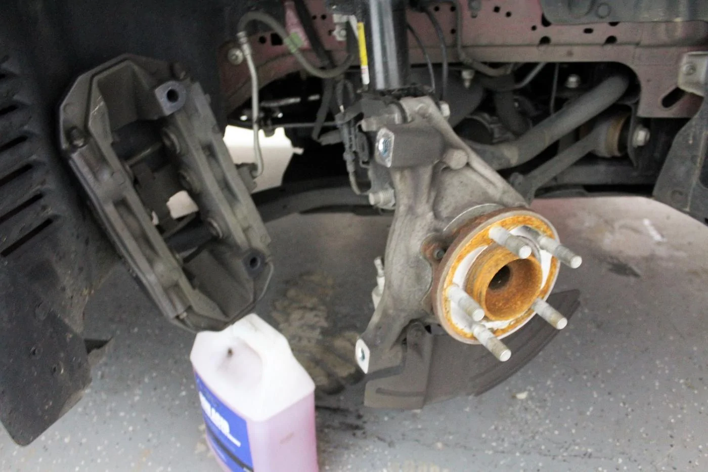

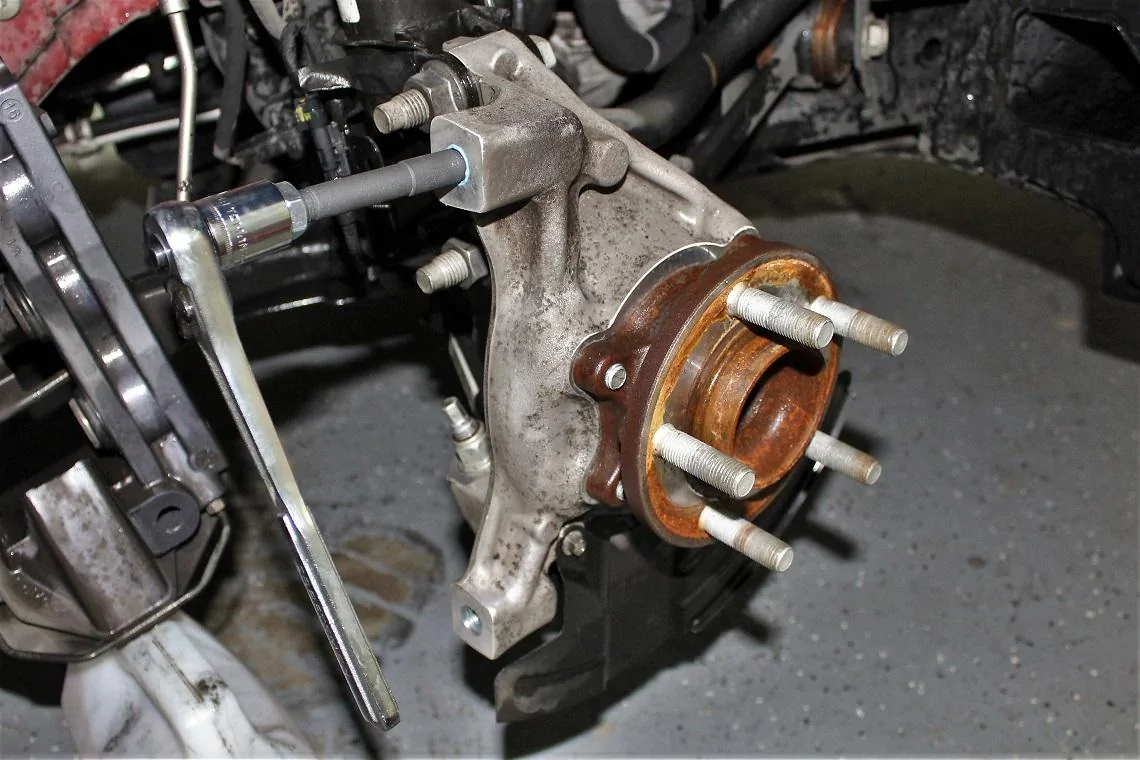

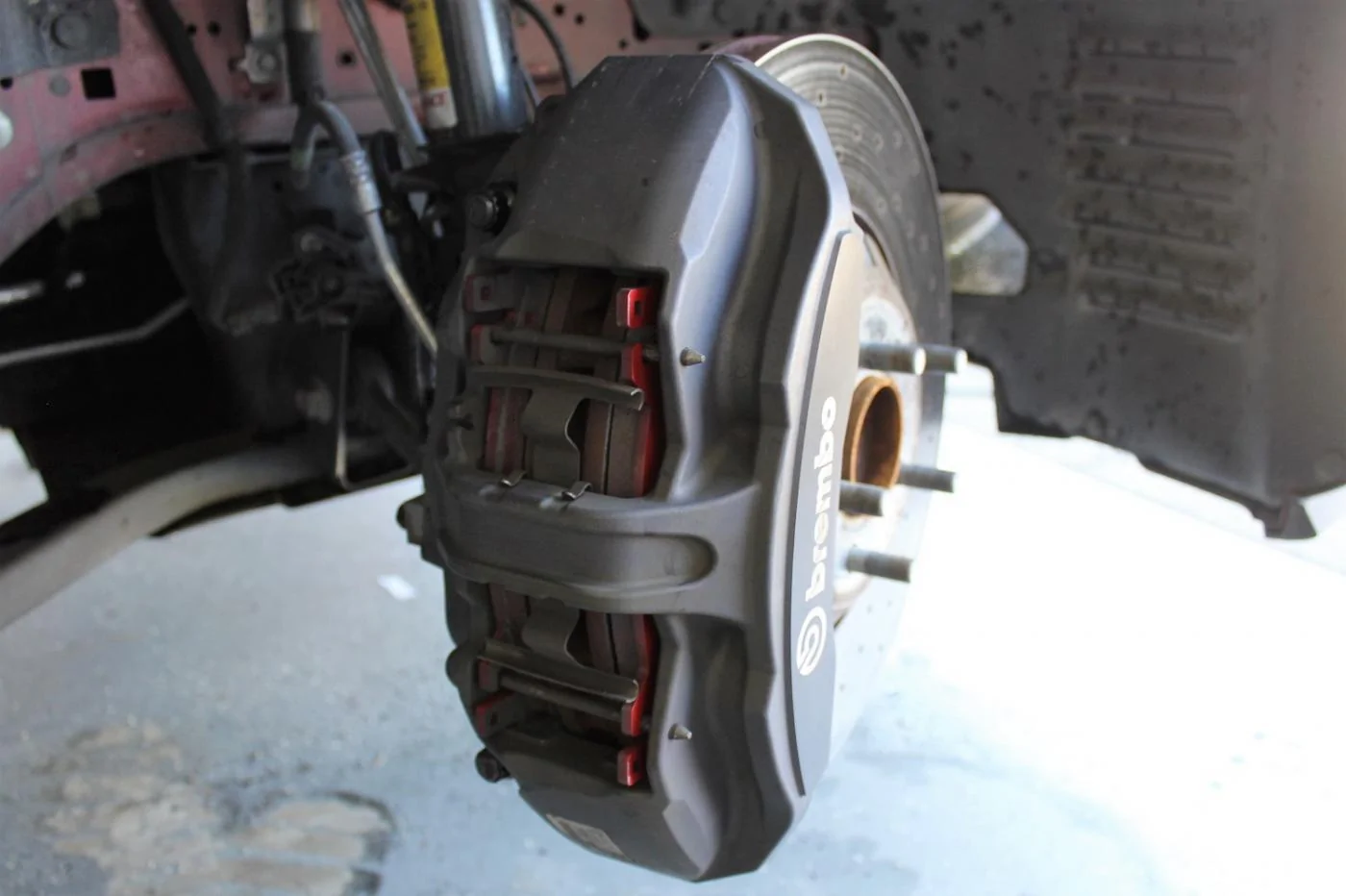

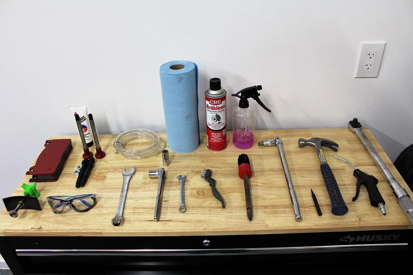

Because I anticipate swapping pads out, I bought a set of studs and sleeves from Epiphany to make front pad changes easier. Here's are all the tools I used during my stud install and pad swap.
1. Lift car and remove the tires. I did fronts and then rears.
2. After removing the tires, remove the stud bolts holding the front calipers in.
3. Then support the calipers so they don't hang. I used this high-tech setup.

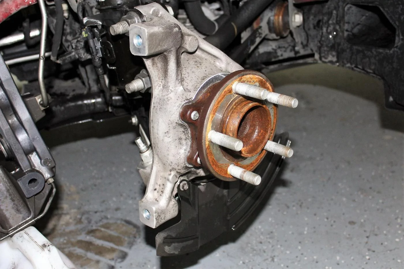

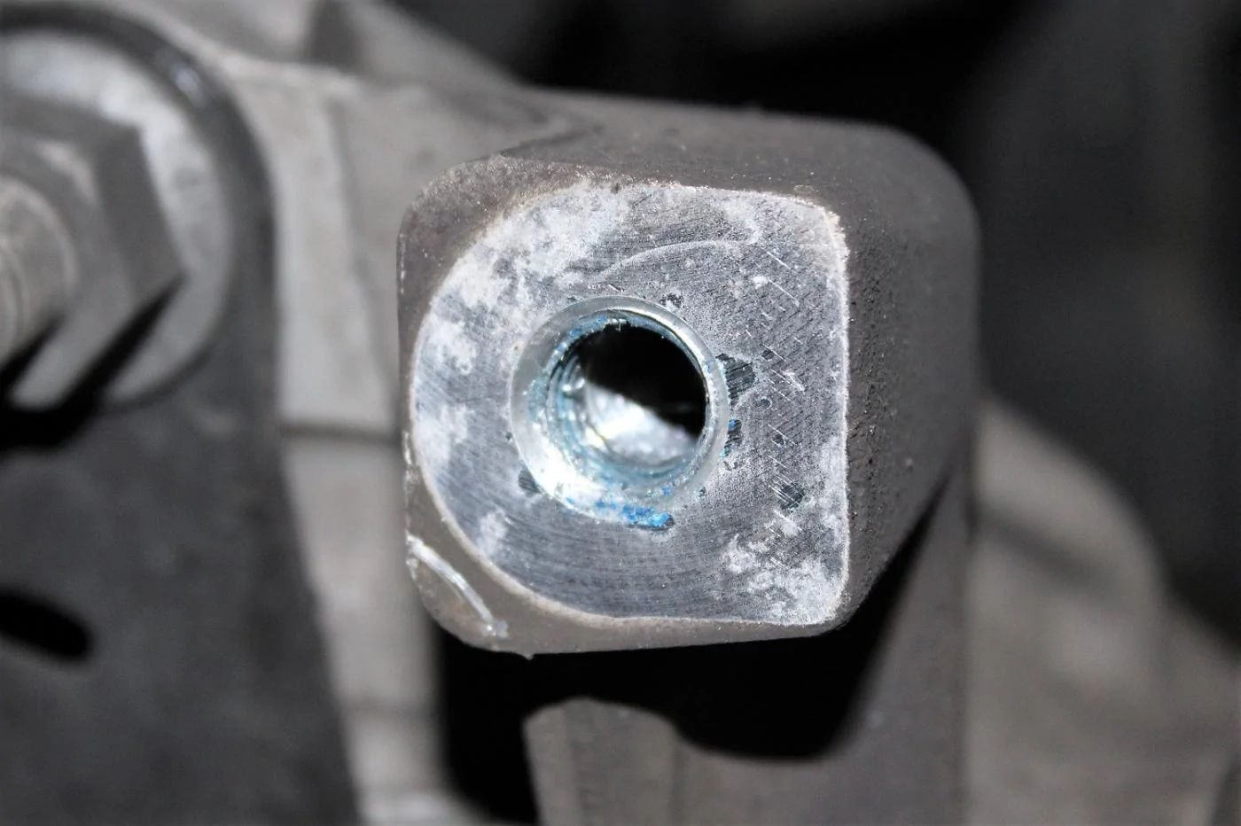

4. Make sure to clean the threads out before mounting your studs. Mine were pretty dirty. I used a wire brush and compressed air.
5. This is a good time to clean the rest of the dirt off. Here are what mine looked like after cleaning.
6. After everything was clean, I installed the studs. Make sure to follow the Caliperfexion instructions on using threadlocker and torque. They're very clear and concise.
7.Slide the calipers over your newly installed studs and attach the sleeves if you have them.

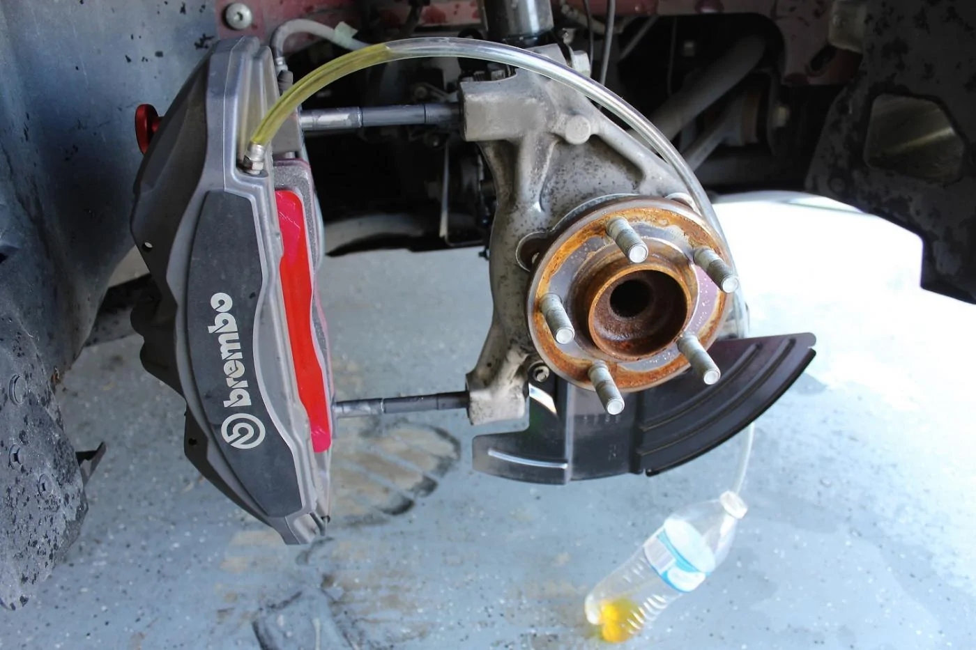

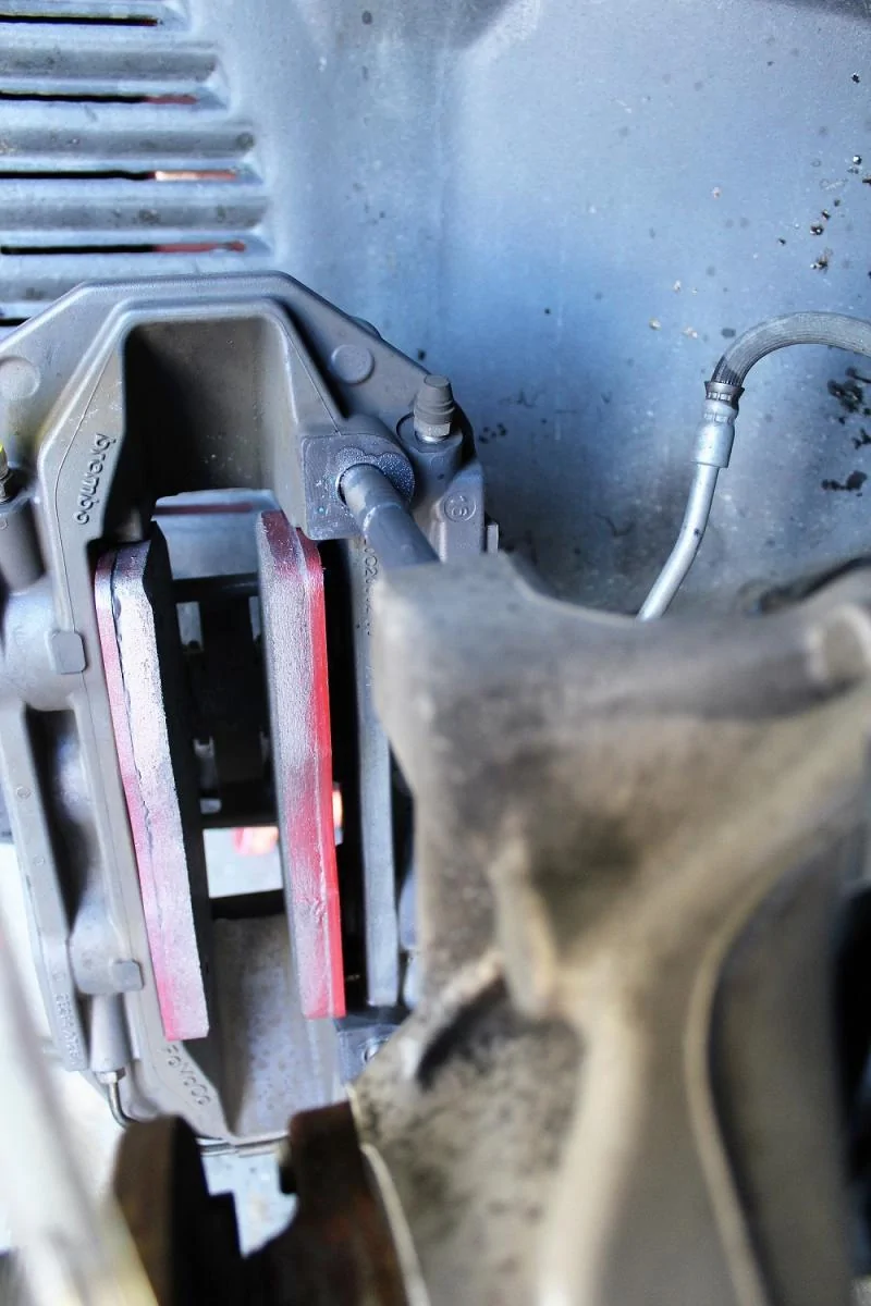

8. If your pads are worn, you'll need to push the pistons back because your new pads will have more material. Two ways of doing this...bleeding your brakes and compressing them with clamps. I chose to bleed because I wanted to check my fluid and I could do it by hand.
9. Here's the difference after pushing the pistons back.

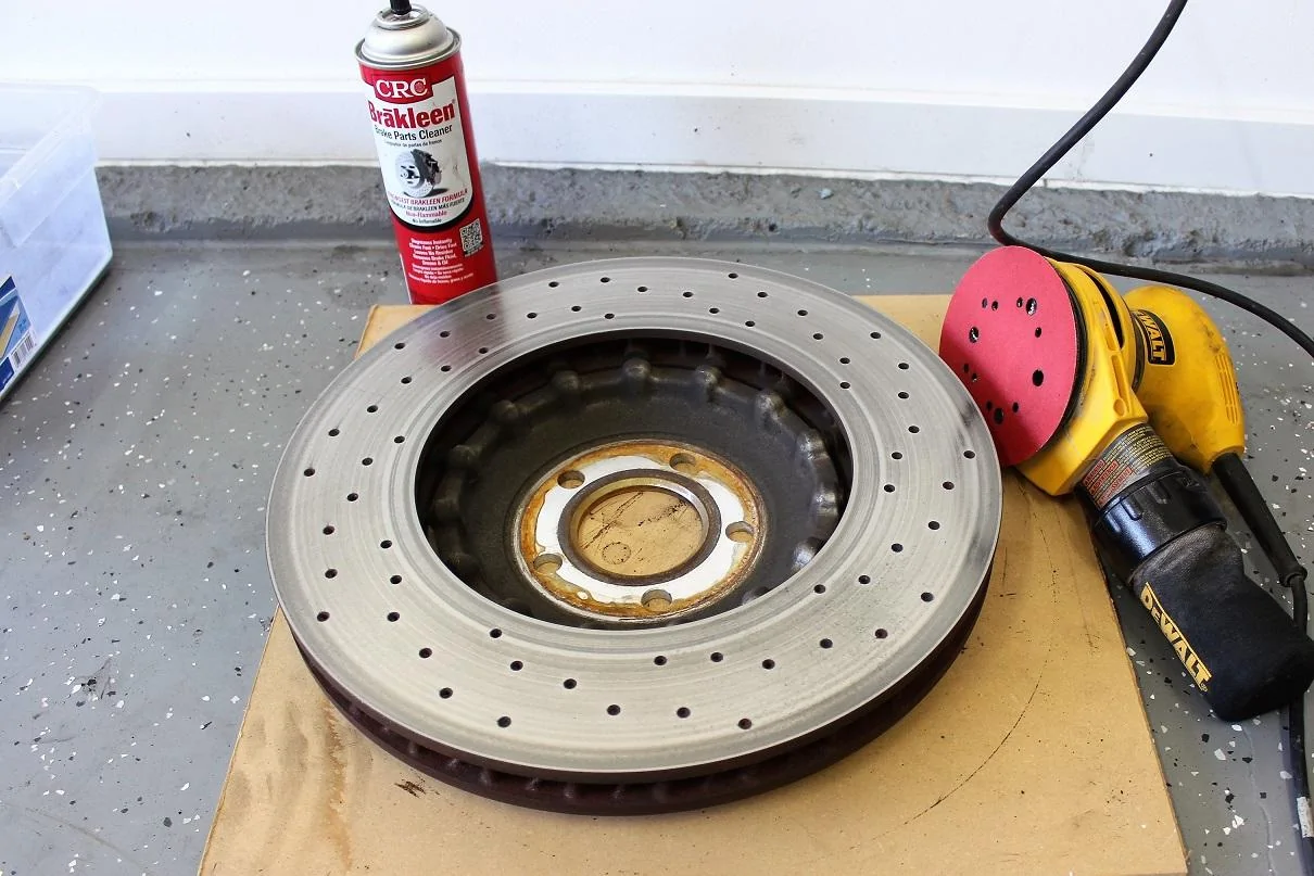

10. Next up is prepping the rotor. While best practice is to just buy new rotors, these pads were pre-bedded and the instructions from Optimum say that sanding the Rotors is fine. So I sanded the rotors down a bit, cleaned with brake cleaner and re-installed.

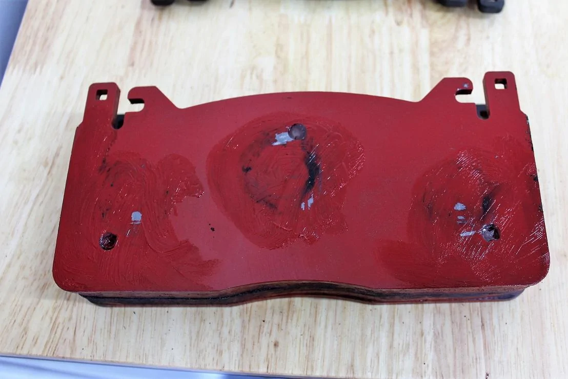

11. To fight brake squeal, I added grease to the back of the pads. This step is pretty unecessary. If you get your brakes hot enough, it just cooks the grease anyways.

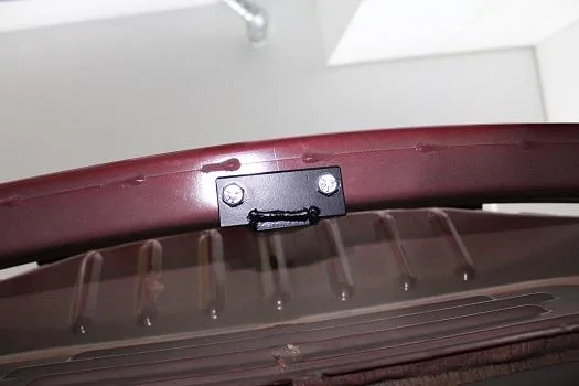

ZL1 Add-Ons - Tow Hooks
Next up are a set of ZL1 Add-ons Tow Hooks. I'm not going to sugar coat it, these were a pain.

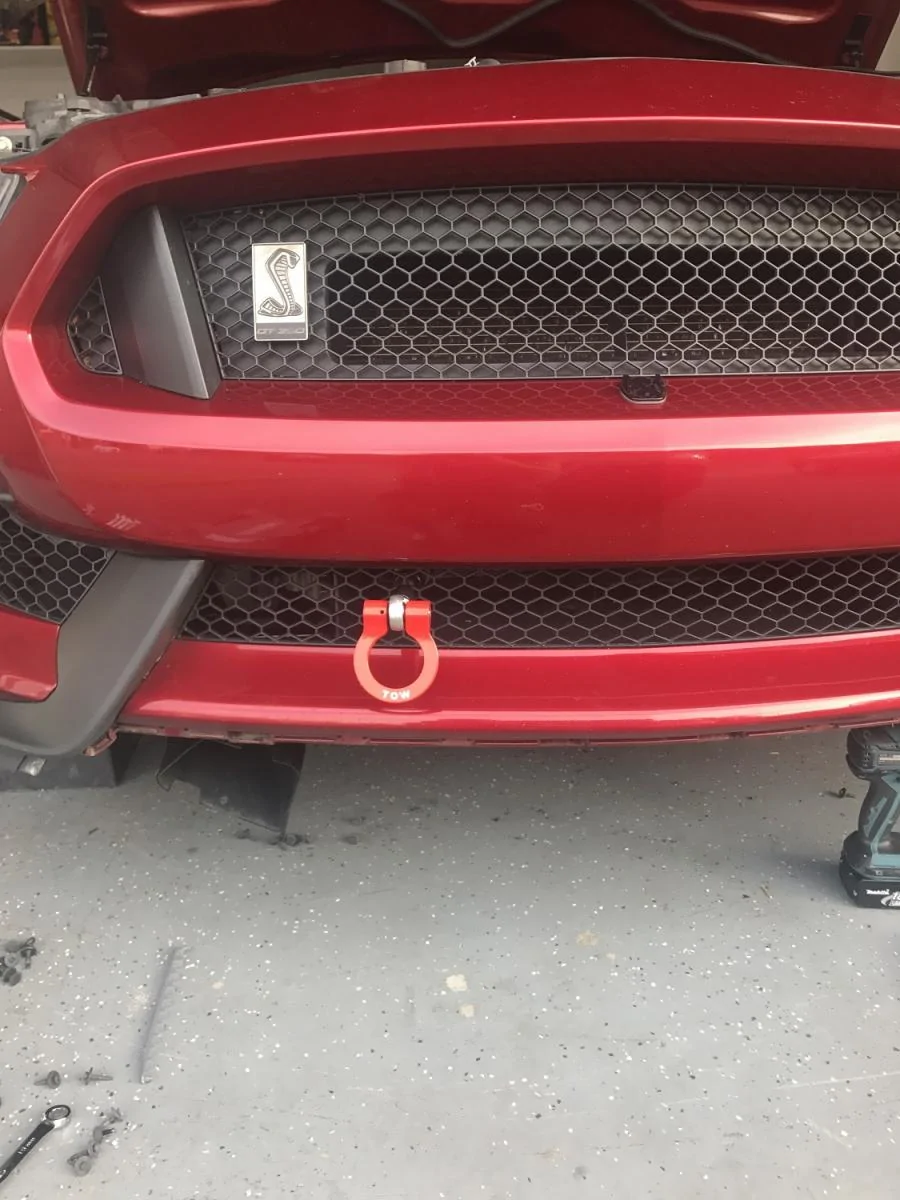

For the front, I followed the [MENTION=20243]50 Deep[/MENTION] guide located here http://www.mustang6g.com/forums/showthread.php?t=73025&page=4&highlight=zl1
If you follow that plus the instructions given by ZL1, you'll be good. My only recommendation is to not try and tighten the Tow Hook shaft and bolt while installed, but take a guess of where to line it up. If it's wrong, pull the assembly back out and try again. I messed around with trying to tighten it while it was installed in the grill for probably 2 hours to no avail. After 20 mins of trial and error, I got it.

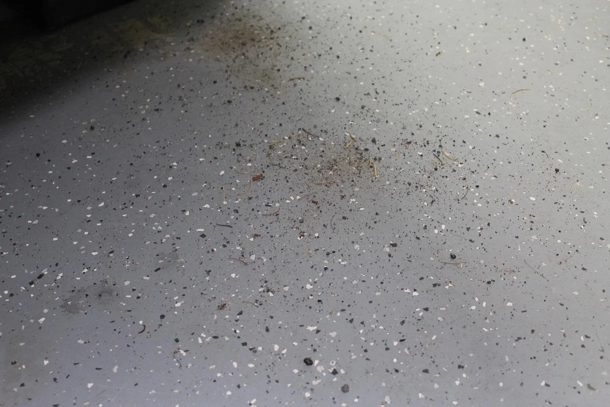

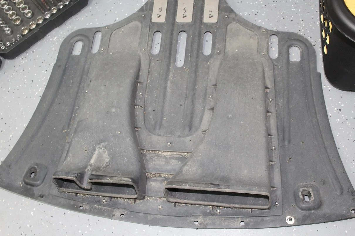

1. When removing the rear diffuser, be careful of all the dirt and your eyes. Mine was full of sand and gravel. Lots of little missiles that aim straight your eyes if you don't have safety glasses on.

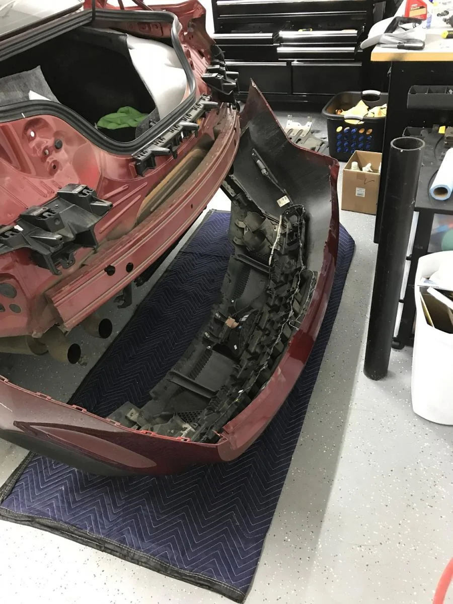

2. Remove the rear bumper by following one of the guides mentioned above. Make sure to put something soft on the ground so it doesn't slam into anything.
3. Regret step 2 as you stare at this.

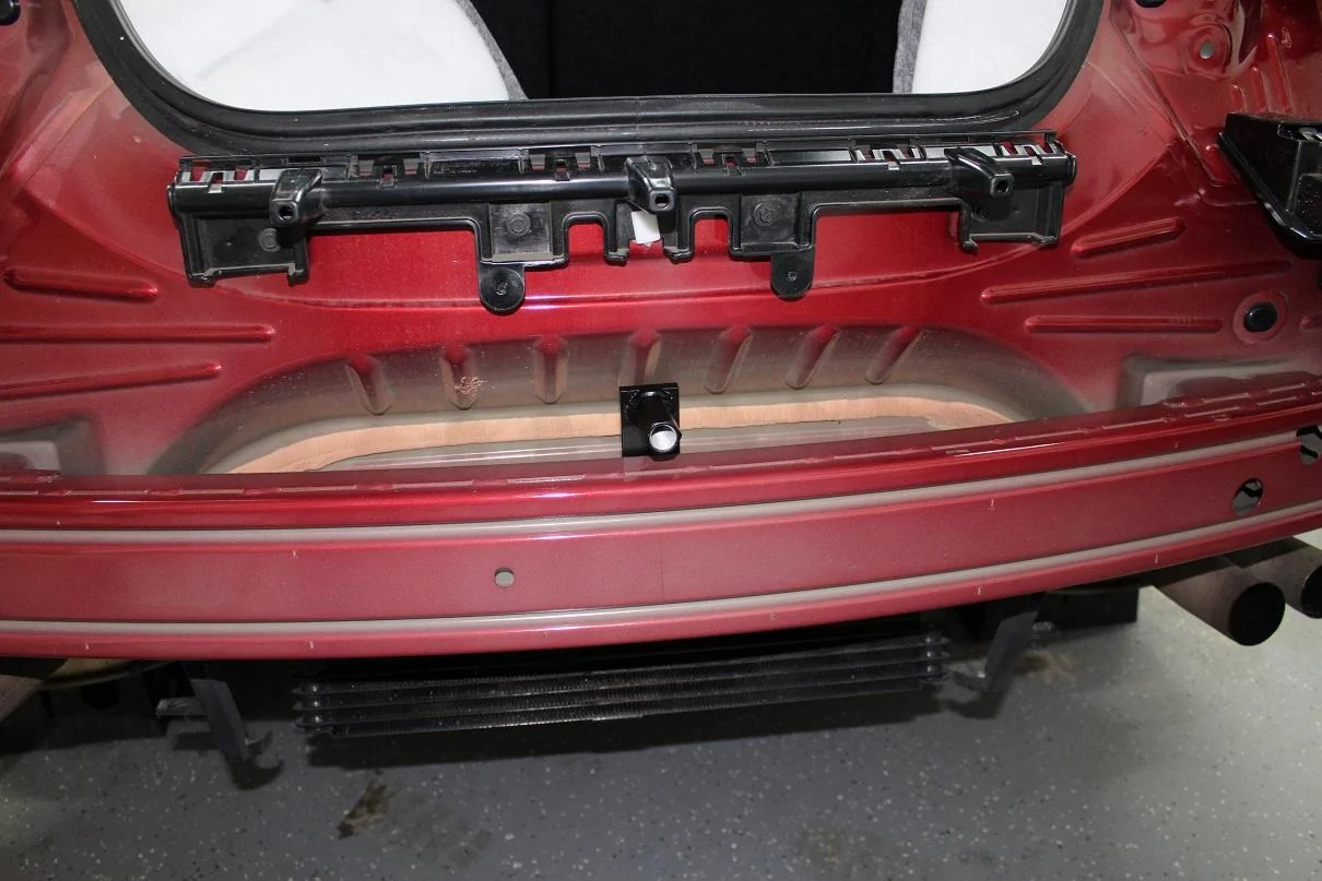

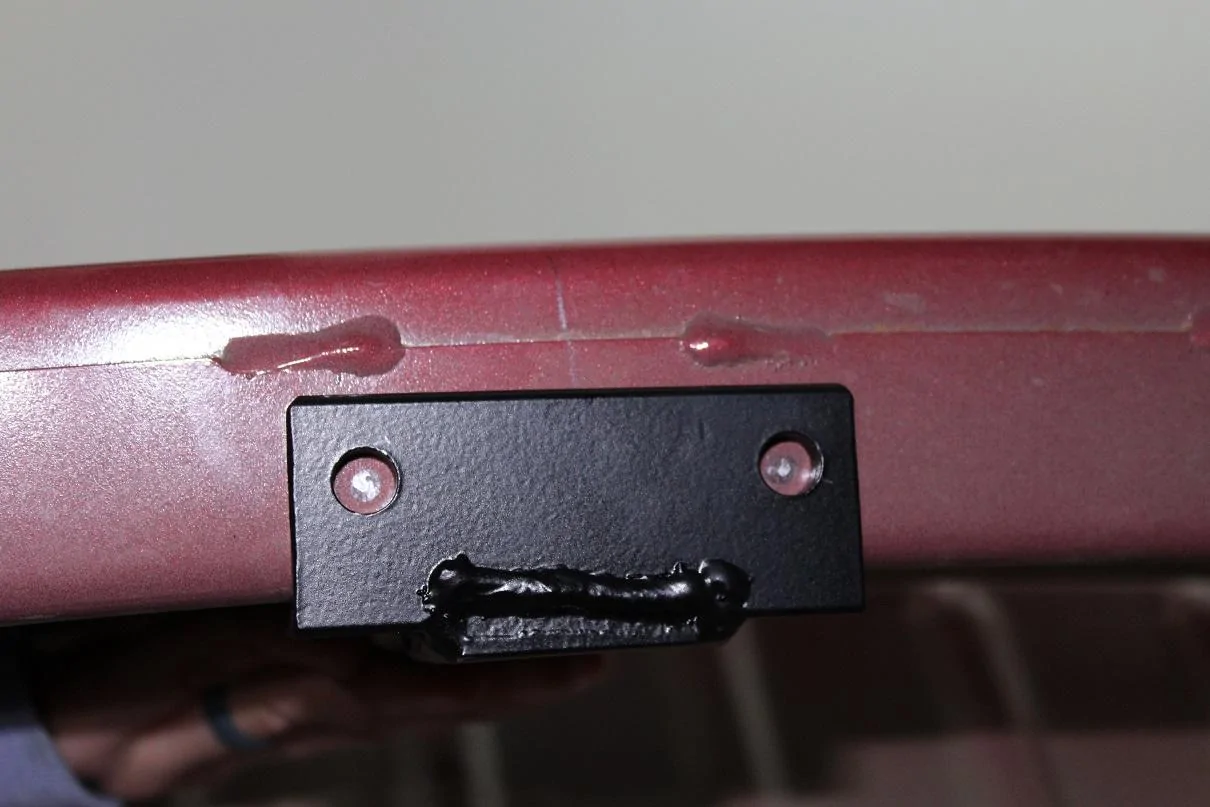

4. Gauging the placement of the tow hook is a bit of measuring and eye-balling. I measured dead center using a tape measure, then eye-balled it to make sure it lined up. In my case, it did.

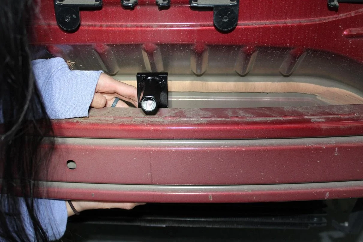

5. While you still have your lovely assistant, mark your holes.
6. Drill small pilot holes and make sure you're still lined up. Also make sure to wear safety glasses since you're drilling metal upside down.
7. Drill your full size holes. Make sure to add touch-up paint to the bare metal to prevent rust.
8. Install tow hook mount.

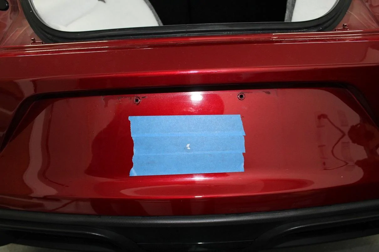

9. Re-install bumper, and tape off area where you will be drilling.

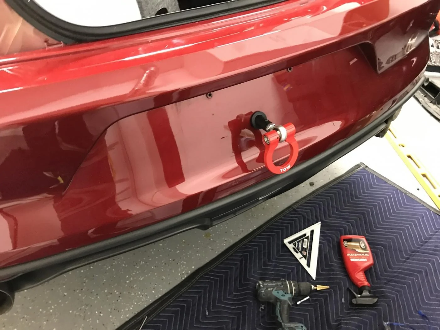

10. Here comes the part that makes up nightmare. You can measure 3-5 times, but it'll still be nerve wracking. I found that you can't really measure accurately, so your best bet is to drill a small hole where you think it should be and adjust as needed. In my case, there is a small dimple in the middle of the bumper behind the license plate. This was SUPER close to centered. This is probably a good starting point. What I did was drill a small pilot whole (3/16 in) and look through it. I saw that I was close, so I used a step-bit to drill a 1in hole. I then placed a rubber grommet in the hole to make a tight fit with the tow hook shaft and hide the sharp edges.
Overall, the install was a huge pain. BUT, the tow hook is very solid and I like that it's hidden beneath my plate. The real takeaway is Ford should've included factory tow hook mounts.

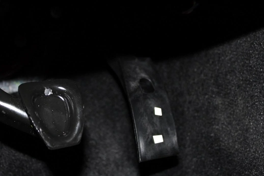

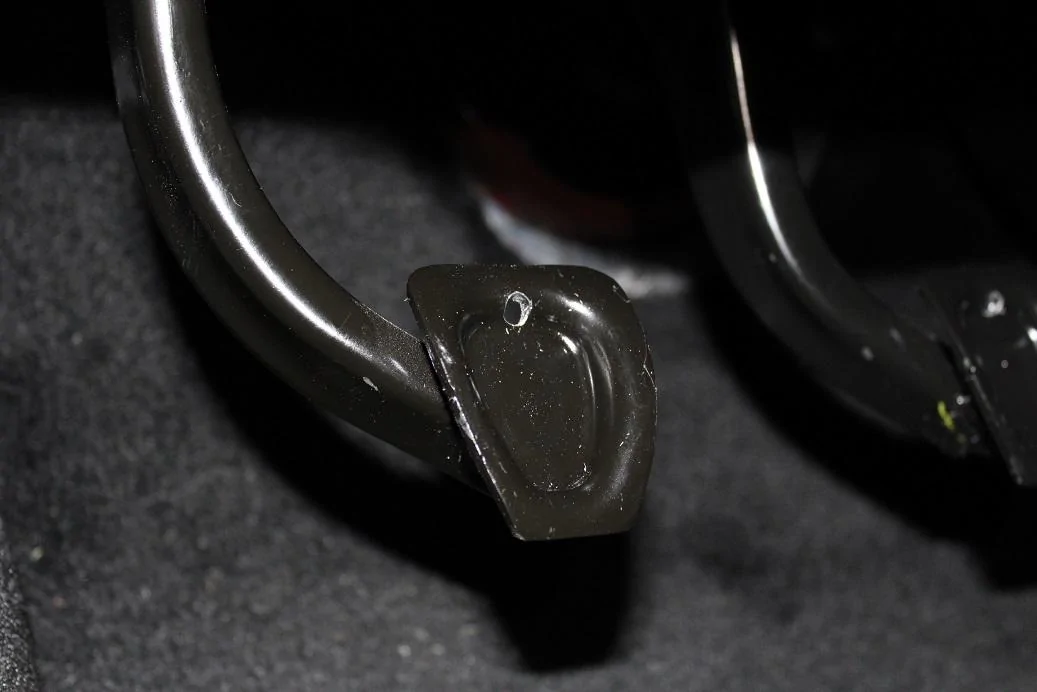

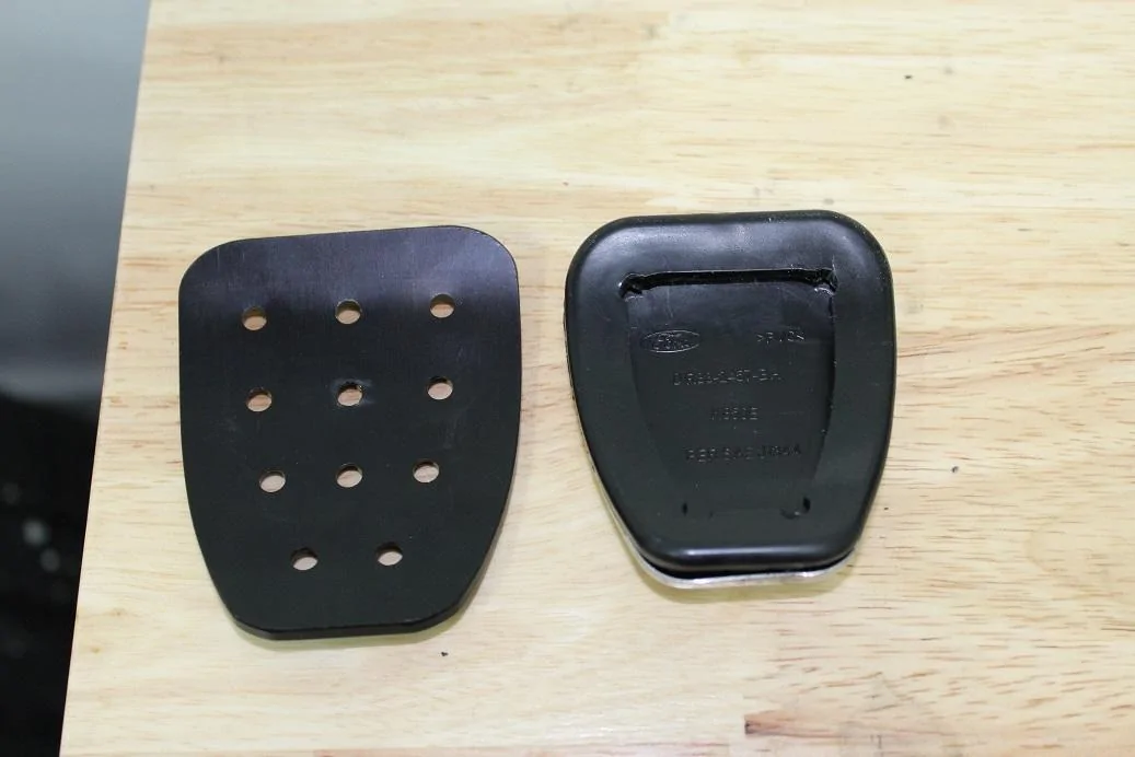

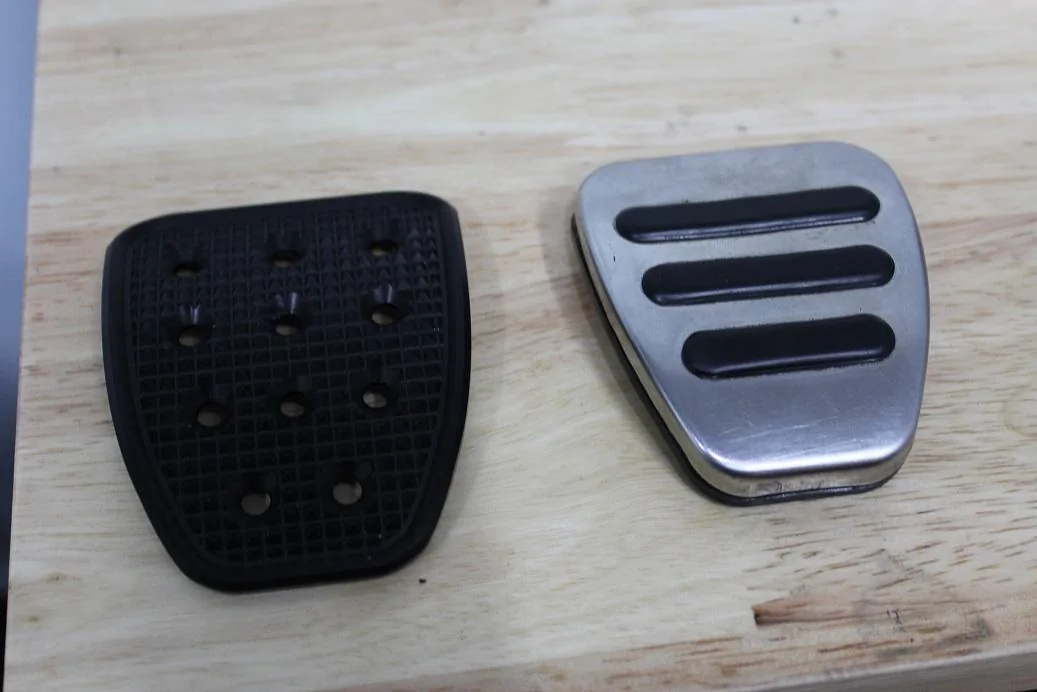

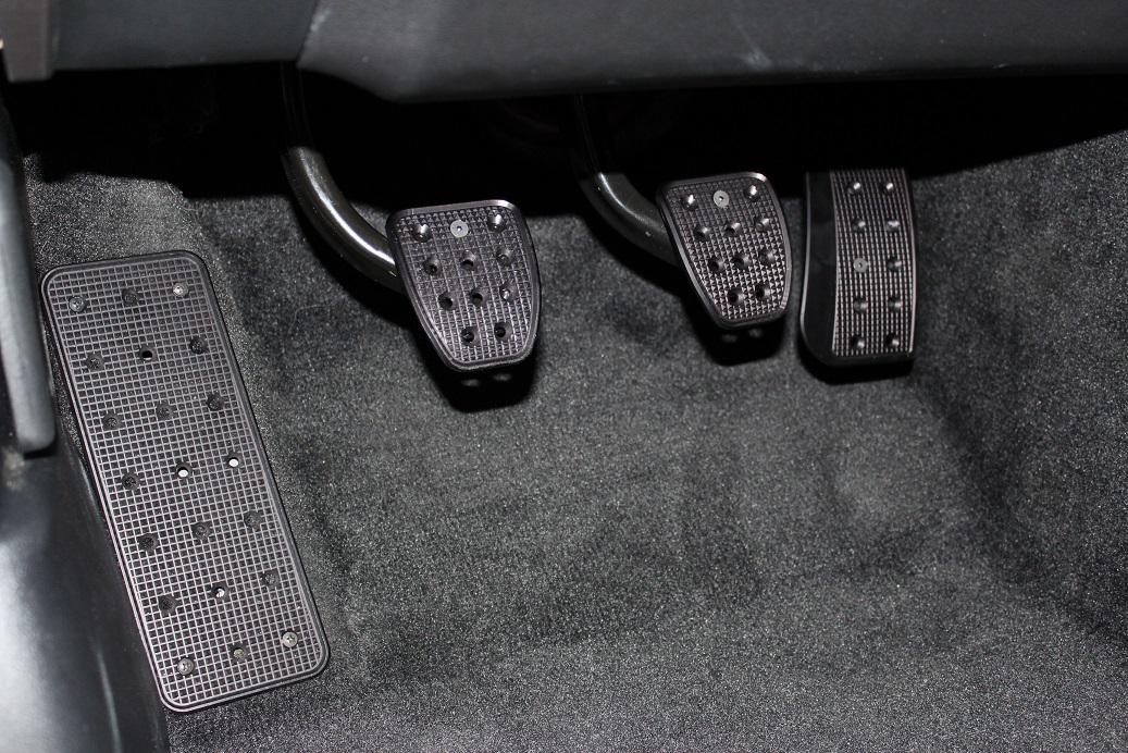

Last mod for the moment were a set of SRP Pedals. I found that if I moved the accelerator pedal forward, heel/toe was easier on the street. However, on track under hard braking, it was too close. When I was in SoCal, I got to feel out SoCal350's SRP pedals and I was sold. They're light, add a ton of grip and feel VERY solid. Only downside is the curvature of the pedal doesn't perfectly match the curves on the mounts. But it's a big deal. You can't feel it when they are installed.
When comparing them to the stock pedals, it's easy to see why. They have sharp teeth, are thinner (less squish), and a bit wider.
To mount the brake and clutch pedal, I just drilled out this existing hole to size and attached. Some of you might want more than one bolt, but this feels solid, doesn't move on me, and was simple without compromising the integrity of the metal backing pedal.
For the accelerator, I used double-sided tape to mock up where I wanted it and then drill through he plastic. I used 2 bolts for this one.
For the dead pedal, I just found 4 black screws and screwed into the plastic underneath the carpet. Overall, they turned out great. The pedal feel is AWESOME. Heel/toe is much improved. This is one of those mods you don't know you need until you try it. 9/10

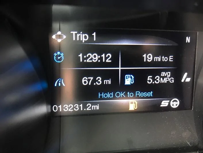

This is a new record for me. Only 67.3 miles out of a tank of gas. HA

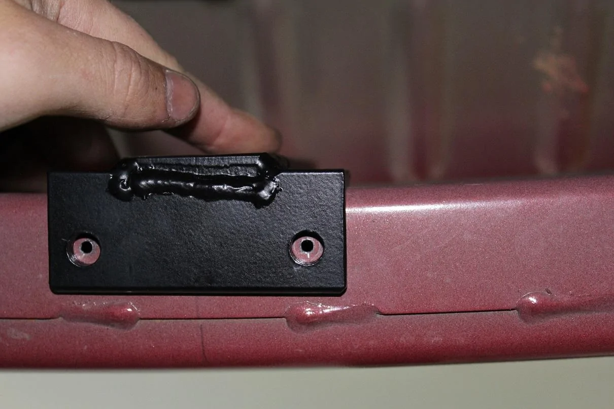

ZL1 Add Ons needs to hire somebody with welding experience. Those are some of the worst welds I have ever seen on a commercially available product. A tow hook/mount, of all things, shouldn't be deficient here.
Or better yet, how about you design and manufacture us a kit? :D I'd buy it!

An apology is in order. This is a great thread and you've made it very enjoyable to read as you cover a pretty wide array of subject matter and the photos/videos make it a breeze to follow. So I shouldn't have chosen this thread to voice any displeasure. Keep up the good work and I look forward to following your exploits with this car.
Fodder for another thread but if I had my druthers, I'd swap in the steel bumper from an export Mustang, drill the fascia, and use a factory hook (a rather interesting piece that you can get from your Ford dealer). A painted plug to pop in when the hook isn't in use too, ala the export models.
