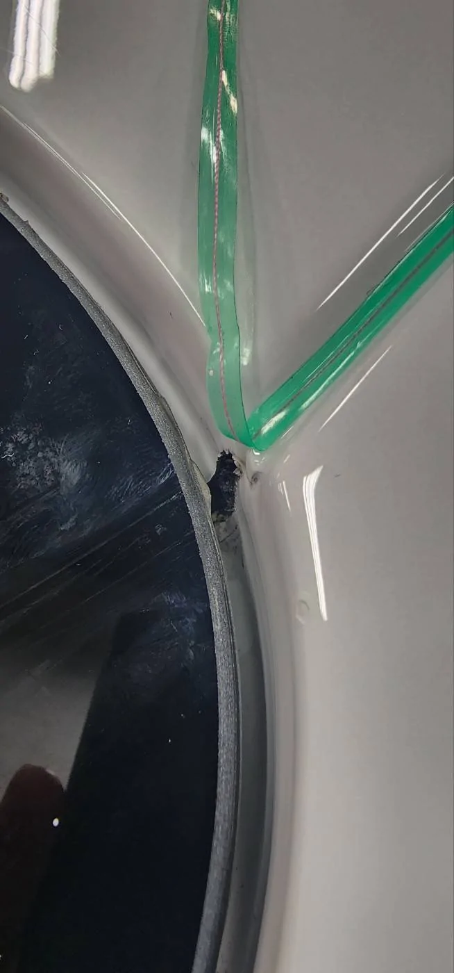

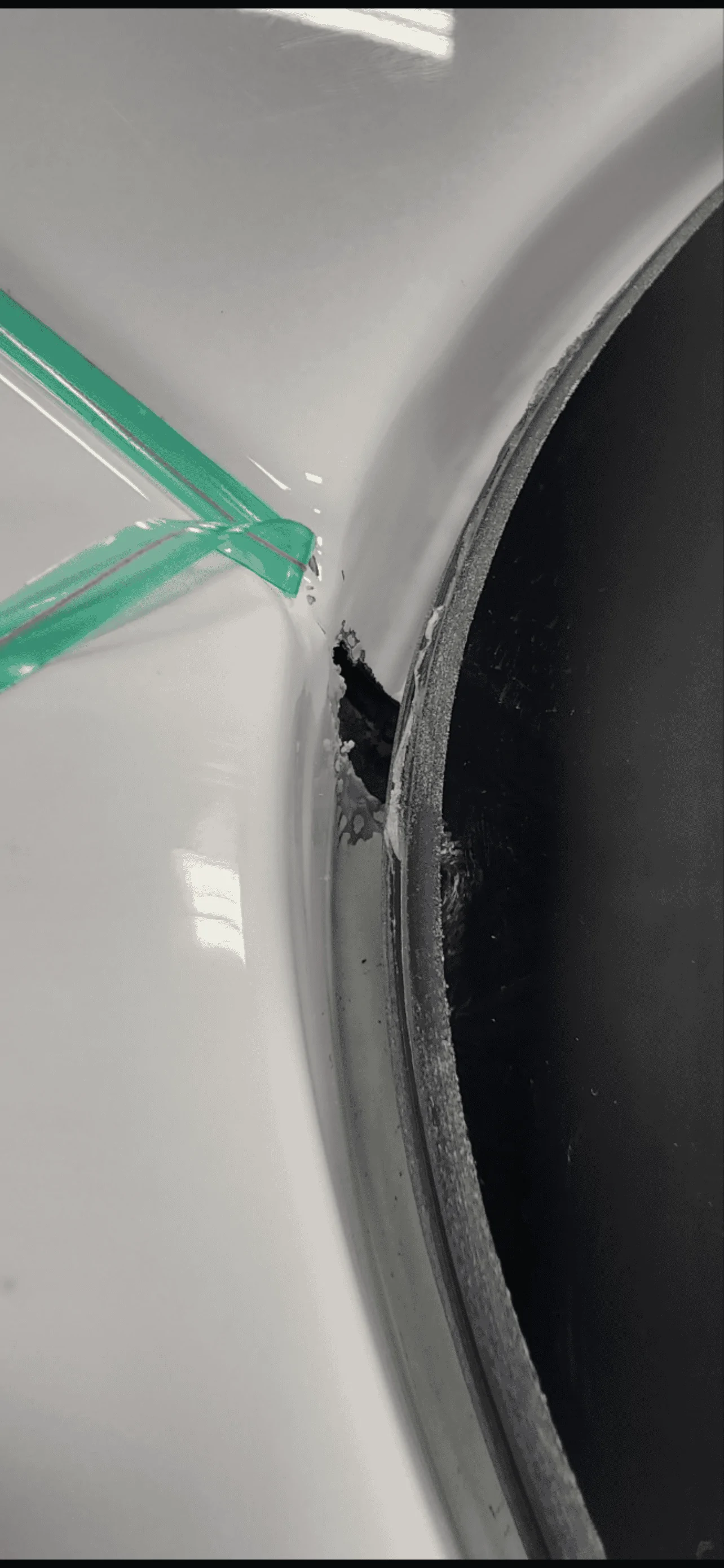

Today I just noticed two holes on both sides of the a pillar and roof. Where the holes are there used to be body colored silicone.
What do you guys think the problem is, and what is needed to repair it. I bought it brand new and still under warranty

Take that in for warranty repair, otherwise you will end up with rusting issues.
This is specific to the A-Pillar, but not sure it's the body seam, as it seems to be addressing water intrusion lower than the roof:
https://www.mustang6g.com/forums/th...-s550s-a-pillar-water-intrusion-leaks.178242/
Check this thread regarding the rear window channel seam cracking and paint delaminating issue - similar to the front roof channel seam issue. Some M6G members are having severe cracking at the rear window channels, not many at the front. This one is the most complete with M6G owners experiencing severe cracking at the rear window channels:
https://www.mustang6g.com/forums/th...ater-leaking-into-rear-quarter-panels.143545/
