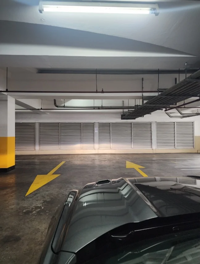

Not done researching projectors so I modded the fogs first.
I put in 3" LED projectors in the fog locations today and while I havent driven with them at night I can see the difference in a parking building I regularly drive in.
Lights off

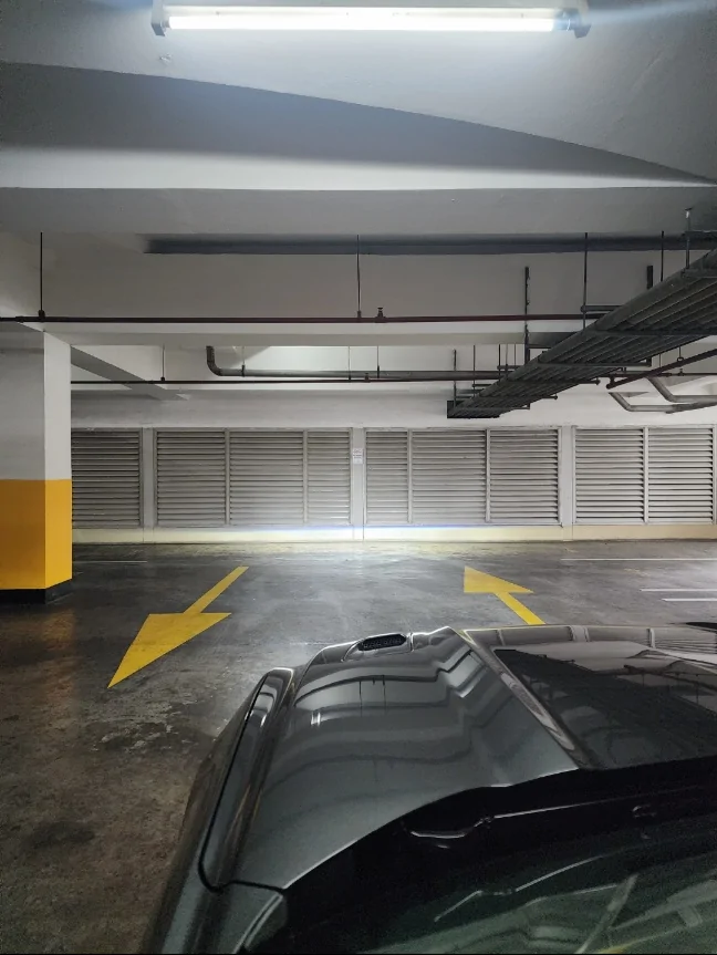

Headlights on

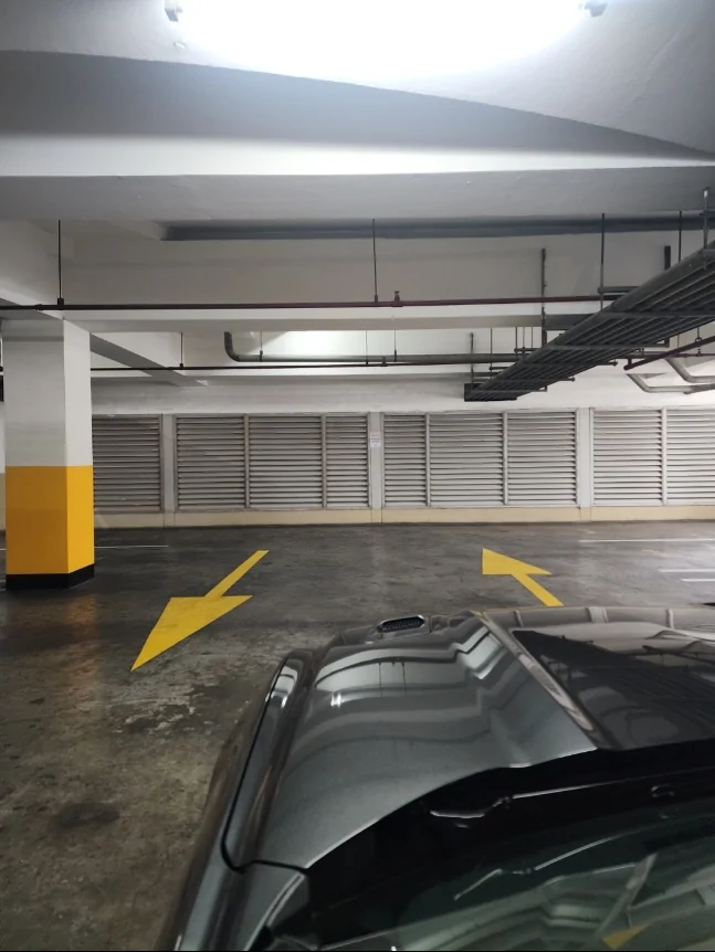

Projector foglights on

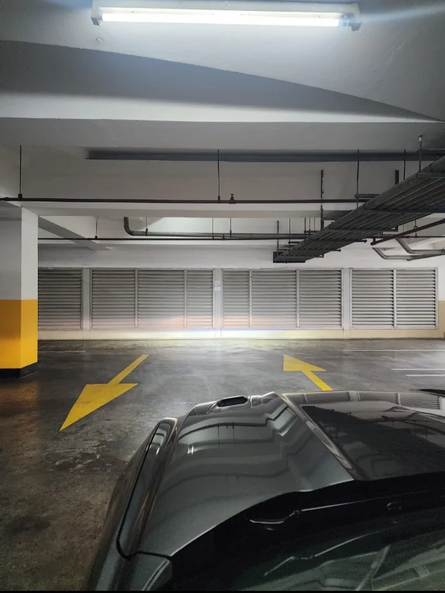

Projector foglights + headlights on

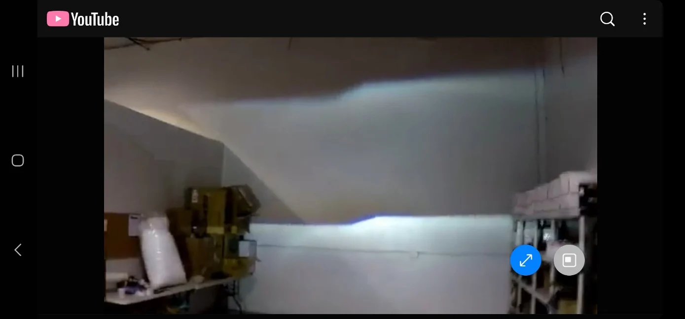

I'm still looking for a headlight projector upgrade, I've been searching online for RX350 projectors or RX350-pattern LED projectors, but not getting many results.
I did find a vid by Lightwerkz Global where they modded an RX350 with clear lenses and adjusting lens and cutoff shield positions to suit. Looks to result in a big improvement in output!

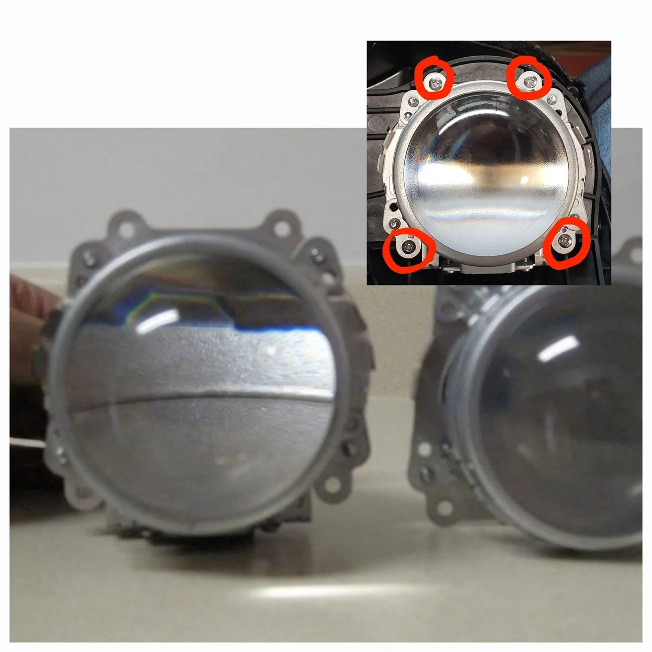

@offroadkarter, thanks for the tip the headlight projectors of the 2015-2017 S550's are RX350's.
It did get confusing as there are apparently a few different versions of these projectors but thanks to @RileyZ 'S pics, I think I've narrowed it down to the 3" bi-xenon non-AFS RX350's.
Right now it looks like RX350's are scarce and the G5's more common and better, and there are LED projectors in this pattern in the market. I'm wondering if the RX350 to G5 adapters by Lightwerkz and others will work, as they are labelled to be for AFS versions.
