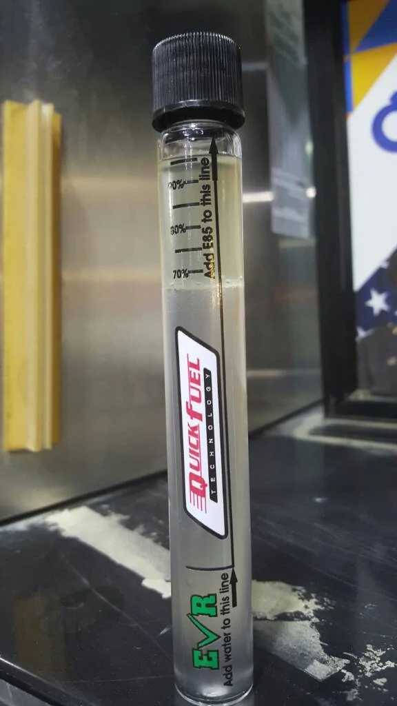

Testing every ethanol pump within driving distance of my house last night revealed three things to me:
1: Reading the test tube instructions actually IS important.
2: Kroger is apparently very consistent.
3: If it has a sticker on the pump that says at least 70% ethanol, just go somewhere else.
My first tank was 70% because I filled up before I got my test tube. I ran that tank dry and filled it up with 85% from Kroger.
I found that not inverting the test tube before letting it settle shows wildly inaccurate results like this:

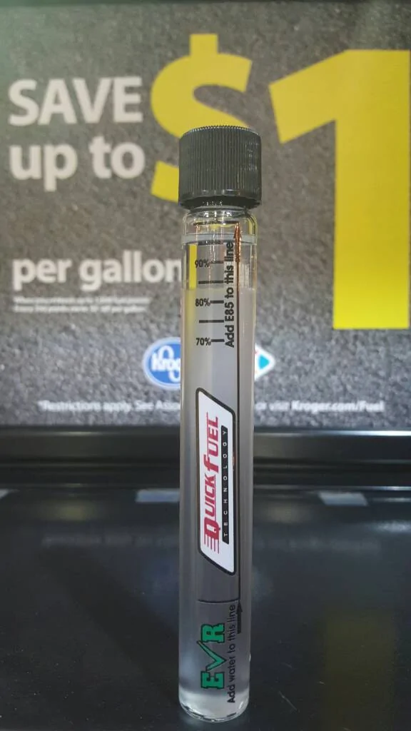

When actually it was this (after trying it again after inverting it):

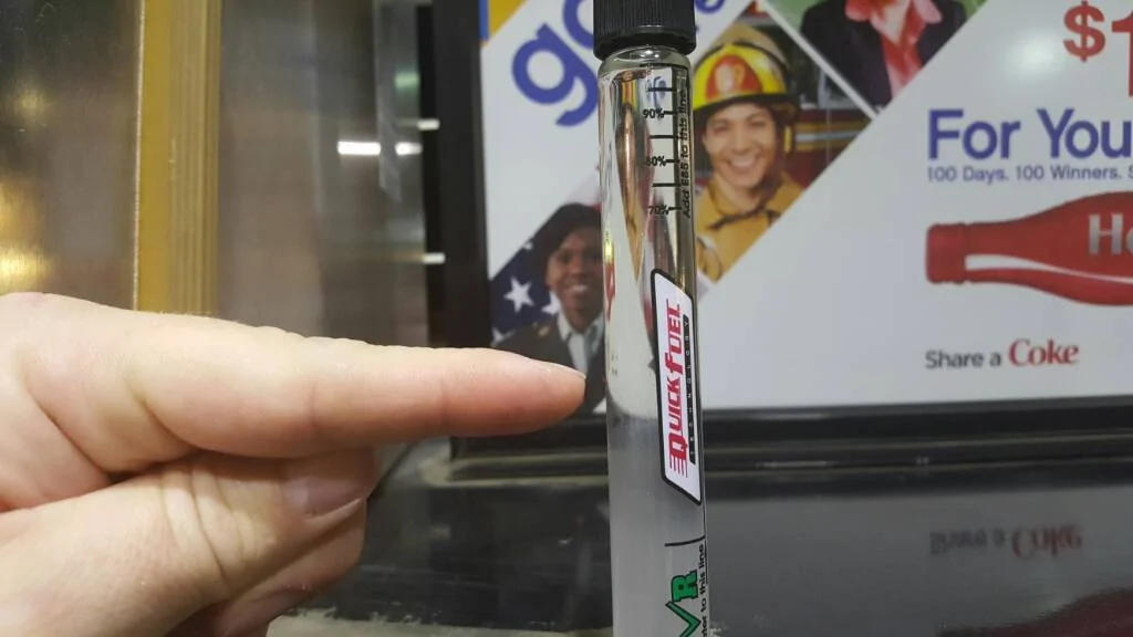

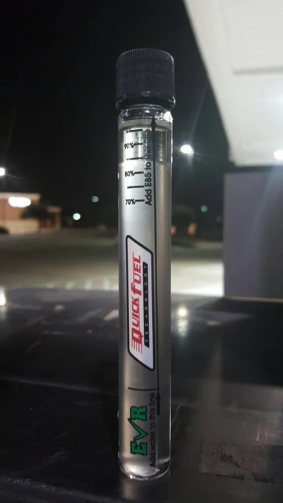

But Kroger, on the other hand, two locations, twenty miles apart:
