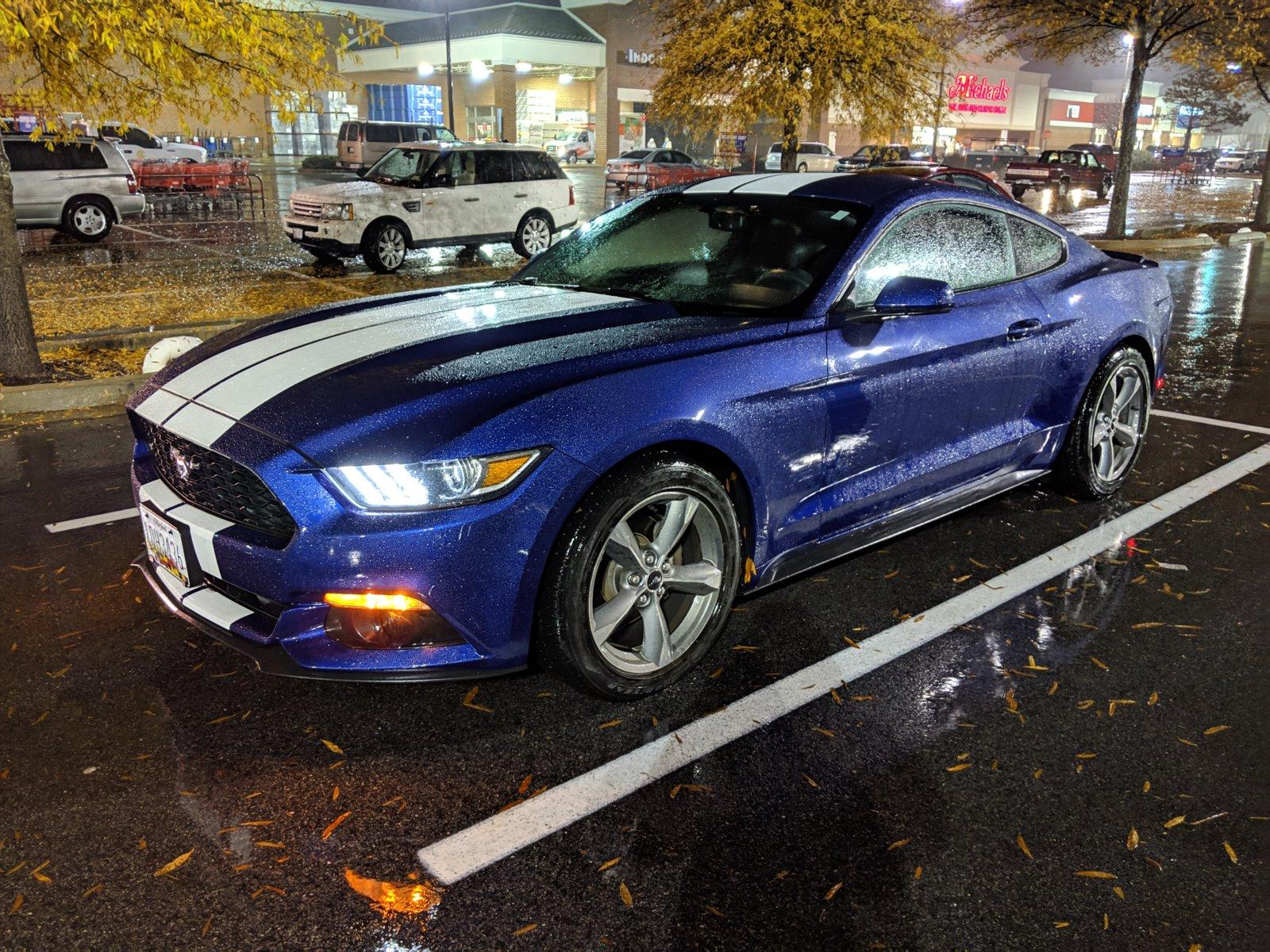

So after my unfortunately short time with the 18 GT, I decided to come back to the V6! The lower payment and better mileage is very welcome... Got the car used of course, 2016 with 29k miles for less than $17k. Plan is to make this exactly what Ford didn't want to make. An Ecoboost V6 premium Mustang! I'll have a build thread soon.

My quiet hopes of you getting a Camaro and sending that low price digital dash are destroyed! Kidding, welcome back to the V6 life, can't wait to see everything you do with this one! Just make sure to update your signature and vehicle on the profile.
Looks like it has spacers already too?

Haha sorry! The cluster is one of the first things that will be going into this vehicle.
Took delivery today and I already installed the sync 3 screen and 25mm wheel spacers. Trying to gather up the components needed to complete the cluster swap and then that will be next in terms of mods. Looking to get a GT 3" catback (in prep for the turbos, maybe MBRP but not sure yet) and tune. Will likely be swapping out the radiator for an EB unit in order to utilize an EB style intercooler and have more room for plumbing. It will be a bit before I have all the supporting mods in place to install the turbos but at least it should be fun building it up! I wasn't able to do that with the GT which made me enjoy it less.

You definitely do not waste any time whatsoever! At this rate, turbos will be done by end of January.
I know it's compatible and all, but why the Ecoboost turbos instead of one of the other kit options out there/coming up shortly? The other kits should be just as daily driveable while having way more potential for power.
