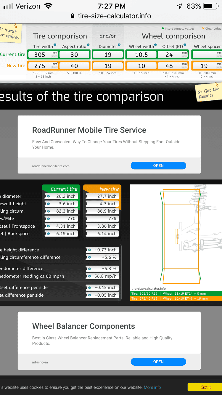

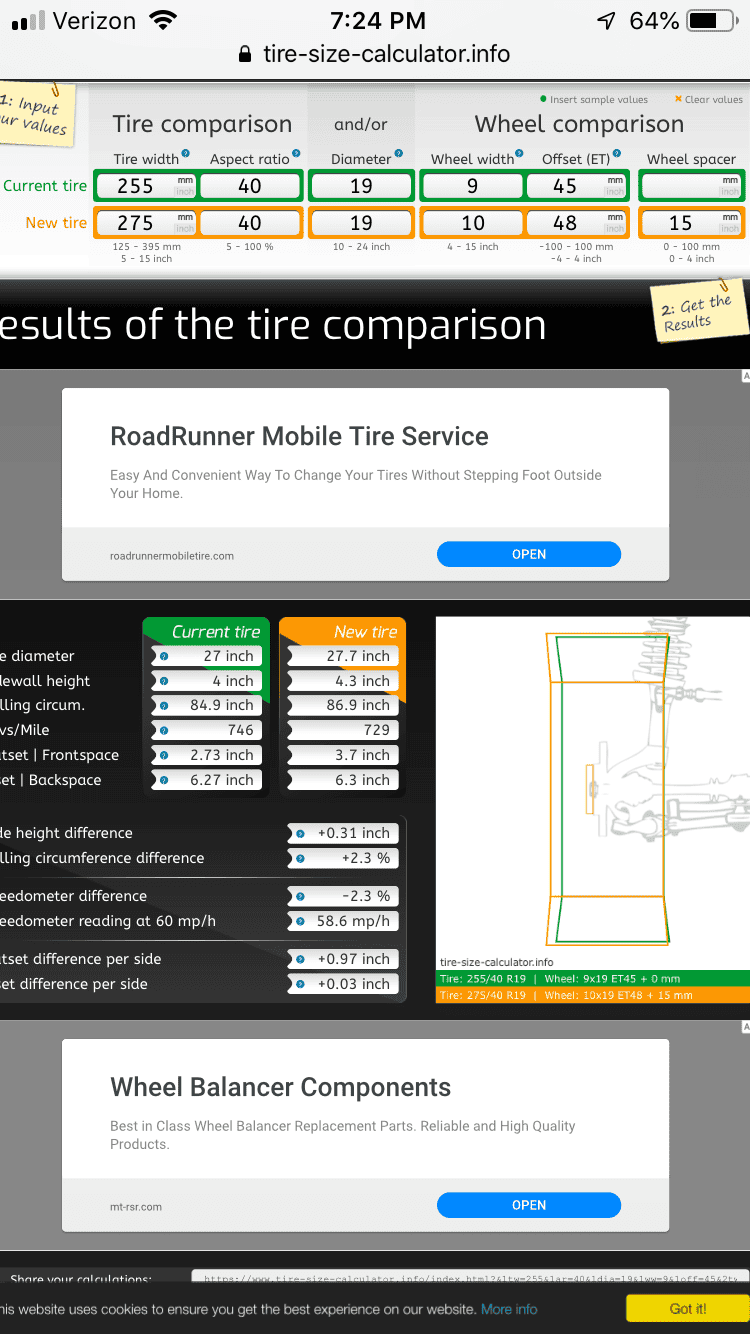

What tire are you mounting? If it is on the larger side, at the very least the tire will rub.
If it were me, I would get a bigger spacer. It looks close.
Since you know some measurements, enter the wheel, spacer and tier into this calculator(https://www.tire-size-calculator.info/ ) and see if it will be wider. You might even be able to measure from the hub face and see if the tire could rub
