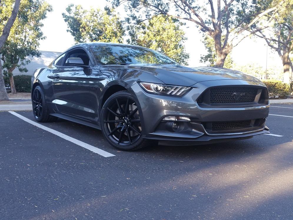

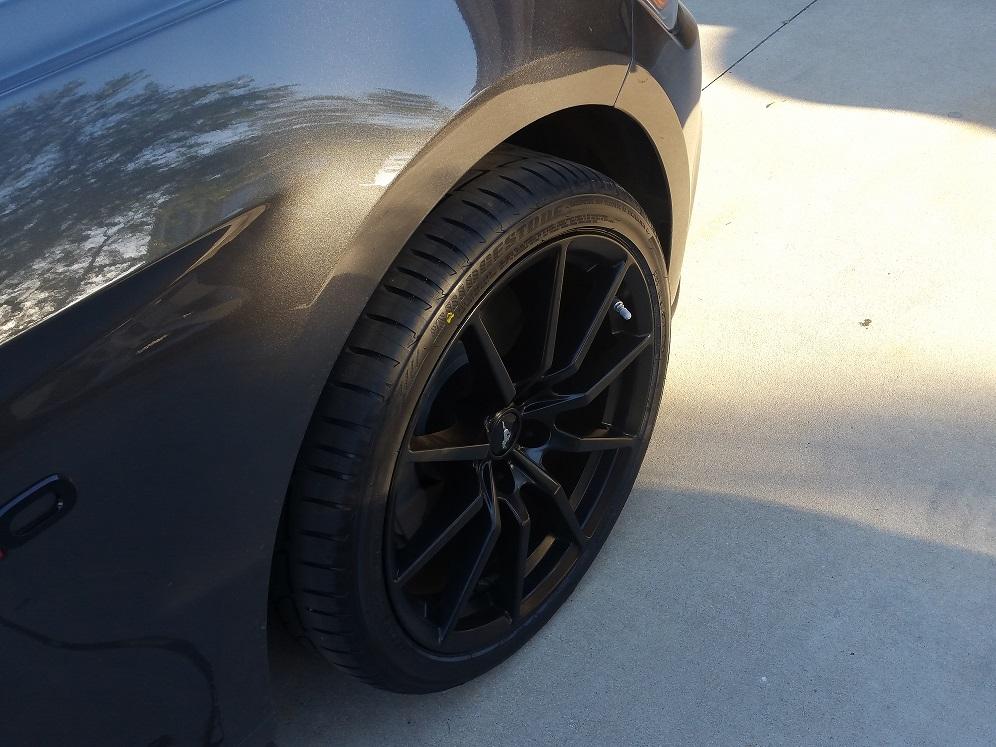

Ashiq73
Ashiq73
Nov 13, 2015
68
295
89
Southern California
2016 Mustang GT 6 Speed Magnetic Metallic

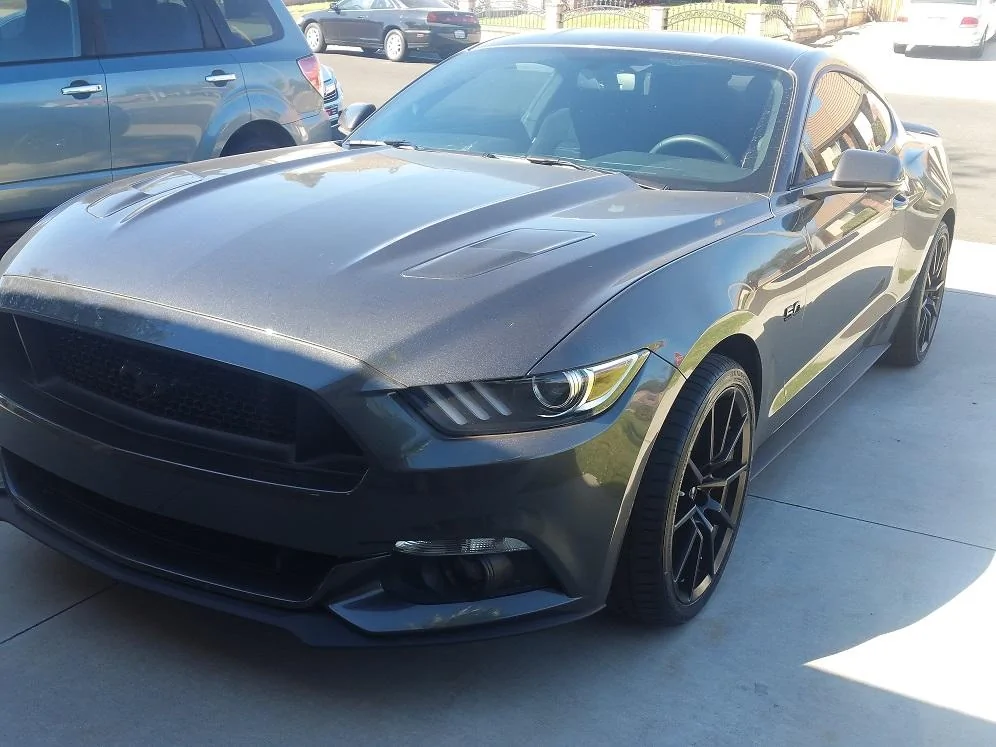

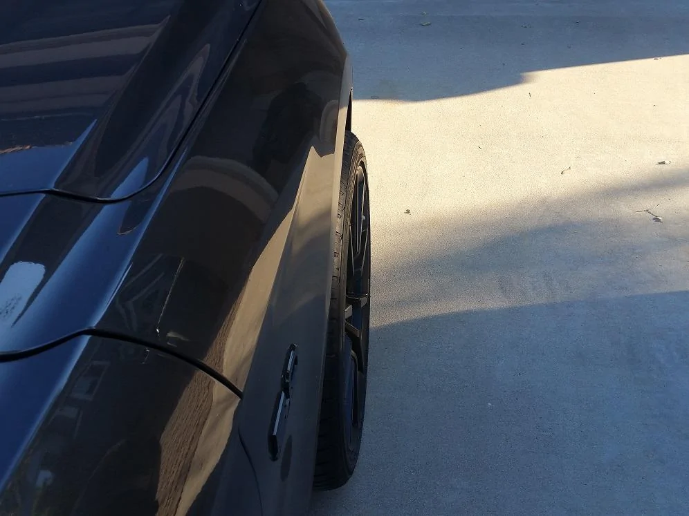

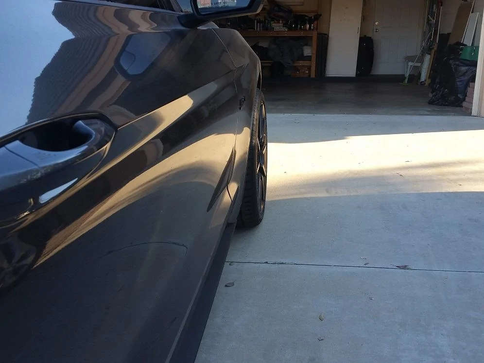

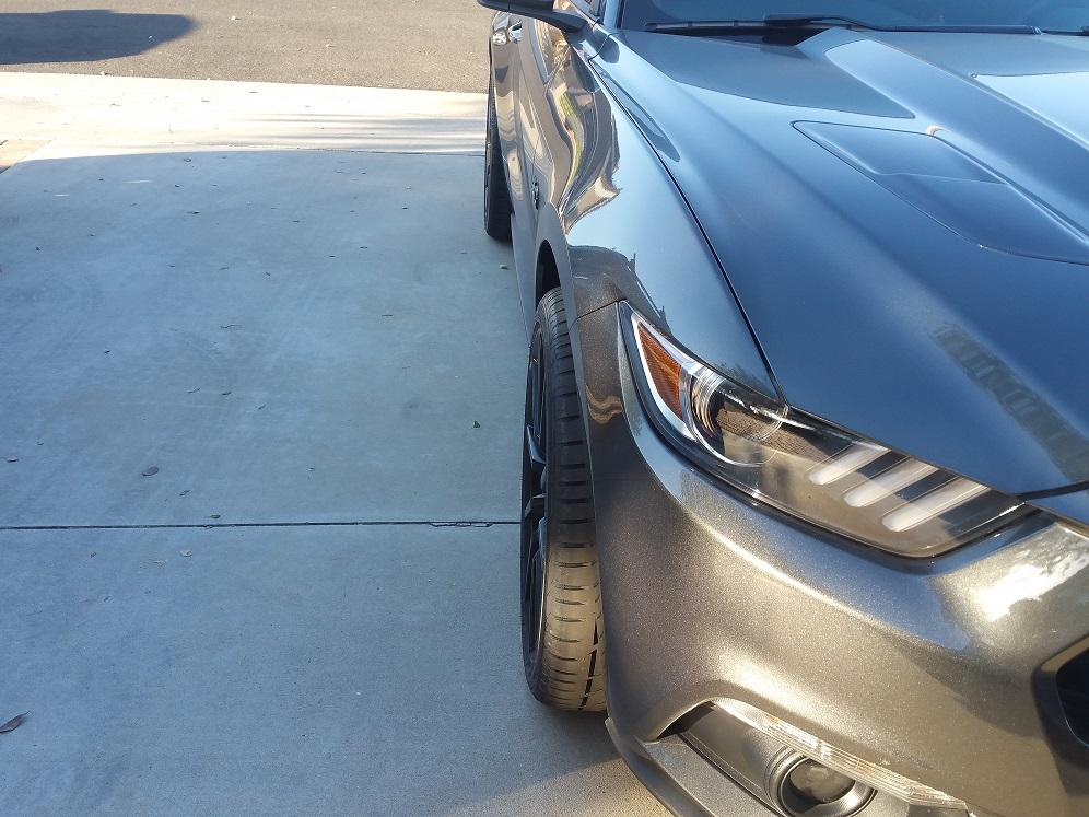

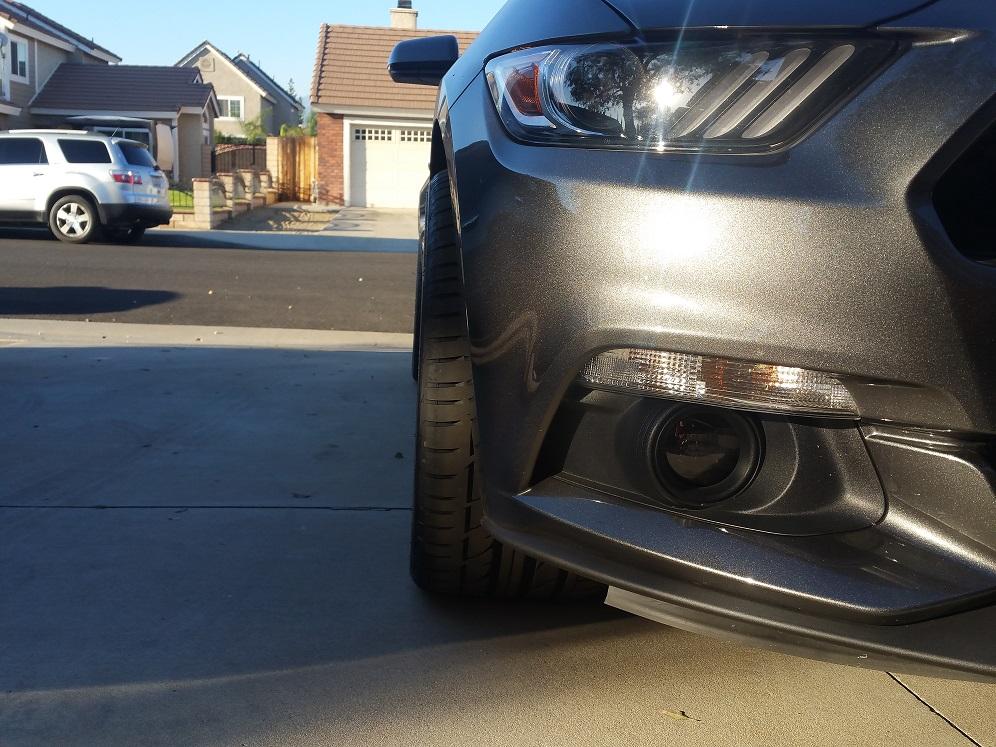

Hey Bro,
I do not have any rubbing or fitment issues but keep in mind, I have the full Ford Performance Track Package Suspension Setup ( I don't know if they still sell that as it was in 2016 I got that setup with the wheels).
As I have stated before, because the setup is all OEM and made for the mustang, the stance is perfect, just like a 350 I would say.
I posted a pic recently in the Photo Section for Magnetic Mustangs, you can check that out too.
So, I would say for those OEM 350 wheels, you got to have the right setup otherwise I guess there could be rubbing involved.
I am not into slammed cars or looks, I kind of like the OEM look to it and I want to be able to drive it. It is definitely lower than stock, that is for sure.
Hope this helps and if you have any more questions, let me know.
