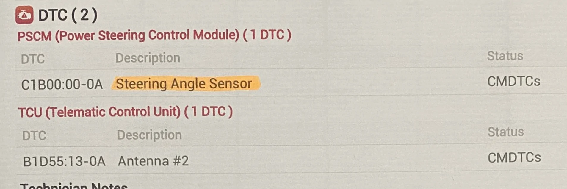

There are 2 DTC alarms that I don't know how to deal with in Mustang GT Base Model 2021.
No dashboard lights or issues while driving were observed, just using the scanner.
Scanner used: MaxiSys MS909EV V5.10
DTC reading:
1- PSCM (Power Steering Control Module):
C1B00 - Steering Angle Sensor
2- TCU (Telematic Control Unit):
B1D55 - Antenna #2
Can someone explain what are these, and how to overcome these problems, cost.
UPDATE: I cleared the DTC and everything is normal, no more codes, FOR Power steering control module, wheel alignment needs to be done (read the codes with FORSCAN, they explain why you are having the code).

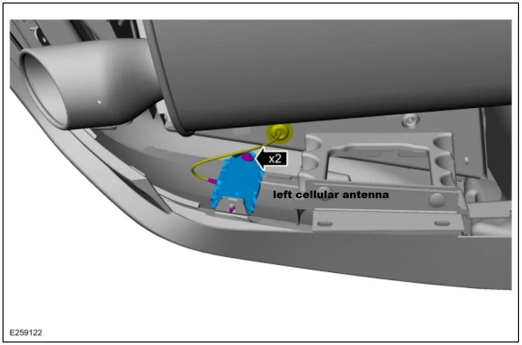

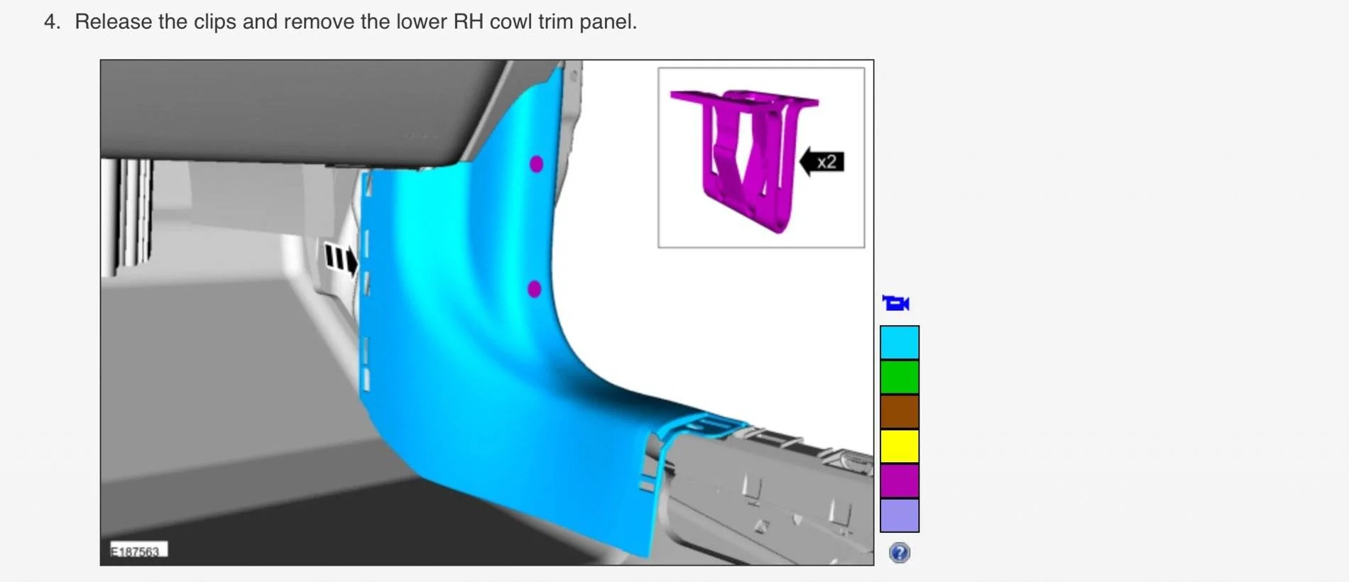

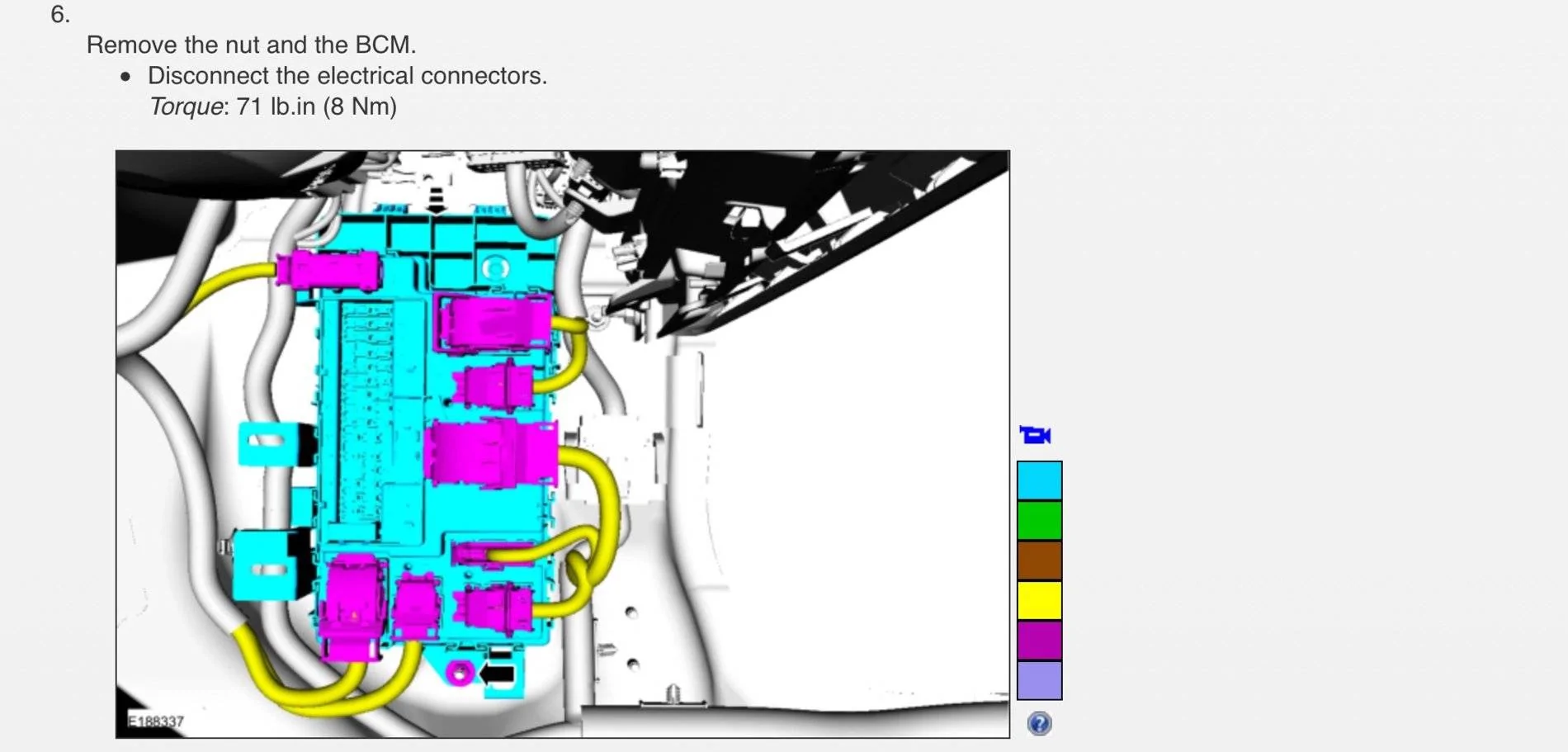

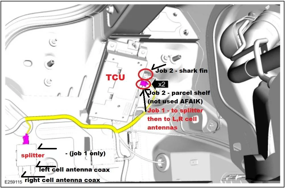

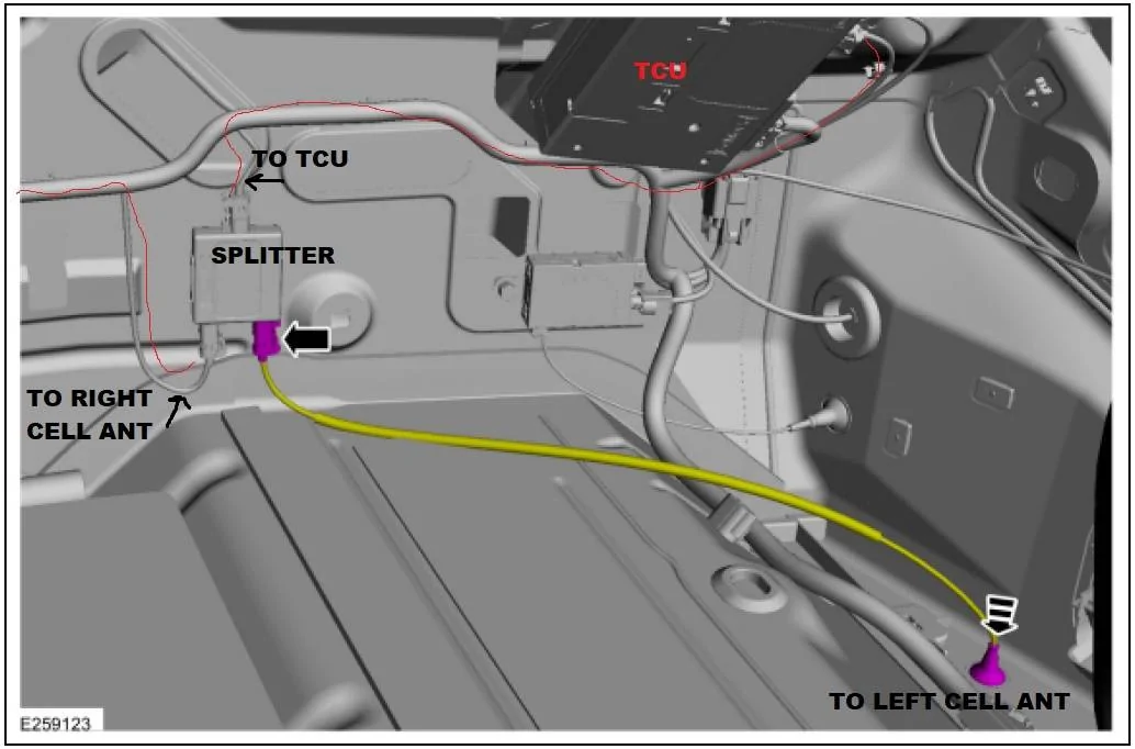

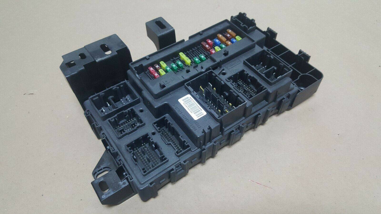

I'm enclosing some information related to item #2, the TCU.
The thread above covers the topic of the TCU and how many have elected to disable the system in its entirety.
The TCU itself is in the trunk. It is powered by and associated with fuse #8/9 within the Passenger side fuse panel, interior of the car (associated with the Body Control Module A). The Owner's manual lists the fuse position. The Passenger side fuse panel is located near where the passenger would place their right foot.
The TCU is attached to a splitter in the trunk. This splitter branches left and right, supporting left and right cell antennas. If you've used the Ford Pass App before, the TCU and these antennas are how the car talks to Ford.
I'd try pulling the fuse first, wait a bit, then re-insert, re-initializing the TCU and bits. If that does not clear the code, it's probably best to begin reviewing the physical connections, to see if anything has loosened over time. Then, consider actual antenna replacement. FWIW, you have one working antenna.
Edit: 2021. Has your warranty passed?
