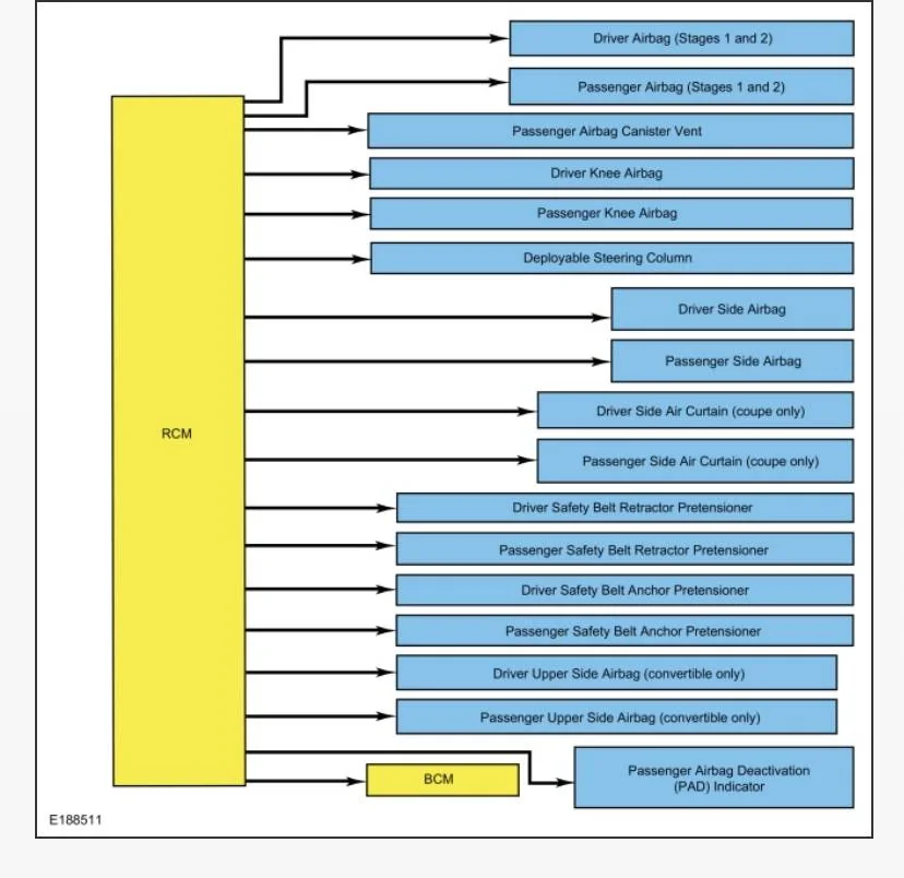

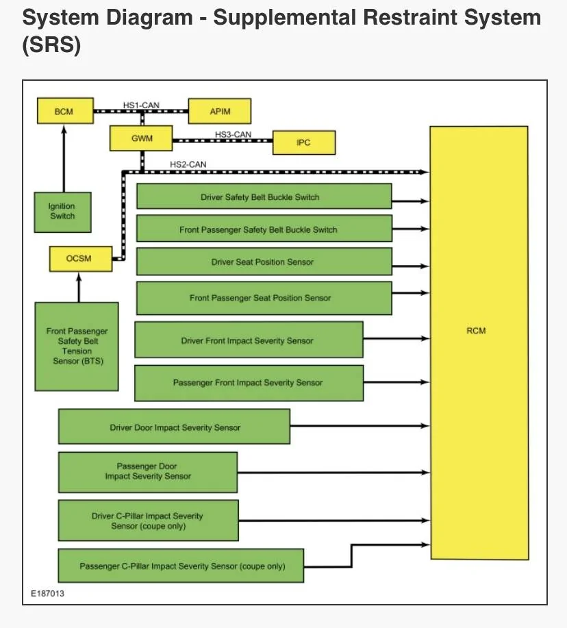

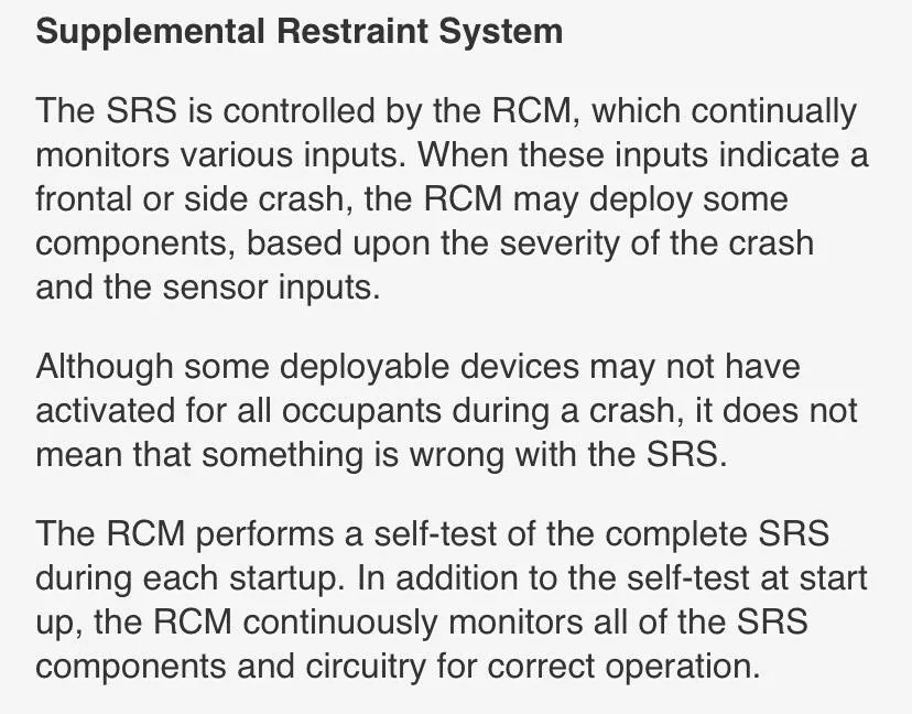

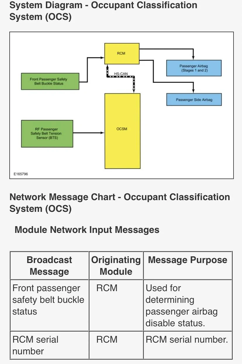

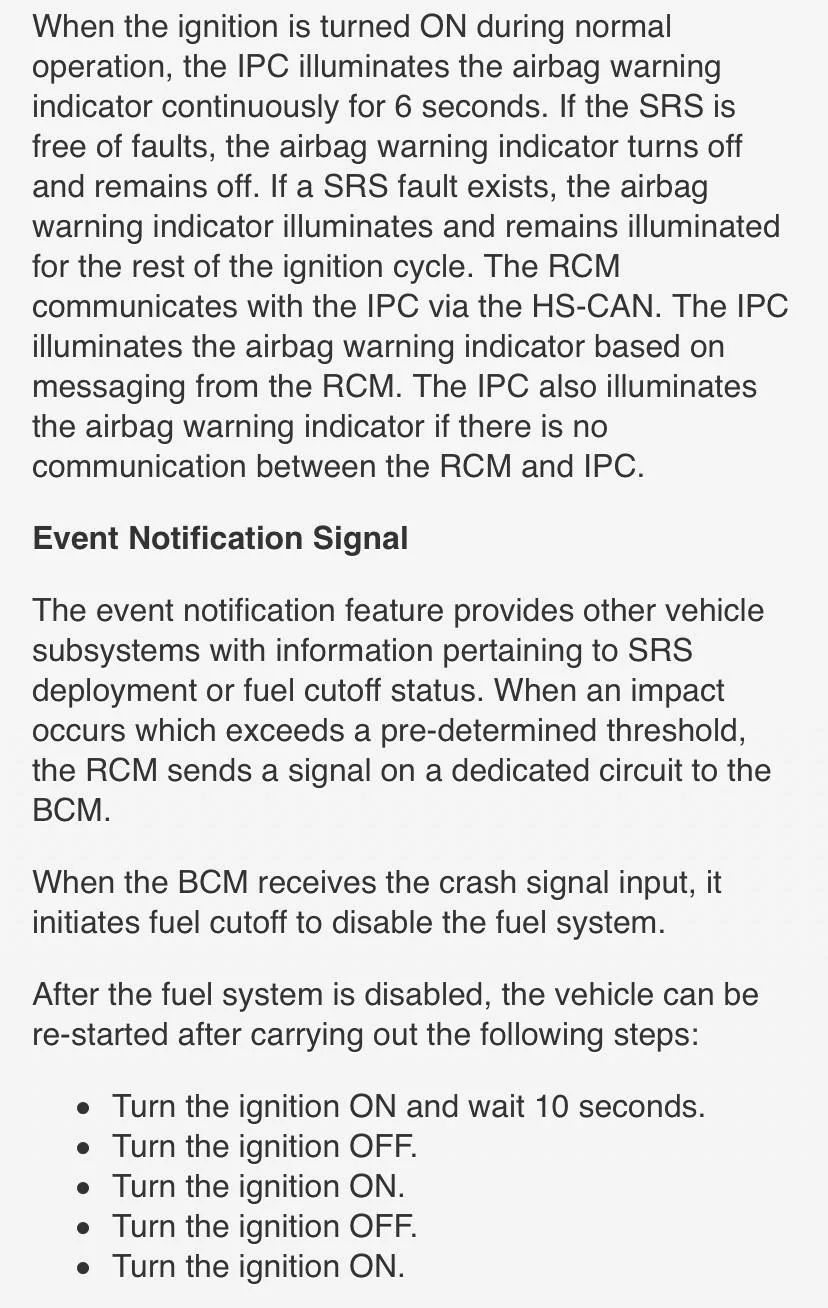

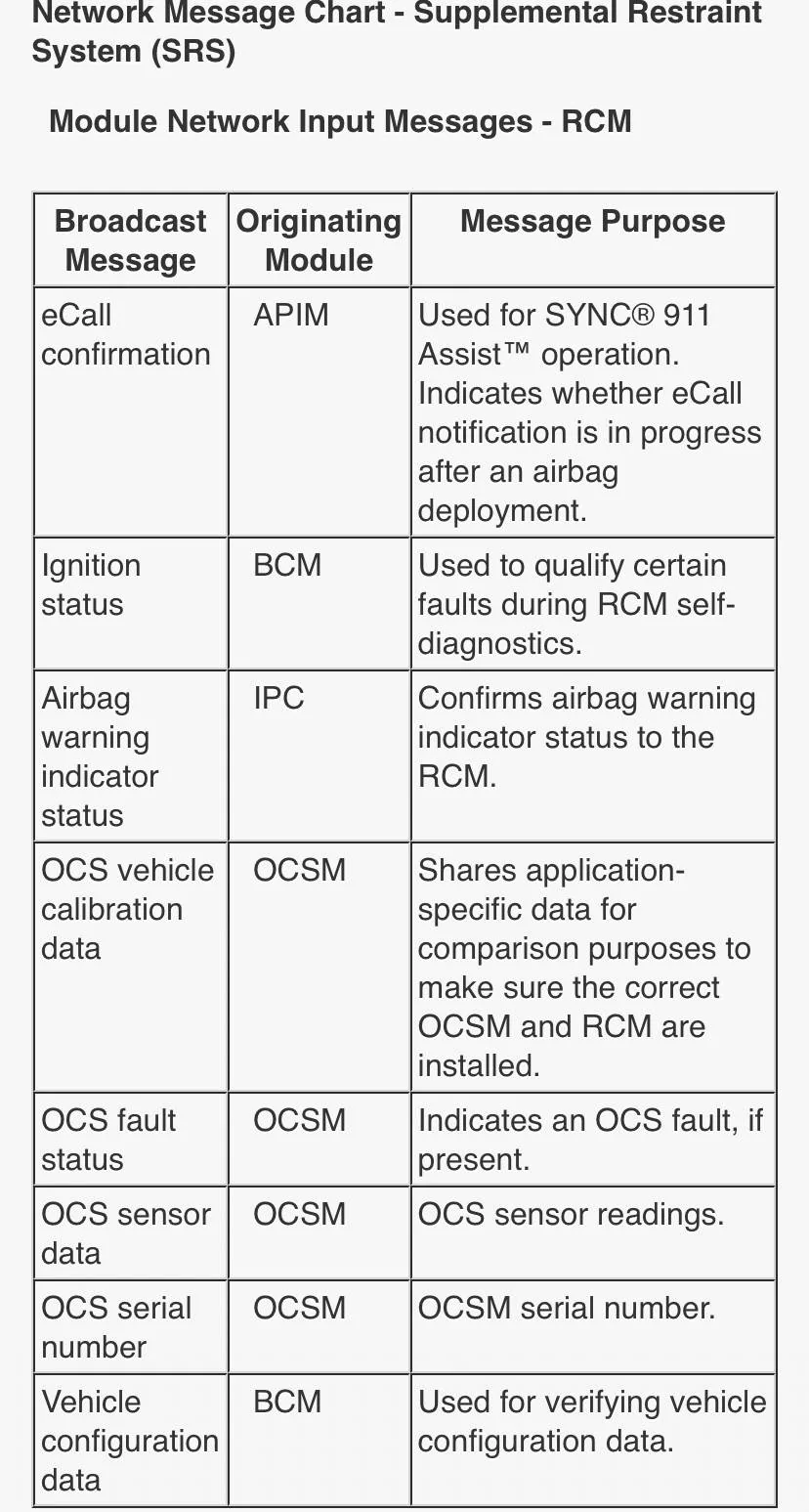

If it’s not a seat bladder or wiring issue, didn’t start or drive the car with an SRS component disconnected and need to diagnose further, this is the only airbag mapping diagnosis I have from a Ford Shop manual - I think it was 2017 S550. The airbag system has not changed drastically from 2015-current.
The S550 airbag system is very complex and any hard fault code reset needs to be performed using a proper scan tool that is equipped to reset air bag codes OR reset by a Dealership using the Ford IDS system. I'm not sure if the SRS system can be reset using the Forscan device.
