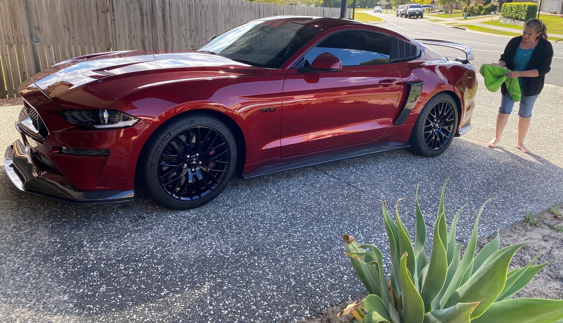

Hey all
going to store my Stang for approx 6-12months,anything special i should do to the Stang, eg take the wheels off and put car on chasis stands,should i need to put any additives in the fuel system or the engine itself.
Or do i just put a dust cover over the Stang and start the engine once a month.
As you can see my QC is just finishing off the final inspection before storage.
Appreciate all help cheer's.
