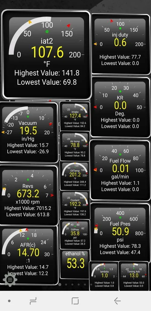

Is there an oil temp PID for the android torque app? Ive been trying to set up my torque app to show IAT2 and Oil temp but the PIDS I have tried have not worked =/
I had a great torque app setup on my 2009 cts-v :
