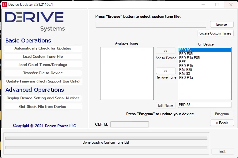

I can see the custom tunes they have on the device, but I have no idea what "R1d" stands for. I'm assuming PBD is Palm Beach Dyno, and obviously know what 93 and E85 are referring to, but I have no way of knowing if any of those tunes are epa compliant.

I'll bet all have the O2's turned off.
