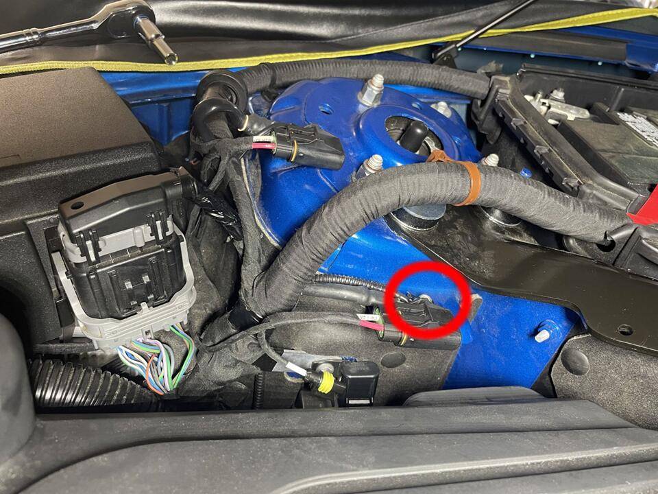

- The small harness at the air box which may also be an issue if it has become disconnected or wobbled loose will also throw an AdvanceTrac error... part is pictured in THIS thread:
https://www.mustang6g.com/forums/threads/traction-control-fuse.109035/

The only time I had this issue, was because I mounted a catch-can on the passenger side where the ground cable is. It was loose and caused all the faults you listed and the steering wheel was basically unusable. Once I tightened everything up, it resolved and never had the issue again. Don't ask me why that causes that, but check the cable, and maybe it'll be a simple fix. 👍
Just wanted to say thank you for sharing! I was about to fall down a troubleshooting rabbit hole.
Steering assist, advanced trac, and drive mode faults popped up after I replaced the knock sensor harness (mouse chewed it) and installed adjustable motor mounts.
I can confirm that poor grounding at this point will cause these faults. Thanks again!
