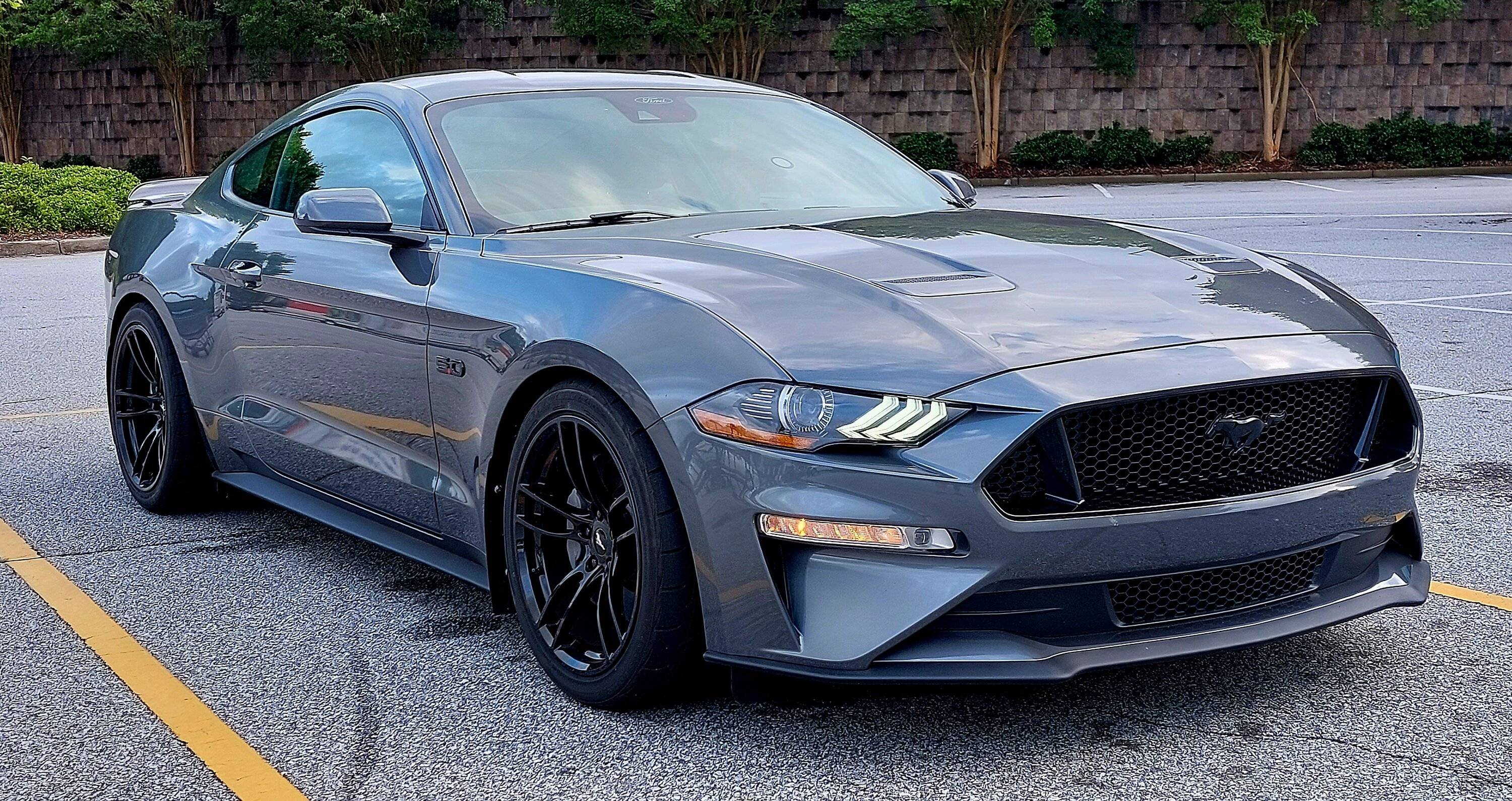

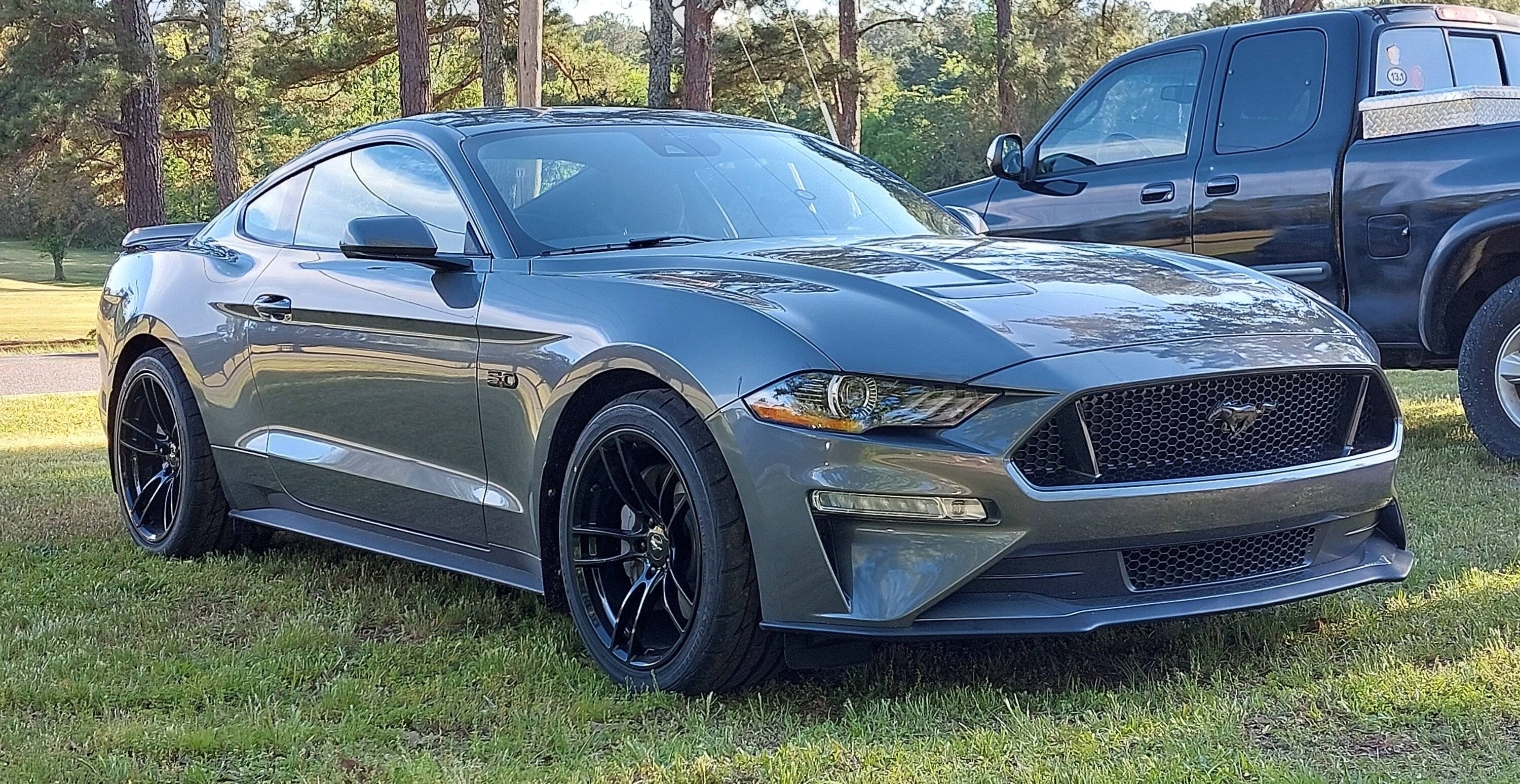

I just installed Bilstein B6 shocks and struts along with Steeda Ultralite Linear springs (F 200 R 800 lb/in) last weekend and got an alignment yesterday. She drives and handles exceptionally well now. Highly recommend this combo. Very confidence inspiring.
Since I was already lowering the IRS cradle/subframe to install the rear springs, I also installed the below parts to stabilize the IRS and put power down more smoothly and consistently:
- BMR CB005 IRS cradle brace and bushing lockout kit.
- BMR CB766 IRS cradle alignment bushings.
- UPR Differential Bushing Inserts (red versions which are softer than the black - opposite of Steeda's).
- Differential Bushing Bolt Sleeves (from user GTP here on M6G).
She is now very planted and well behaved. No more odd squirming out back. Might consider swaybars next and maybe RLCA bearings.
Here are some before and after photos. I believe it's settled in a touch more since the bottom pic was taken. That was before the alignment and putting another 40 or so miles on it.
