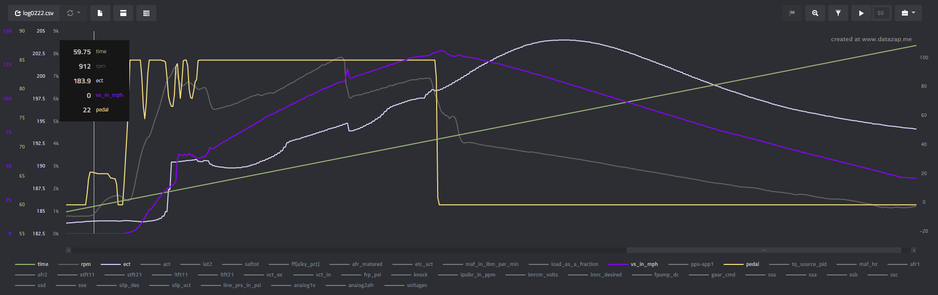

Im attaching a picture to show how well the base radiator with a transmission cooler, AC condenser, and heat exchanger w/ entire stock grill in front of it works at 95* in 85% humidity. Basically WOT at 16-17 PSI using high octane gasoline for 10.5 seconds. 0-145+ MPH at the start its at 185*, Where I let off its at 197*, it peaks at 204*, and 10 seconds later returning down to 40 mph, after letting off its already back down to 194*. On the stock thermostat it would do the same thing, just 20* higher every where. Rate of temperature change wouldn't change. With higher starting temps because of stock fan settings it would negate the purpose, unless you had a decent part of a run that allowed the lower temps that the stock Tstat wouldn't get to. I have done a SCCA events in 90* high humidity using 12-13 psi, and in 45-50 second runs, tight turns low speeds, starting temps at 185*, my peak ETC temp was also only 205* briefly. Could a larger radiator and more openings for airflow to it keep the temps even lower by reducing the rate the temperature rises? Sure, but the base cooling system does very well even with being choked and under extreme conditions relative to what it was designed for. A lower temperature thermostat may not improve the capacity of the cooling system, but it doesn't limit heat being removed until a lower temperature, and thats the entire point of using one. The two thing to keep in mind are the coolant flow between heat source and radiator/exchanger and the airflow over the radiator/ exchanger. You need both, more flow rate of water inside and air outside and more heat will be removed resulting in lower temperatures.

That is a great post, Mark. It would be really cool to see a similar log of IAT2 with the two different thermostats. No doubt lower water temp would make some difference, just not sure how much or whether it matters enough to deal with the downside of a low temp thermostat for street driving. It's clear from the discussion that full throttle at 12+ pounds of boost makes more waste heat than the cooling system was designed to handle. The advice is still good: Keep the stock thermostat if most driving is on the street. The downside is bigger than the upside. It might be a benefit to change it out for track day. That wasn't a good option for a Terminator. Changing those things was a royal PITA. Haven't had to do that on a Coyote yet.
95 degrees, 80% RH - Houston in July. I don't miss it for a second.....lol
