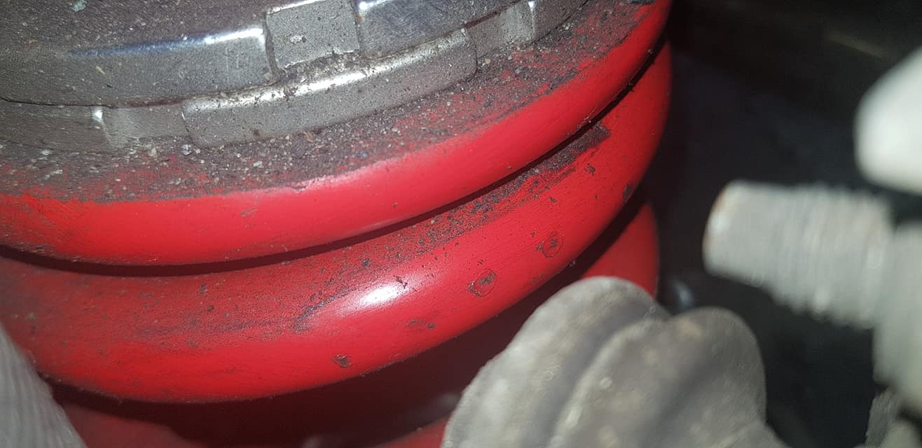

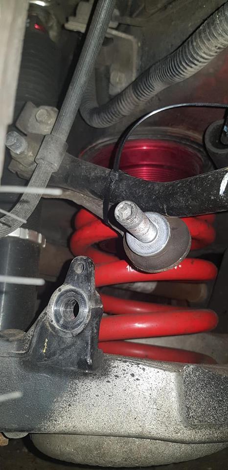

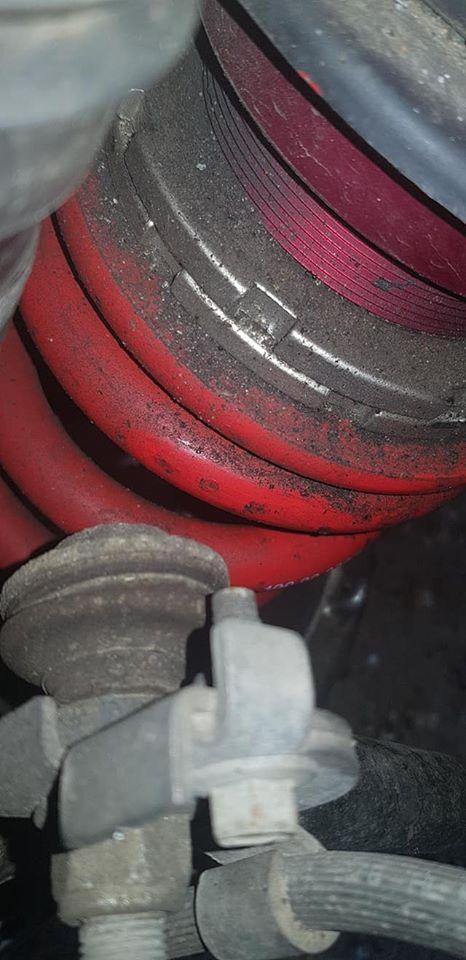

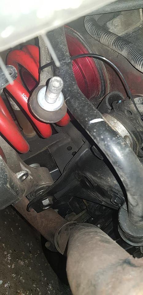

Following from thinking it maybe the sway bar bracket hitting the exhaust, the clunks still occurred.
Gibbo had advised me that it maybe the sway bar end links. I've just unbolted the lower link and cable tied it to the sway bar. Noticing that the upper link has move into the spring and caused dents on the spring
Believing this was probably cause of my clunks, i put my wheel back on and set off down the road to test (I ran my lane 6 times)
However after the drive it was apparent the clunks were still there.
4 dents on the second top coil, 3 close together one a smidge further away. Not sure what could have caused this other than the end link smashing into the spring?
And how i drove with the end link (lower bolt) disconnected.

Wouldn't surprise me if it that's the cause. The stock items are made of cheese so the fact you're running coilovers is only going to exacerbate any issues yours may be having...
Check out the difference: https://www.bmrsuspension.com/?page=products&productid=1502
That pic doesn't even do them justice. You can almost bend the stock ones by hand they're that weedy.
its possible under deflection the top of the link has touched the spring but there's only 4-5 marks so its hardly being a common occurrence isn't it it could even be those marks are results of stones not saying its not the cause just unlikely.
without having a good poke around under there i'm kinda out of idea's have you got a couple of go pro's get them strapped under and look for something.
It could on an outside chance be an LCA bearing binding with it being lowered but i've never heard of them making a loud enough noise to notice.
