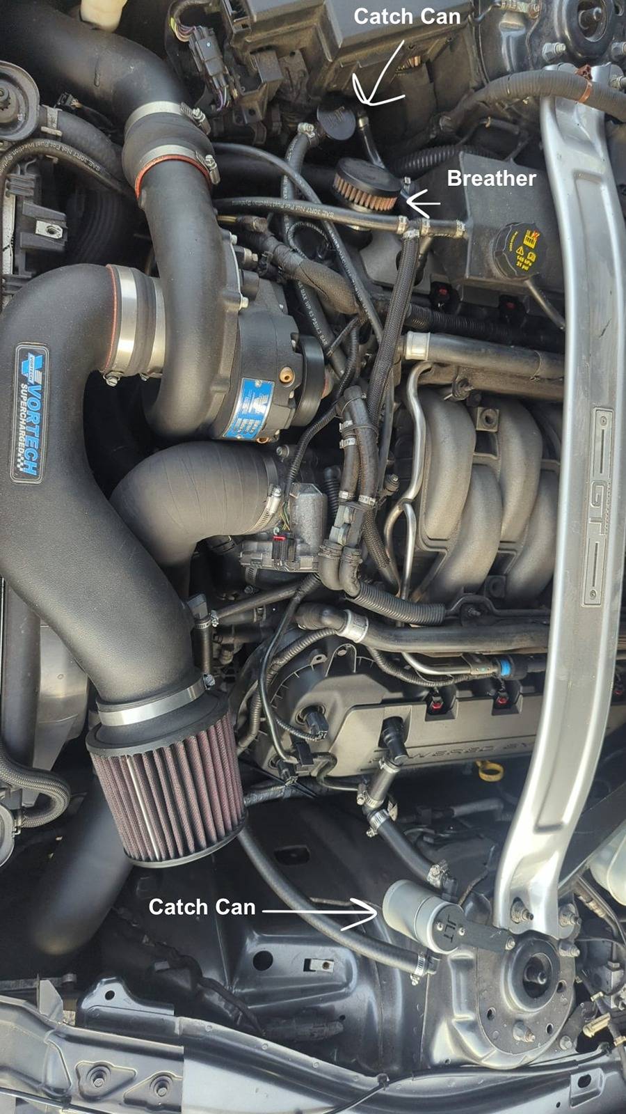

Is the breather on your intake post maf?
nahmed405
Mar 23, 2024
ny
kev
2016 Mustang GT Manual Vortech supercharger
Here is a picture of the set up though there was no difference in idle pre and post breather/catch can install.

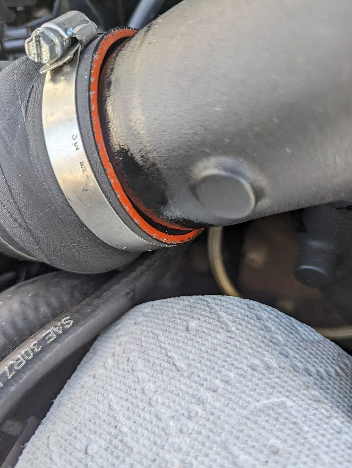

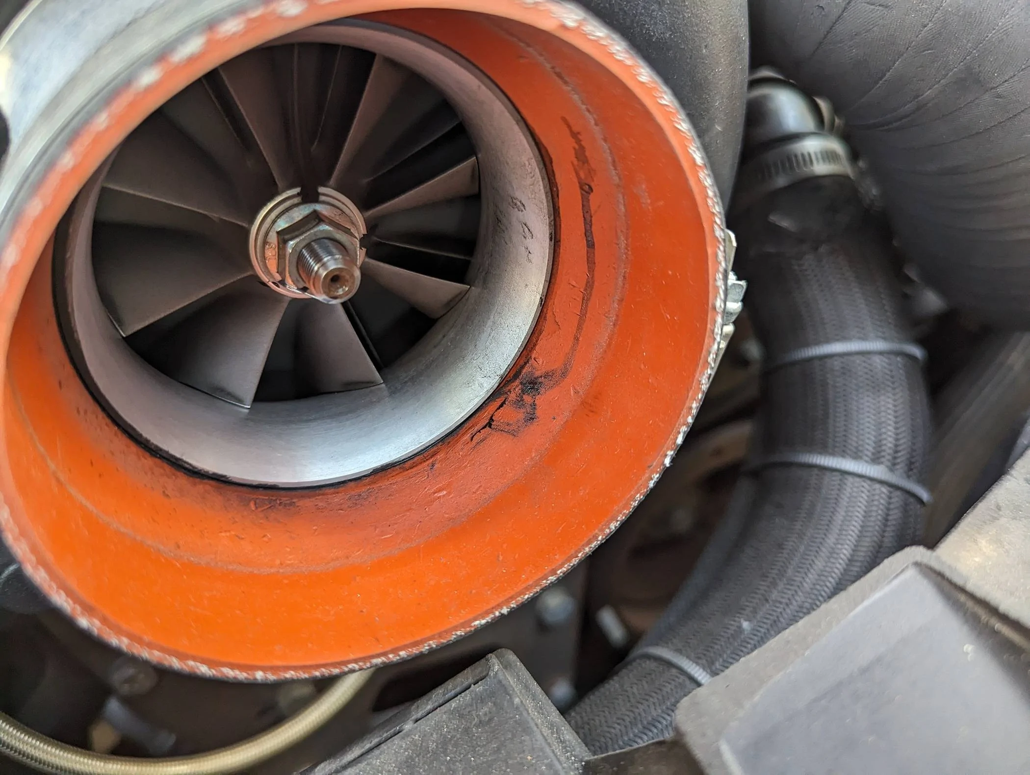

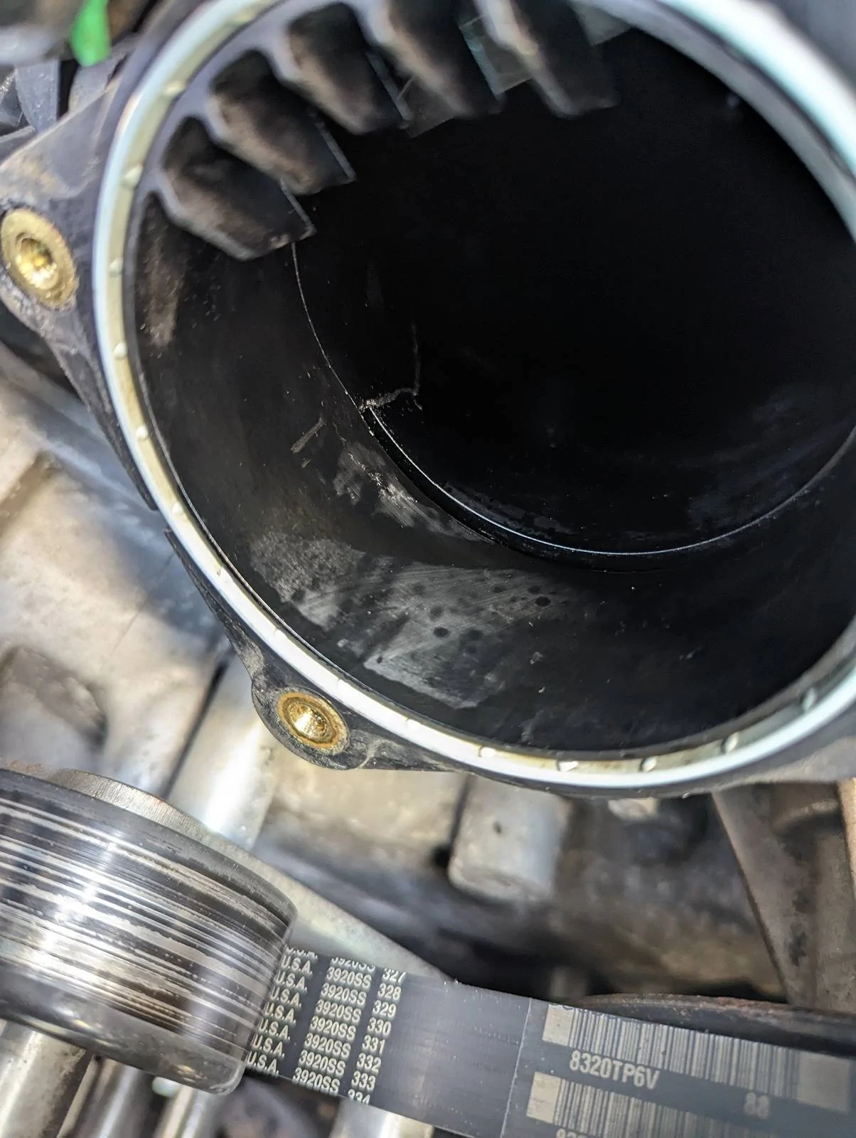

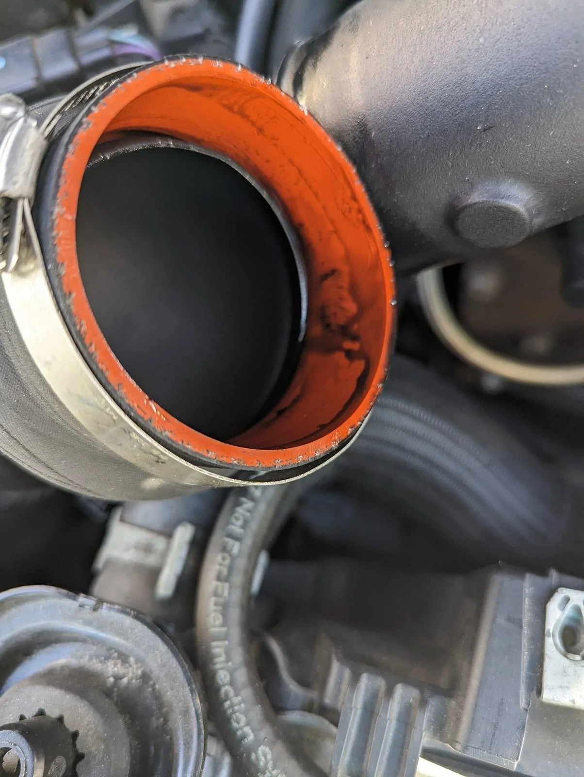

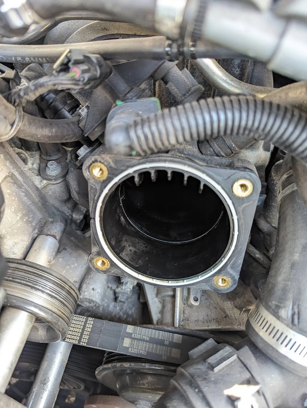

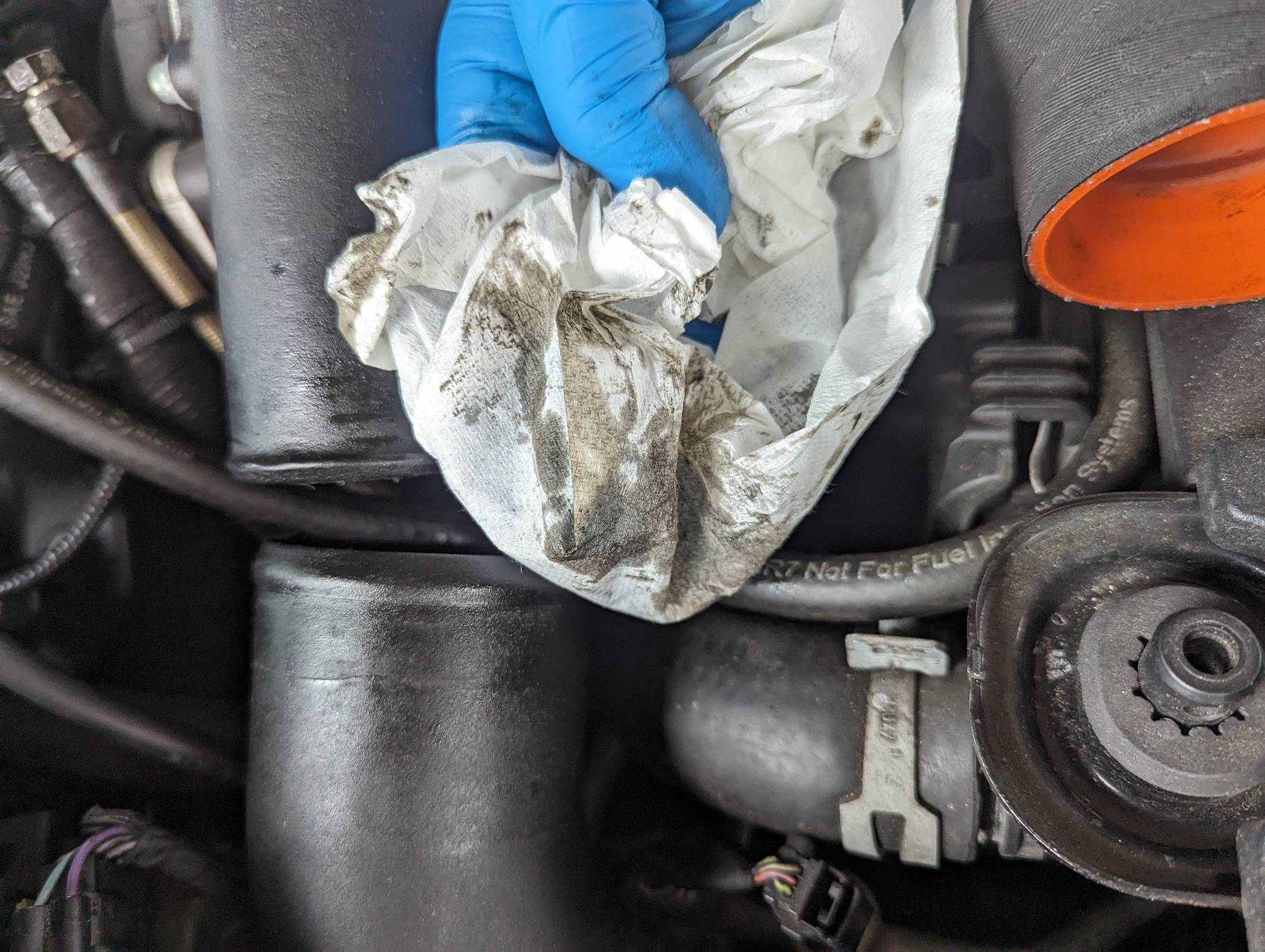

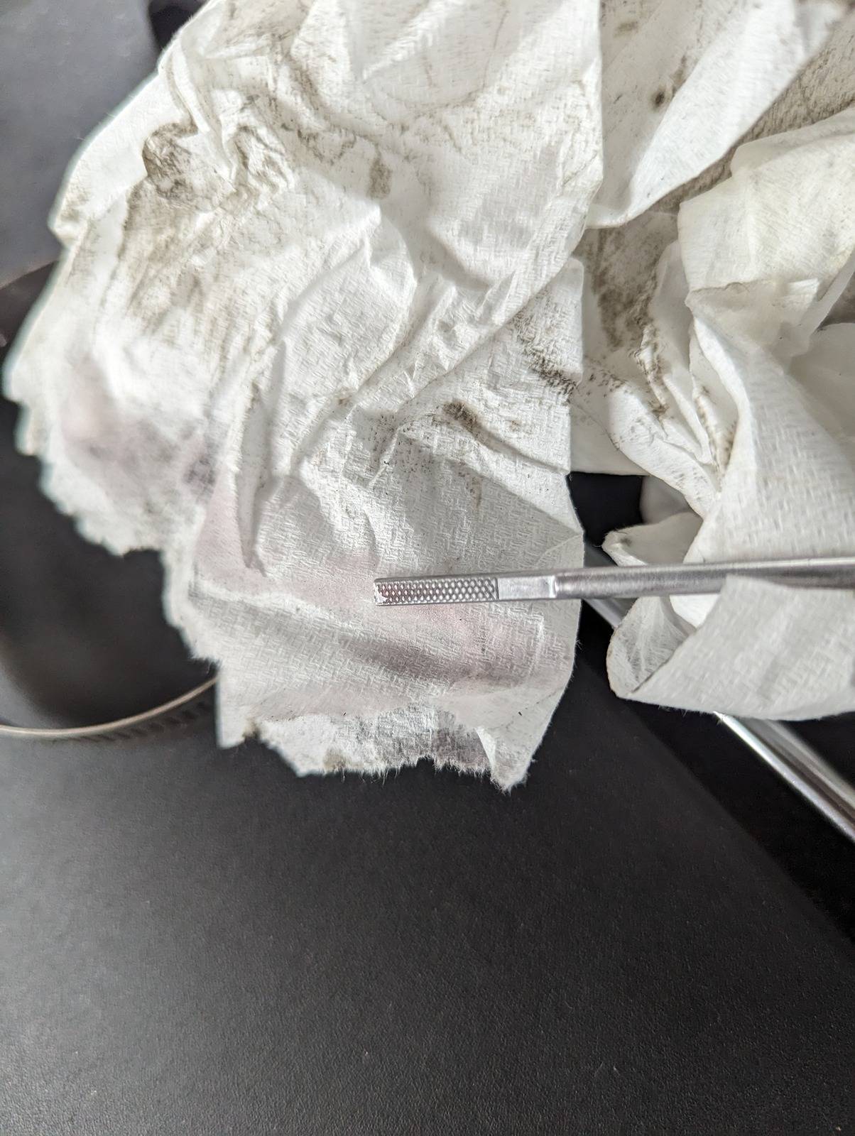

Just changed the throttle body and the ignition coils (did a KAM reset as well afterwards) and no improvement. HOWEVER, I did find a ton of oil in the intake and behind the throttle body, and a lot on the outlet of the supercharger. I literally just changed the oil 350 miles ago for both the engine (gold color oil) and the supercharger (red color oil) but the oil I found was gray. I am not sure if this is the engine leaking, the supercharger leaking or the evap system is off somehow (IDK much about this sys) but this is where I am at now. Any suggestions?

That looks like supercharger oil. Does the MAF got oil on it?
nahmed405
Mar 23, 2024
ny
kev
This is the oil from the supercharger on the dipstick and the other one photo. The maf sensor tune was dry and I'm suspecting because the oil had to come from the outlet of the supercharger all through the other pipes and intercooler.

I ended up isolating the oil leak to be from the supercharger. The supercharger is off of the car now and is going to be sent back to be repaired. In the meantime, I have the serpentine belt bypassing the supercharger, and the car is basically stock now. HOWEVER, I still have the same idle issue, which means I can rule out the supercharger from being the cause. This is the first time I've heard the engine run without the supercharger, and I noticed it have a loud ticking noise from the engine, but I don't know if that's normal or not. I was looking into some forums and people were saying that it might be a dirty fuel injector or my cam phasers(I changed out the VVT solenoids, but not the phasers). Does anybody have a thread that they can link about cam phasers, dirty, fuel injectors, or engine tick? If anyone has a video of how a car might run with a bad phaser or dirty fuel injector that might help me rule some possibilities out as well.
