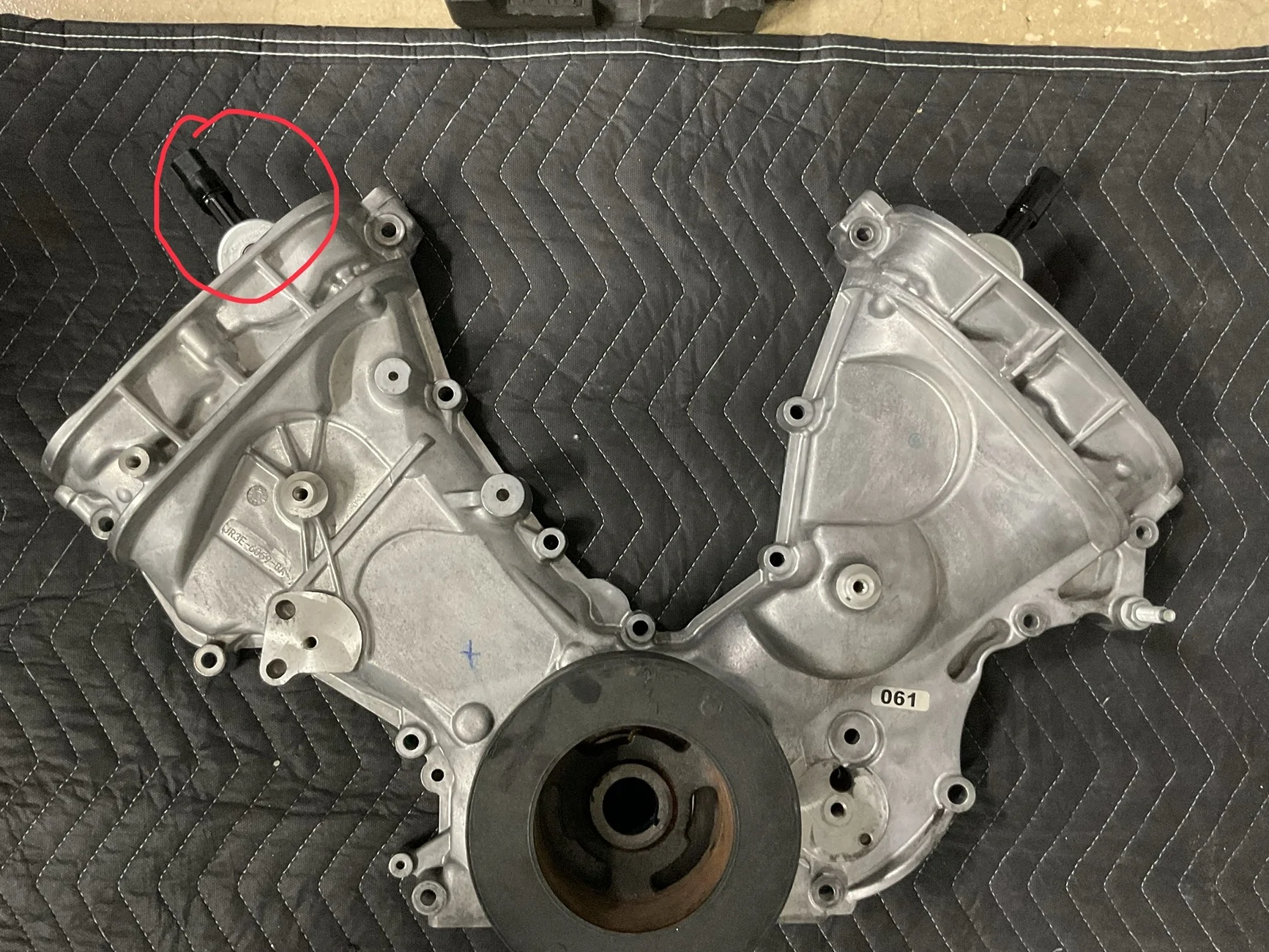

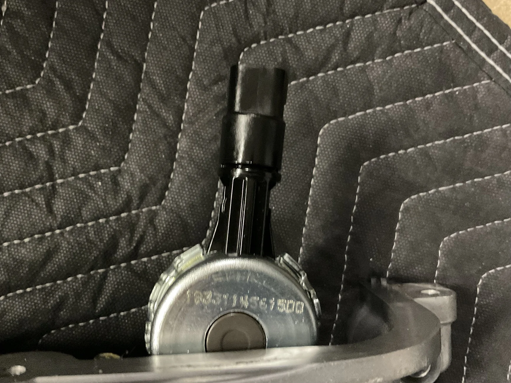

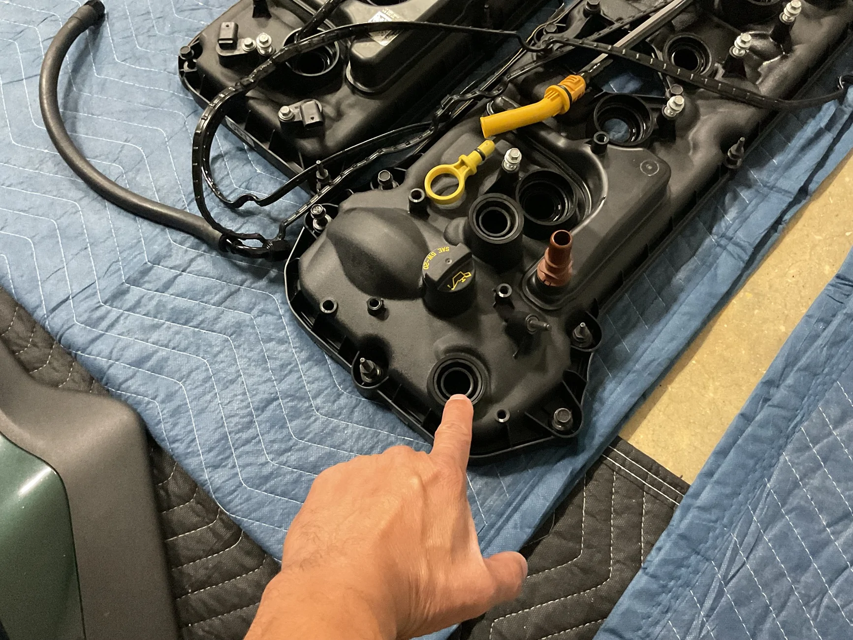

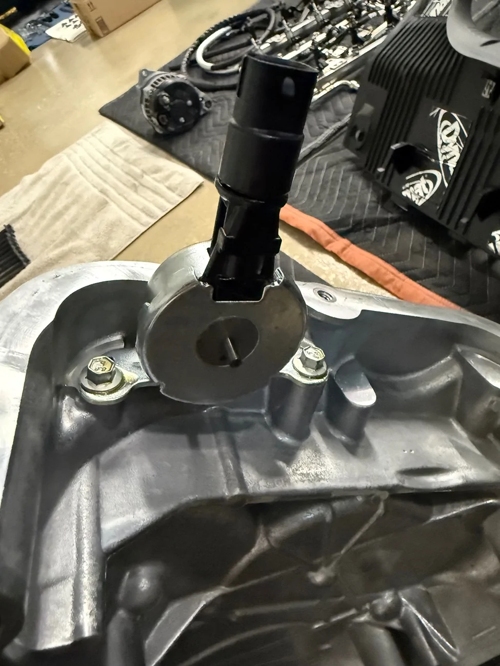

My 2019 Bullitt has made that same noise for ever. I performed a quick test to see if it was the VCT solenoid on the passenger side by unplugging it. When I unplugged it, the noise stopped and as soon as I plugged it back up, the noise reappeared.
Here is a pic of the sensor and the passthrough grommet in the passenger side valve cover where the electrical connector plugs into. My engine is apart now undergoing upgrades and I will be replacing both VCTs for peace of mind moving forward.
Thank you very much for this! I have not thought about this and from your explanation, I might have the exact same thing. Mine is more audible from the passenger side as well!!!!!
I will unplug and check ASAP.
How many miles did you drive yours before discovering the issue? Also Did you encounter any issues aside from the noise before you decided to work on it?

I noticed it very early on (maybe a year or so into ownership). I never had any codes appear either. I just lived with it with no issues other than hearing the chirping. It was annoying at first, but I tuned it out and just enjoyed the car (lots of 1/4 mile drag stop hits) and it still ran great.
I only took the car apart to upgrade valve springs and oil pump gears for the turbo install.
I had always told myself I would address the chirp if I ever pulled a valve cover for some reason. The part is cheap and easy to replace, given that it is up top and mounted via two bolts.
