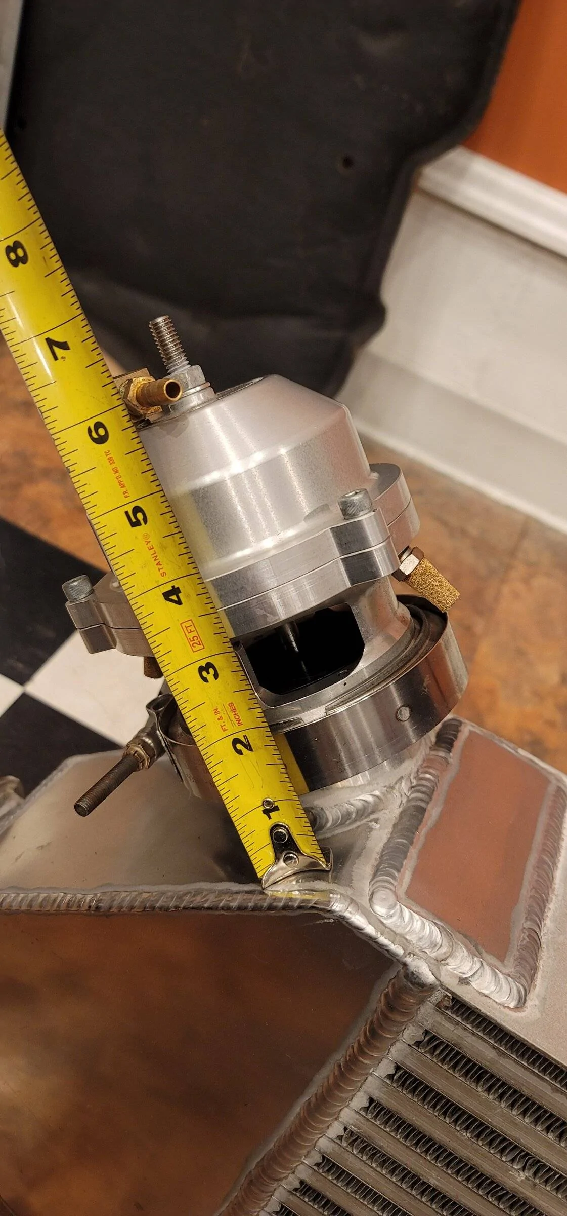

Bv57 is freaking huge, make sure you have the room. Procharger red race is more compact.
