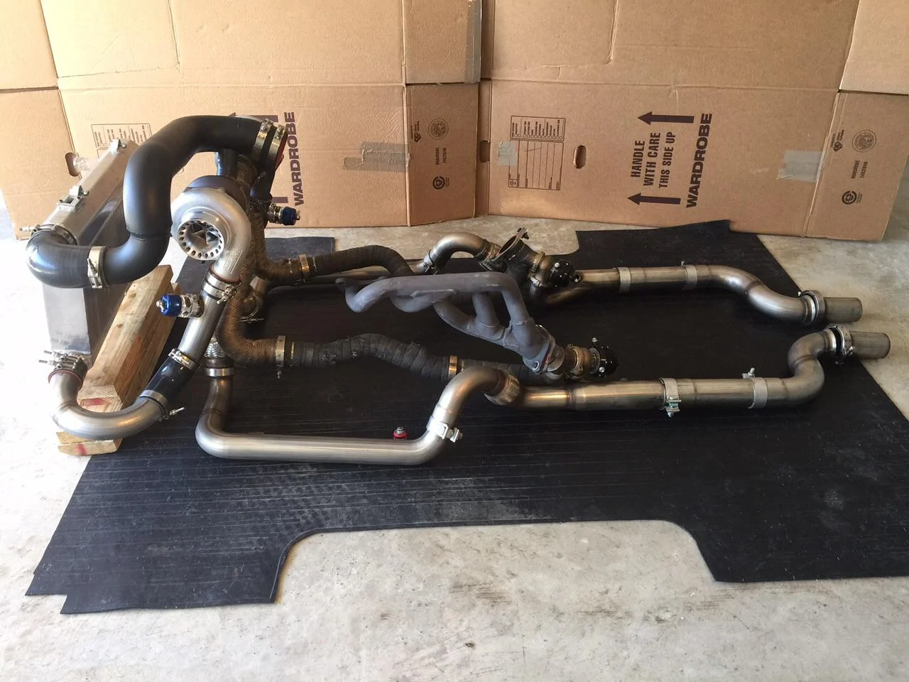

We actually Vband clamped my exhaust so there is no necking down what so ever.

This might give you a good idea. I cut my factory connect off my Catback and welded it to the vband connection pipe.
