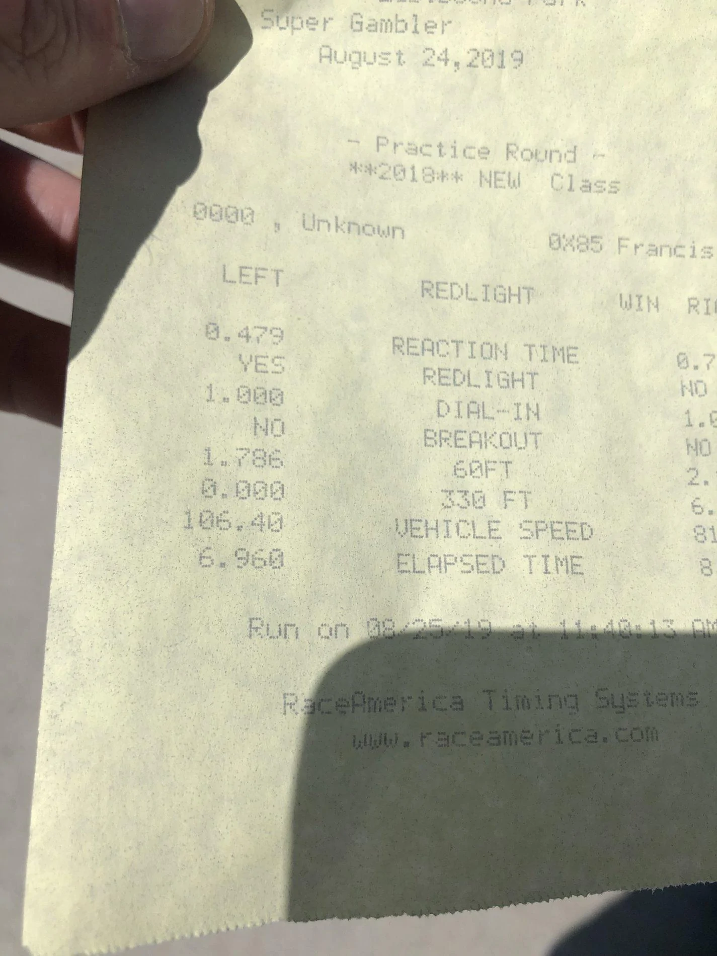

Btw, I ran a 6.9 @ 106 with a 1.7 60’ on 91 + booster. This is my DD setup. Driven to and from the track. 4100 lb + race weight with my kids booster seats in the back. First time racing the car as well. Very impressive setup!
I just currently switched to C85 and I’m gonna start throwing some proper power at it.

Awesome!!! Glad we could be a part of the project!!!!!

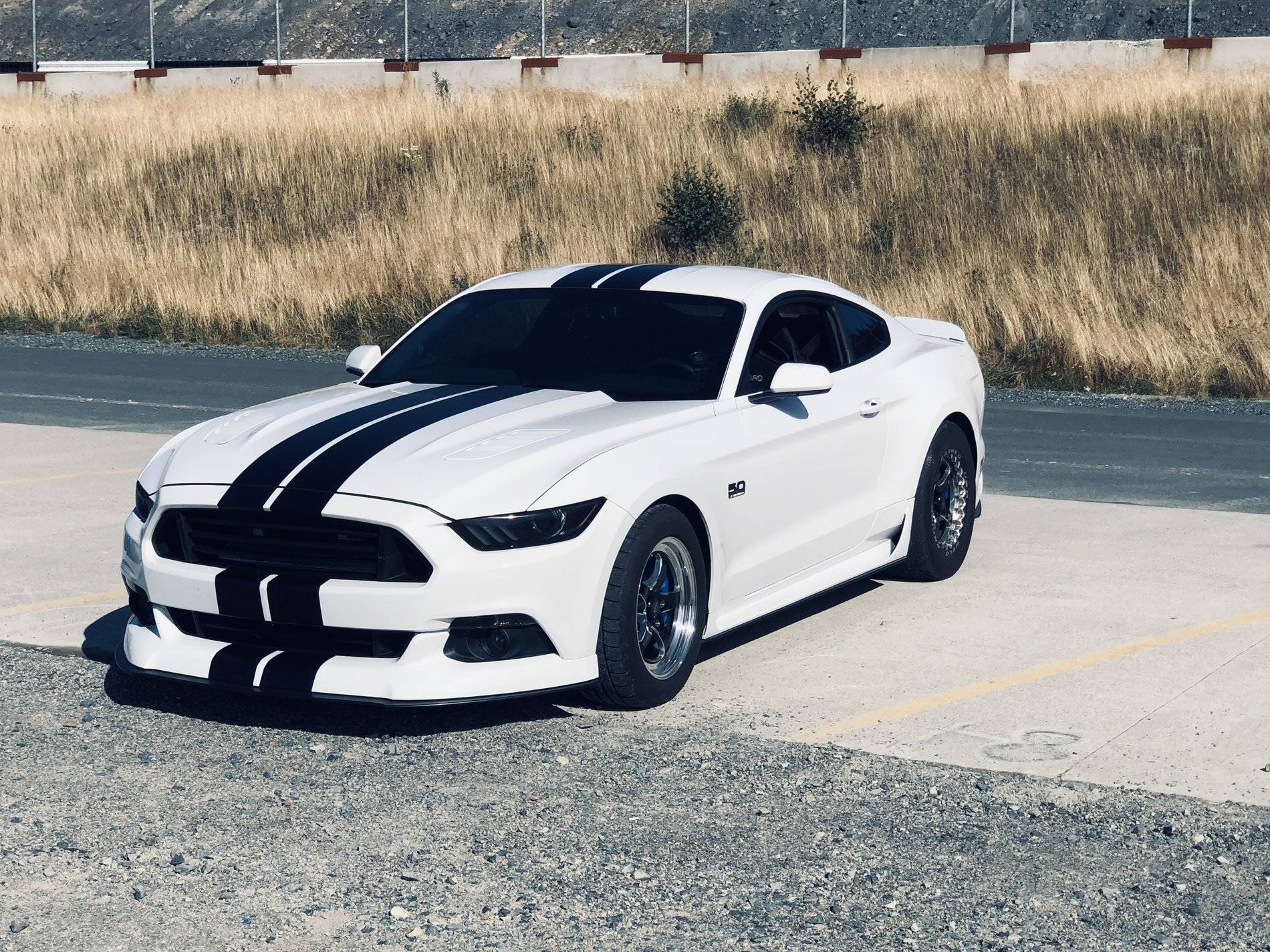

Looks like ALLKHEINZ's old car. Very nice and good luck!

Yes. You are correct. I’ve done a quite a few upgrades since I bough it, but power plant and drivetrain remains the same. I’m happy where the car is at now. I’ll be running E85 and some proper boost this summer. Time for this car to hurt some feelings.

That is a bad bitch. I remember the build a few years back. Awesome!
