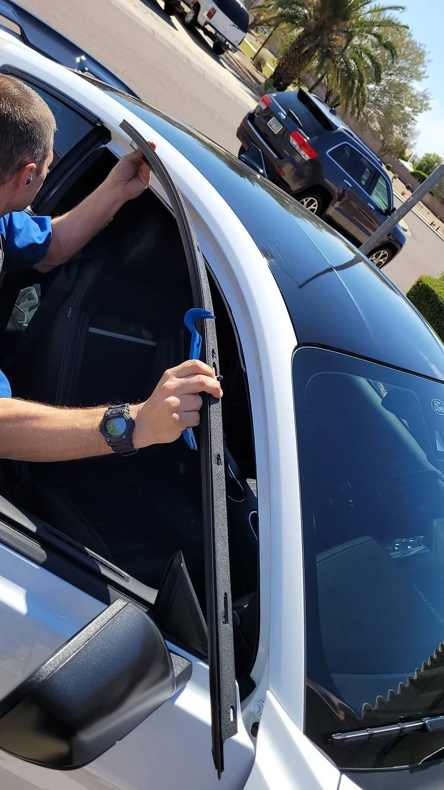

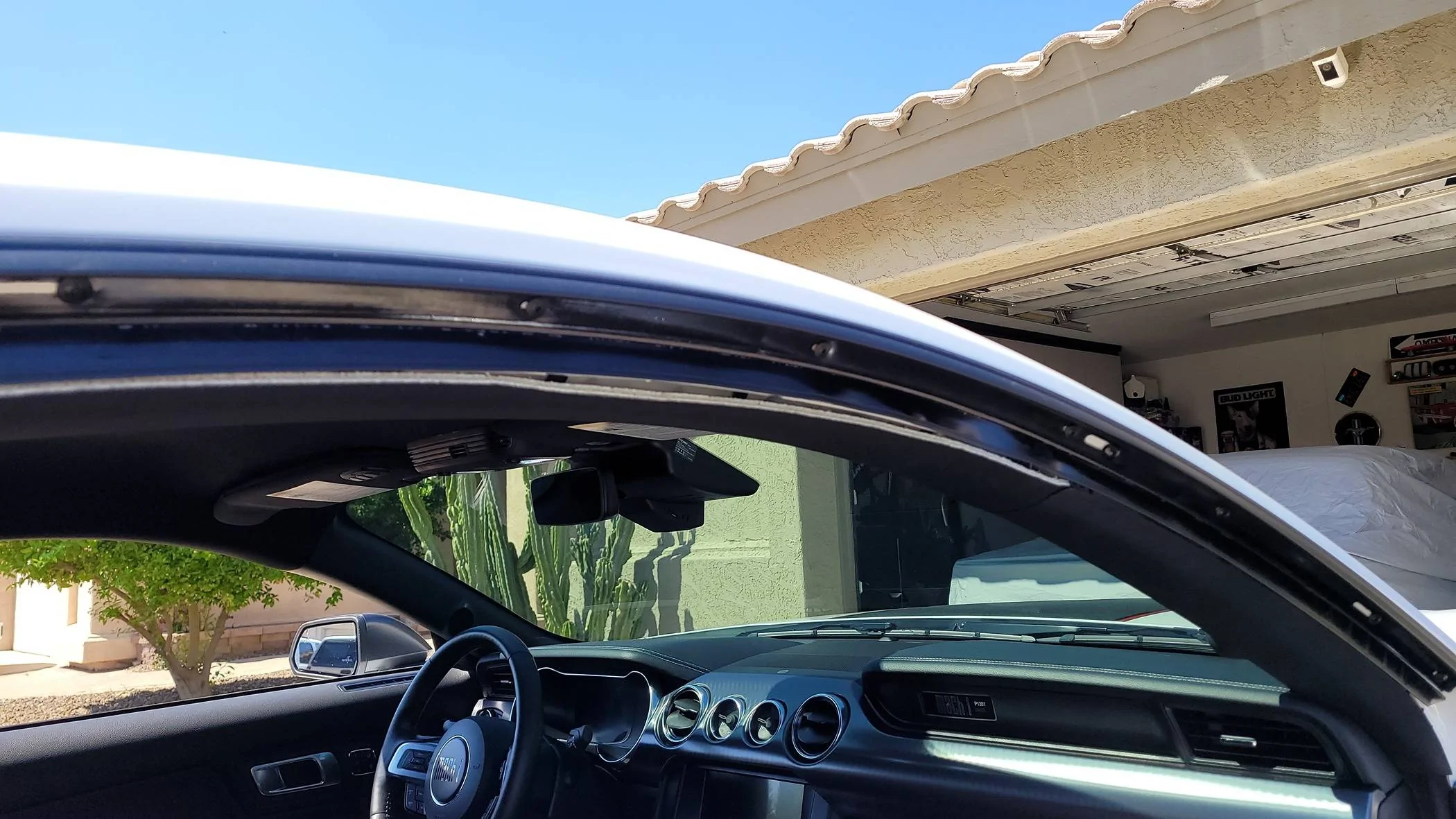

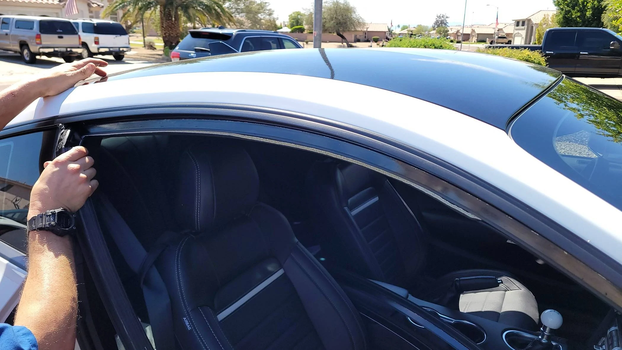

Just a quick update with pictures.
I unsuccessfully tried numerous times to get the headliner to stay using a mallet and tapping the seal into place.
So today a mobile tech came to my house and did the TSB. It only took him 45 min to replace both sides. The issue is the metal bracket BEHIND the rubber window seal (see 2nd and 3rd pics). I didn't realize they were two separate pieces. Hopefully this fixes the issue.
