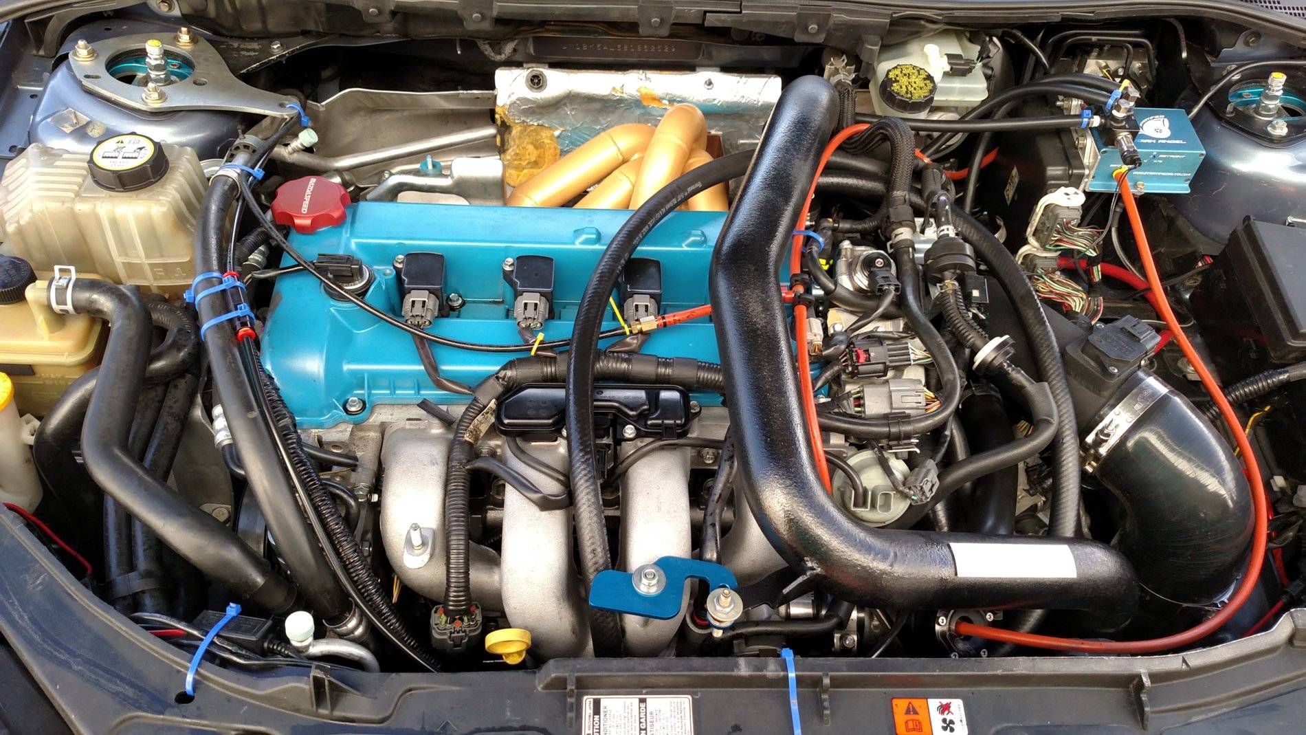

See post #10, I got Gold.
SheepDog
Nov 3, 2018
4,194
5,259
Colorado
Dax
Iconic Silver 2022 MACH 1 HP, 2023 F150 Powerboost
Those look awesome!
Thanks. Iv'e done this on several vehicles, including my Speed3 manifold that had a GTX3071 on it. Even with al
l the heat of the turbo, it holds up perfectly. No peeling, no cracking, just winning
