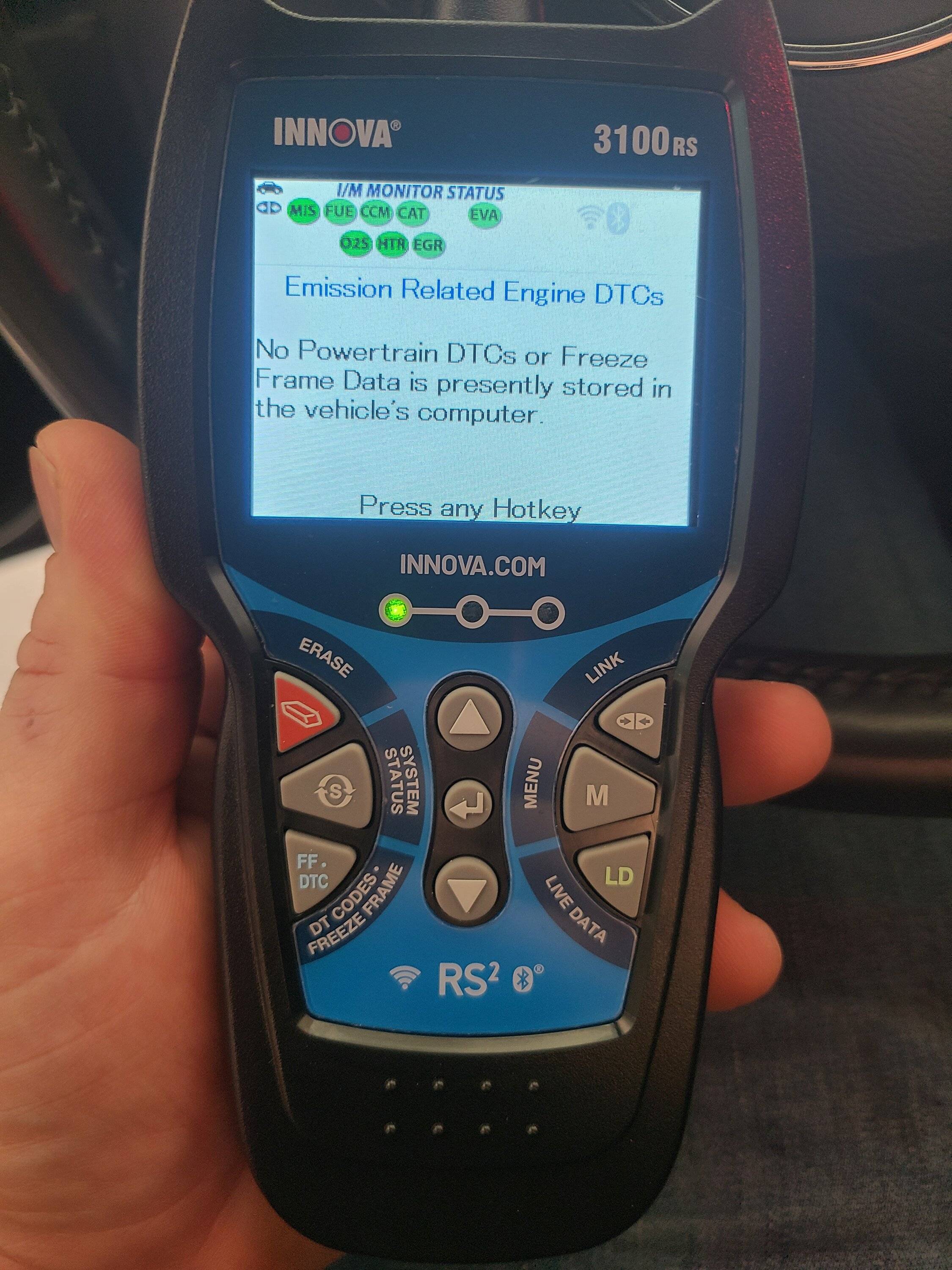

They are low mount turbos so they sit where the factory cats were. I'm tuned by Lund so no they absolutely won't disable the light since their epa issues. Plus I've verified all my emission monitors go green. Not sure why and who knows if others are having the same luck with the sleeper kit. (I was mostly kidding with my original comment) I was planning to install the defoulers when it threw a cel but that never happened. Over a year and a half and 30k miles boosted with no issues.
Damn I guess don't look a gift horse in the mouth lol, that's really cool you got off easy like that. Must just be that the combination of all your mods worked out right
