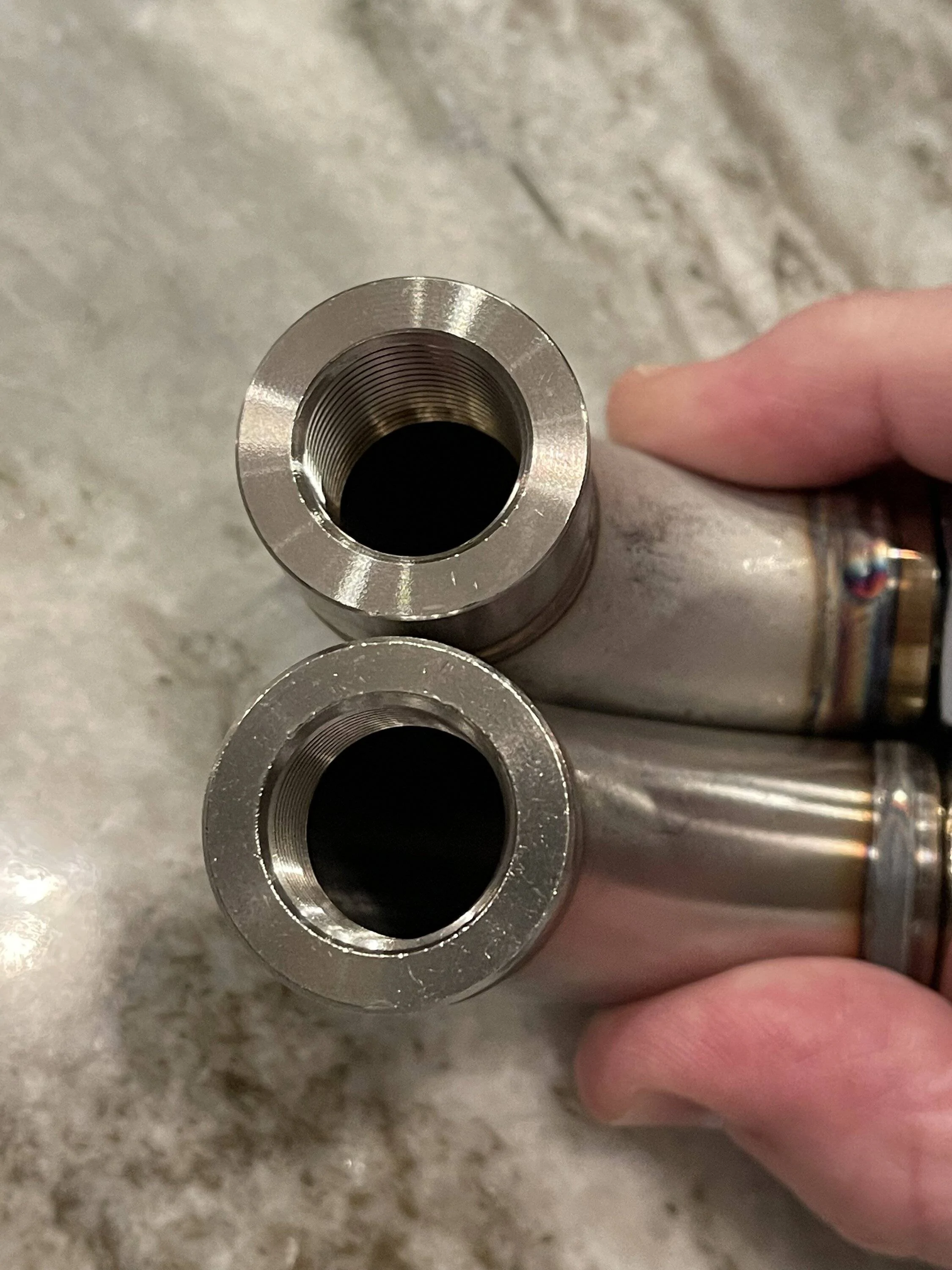

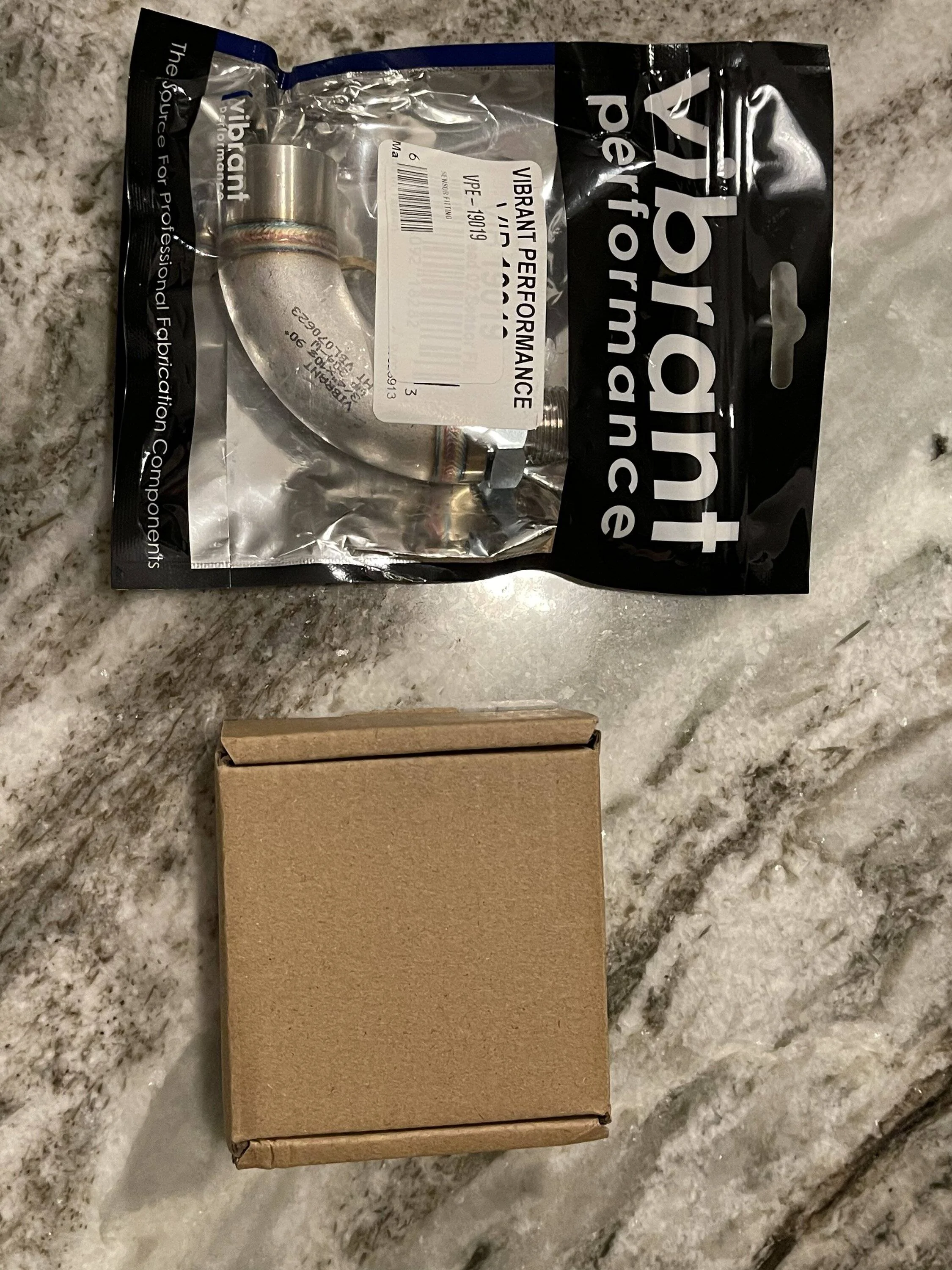

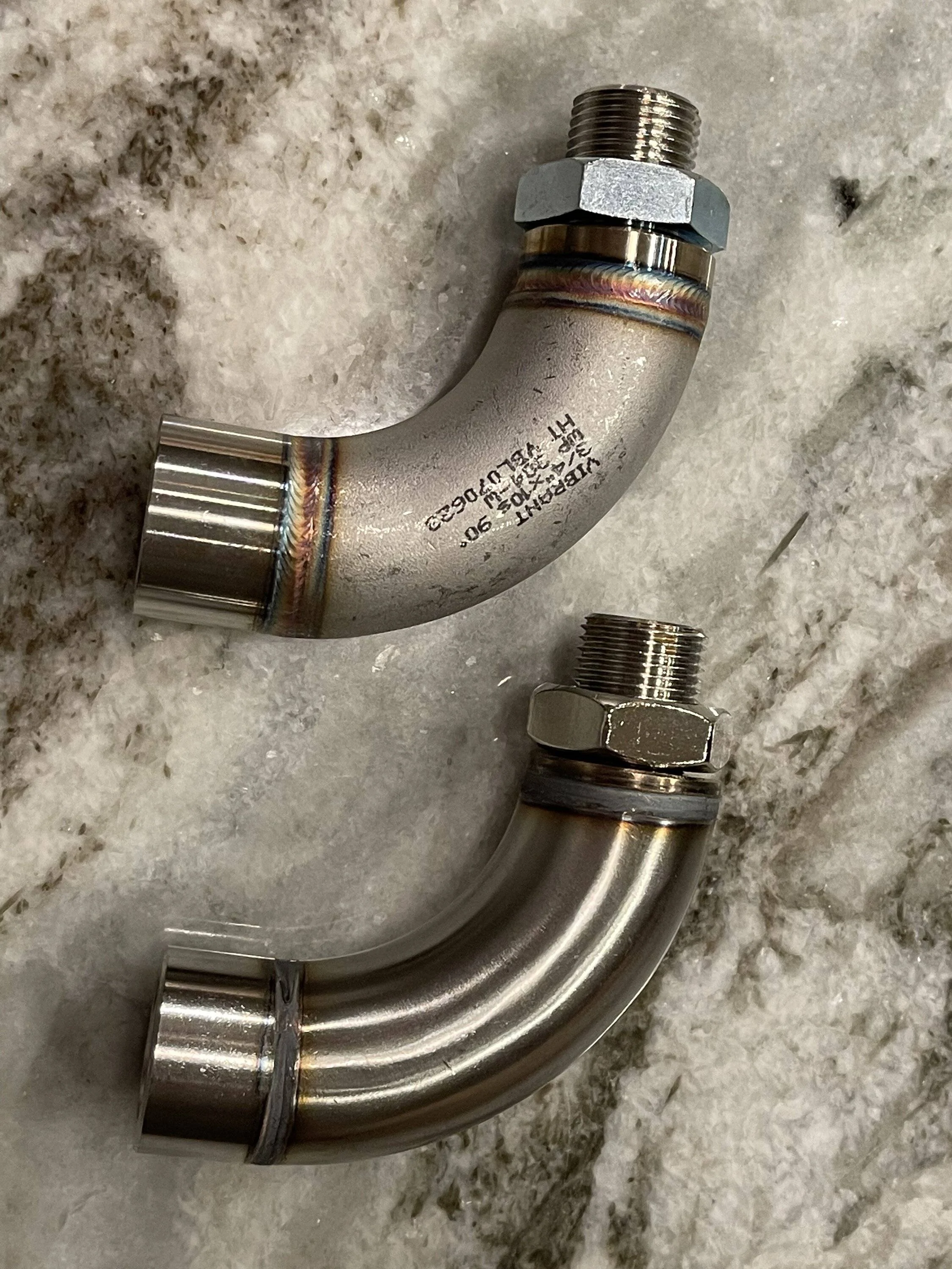

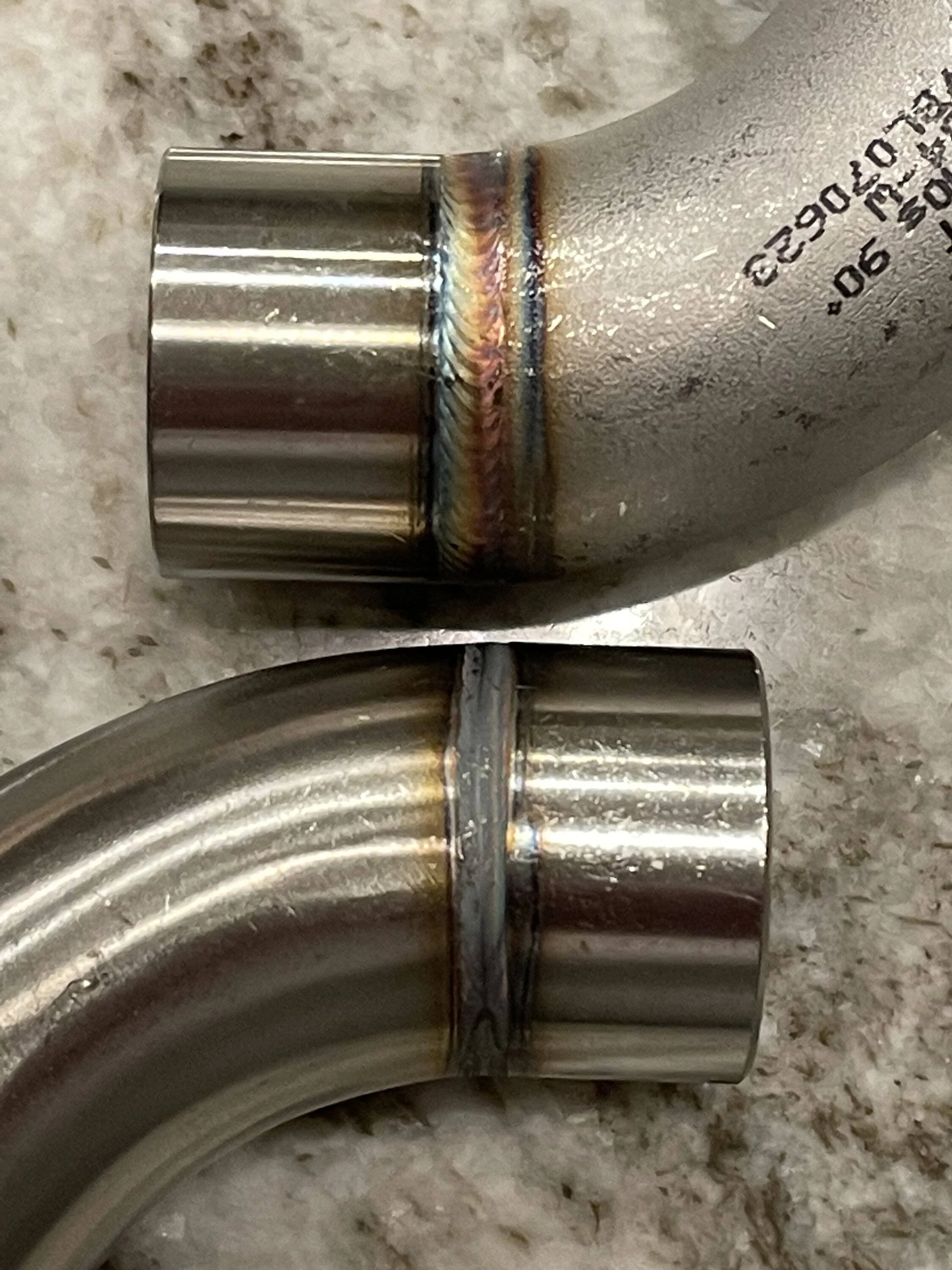

I got hosed on the “style” verbiage as well. The sellers name “Whoosh Racing” should have clued me in and that they were marketed for a Ford Focus down pipe. They were only about $10 cheaper than the real McCoy so it’s not like they were a steal. Thankfully I saw this thread before installing the knockoffs. I’ll eventually sell them with full disclosure on their origin. Maybe they will hold up, maybe they won’t. I’ll never find out. For educational purposes here’s some pics of the real deal and the knockoff including packaging.
