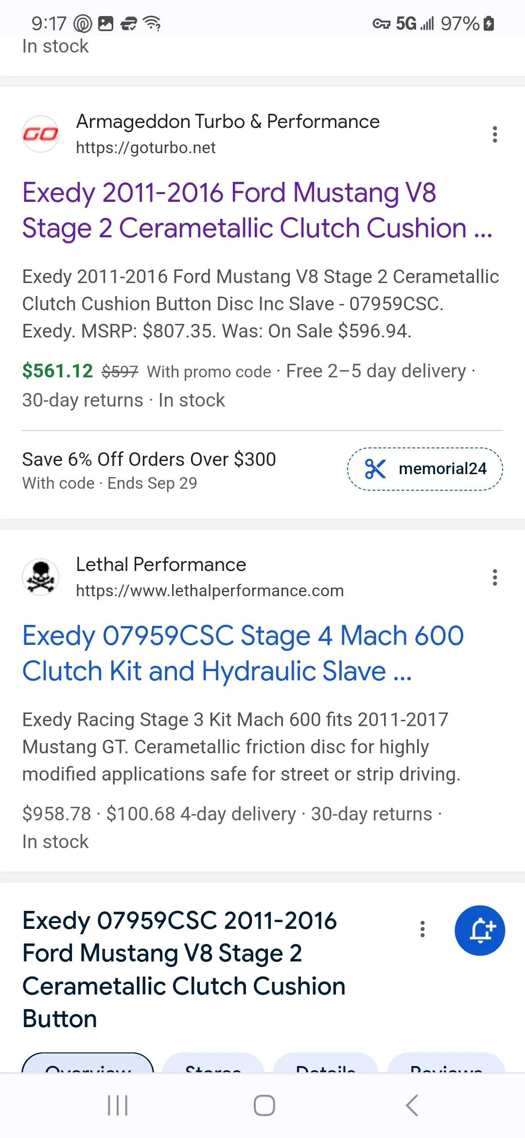

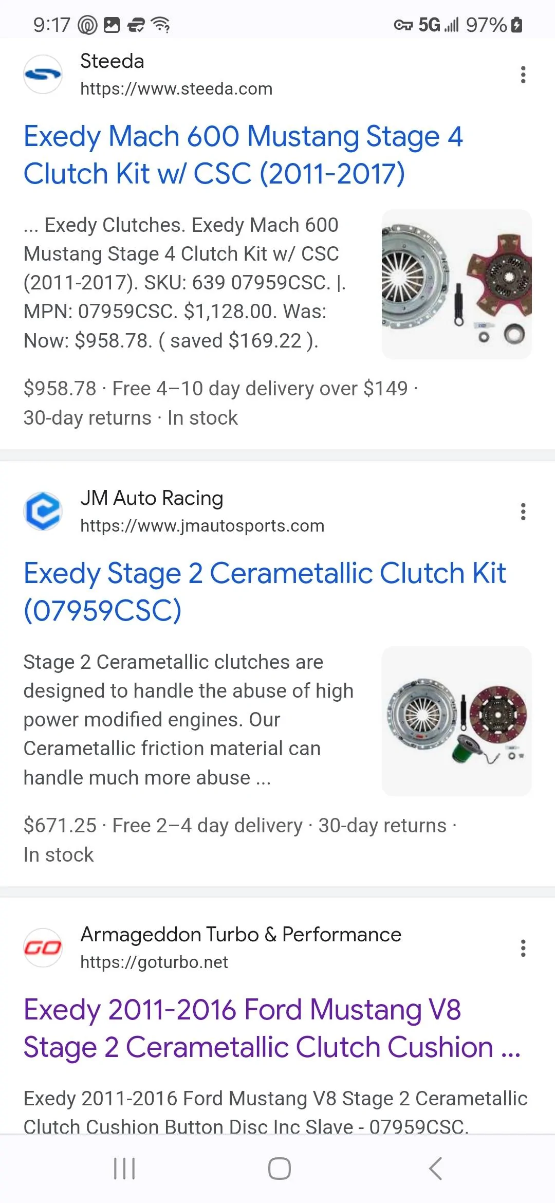

I noticed on some sites that the same exedy model number varies from site to another.
Exedy 07959csc varies from a stage 2 to 3 to stage 4. All the sites use a generic picture. Does anyone know if this is a stage 2 or stage 4 kit?
