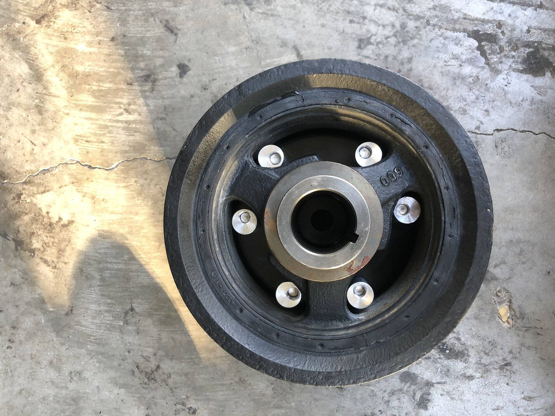

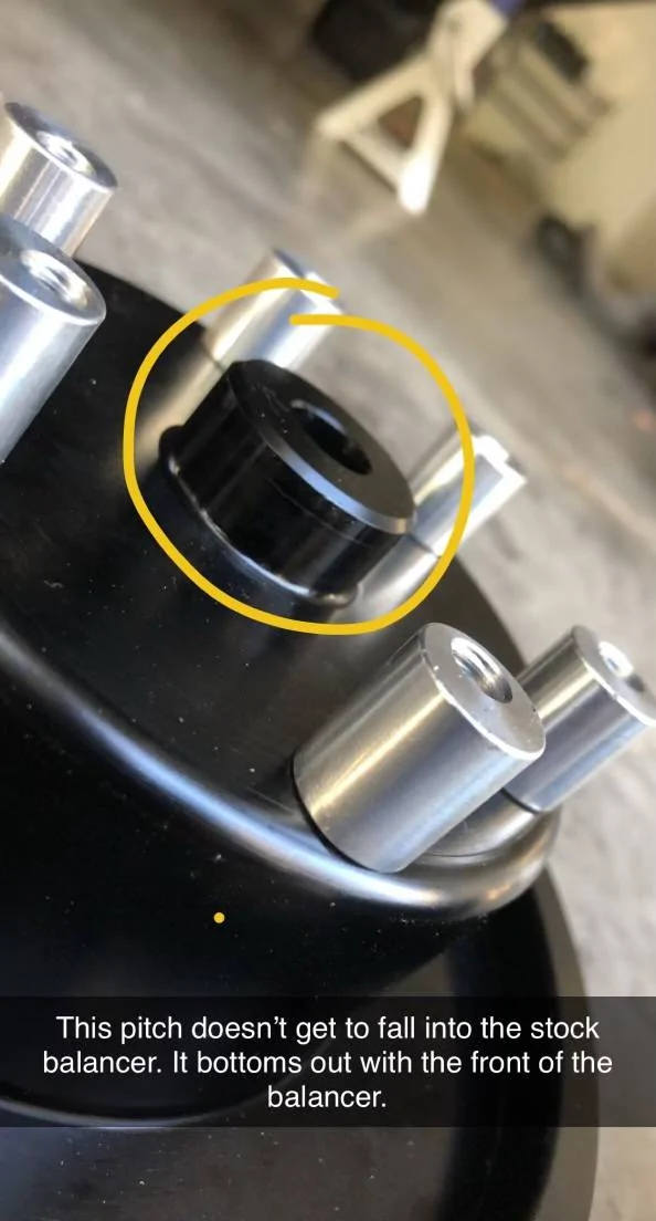

I have a 2020 pp1, I recently ordered a pro charger tuner kit with the 8 rib system but for some reason the pulley pro charger sent won’t fit has anyone had this problem before? It came in a bag specifically labeled for a 2020 crank pulley kit for mustang gt but doesn’t seem to fit.

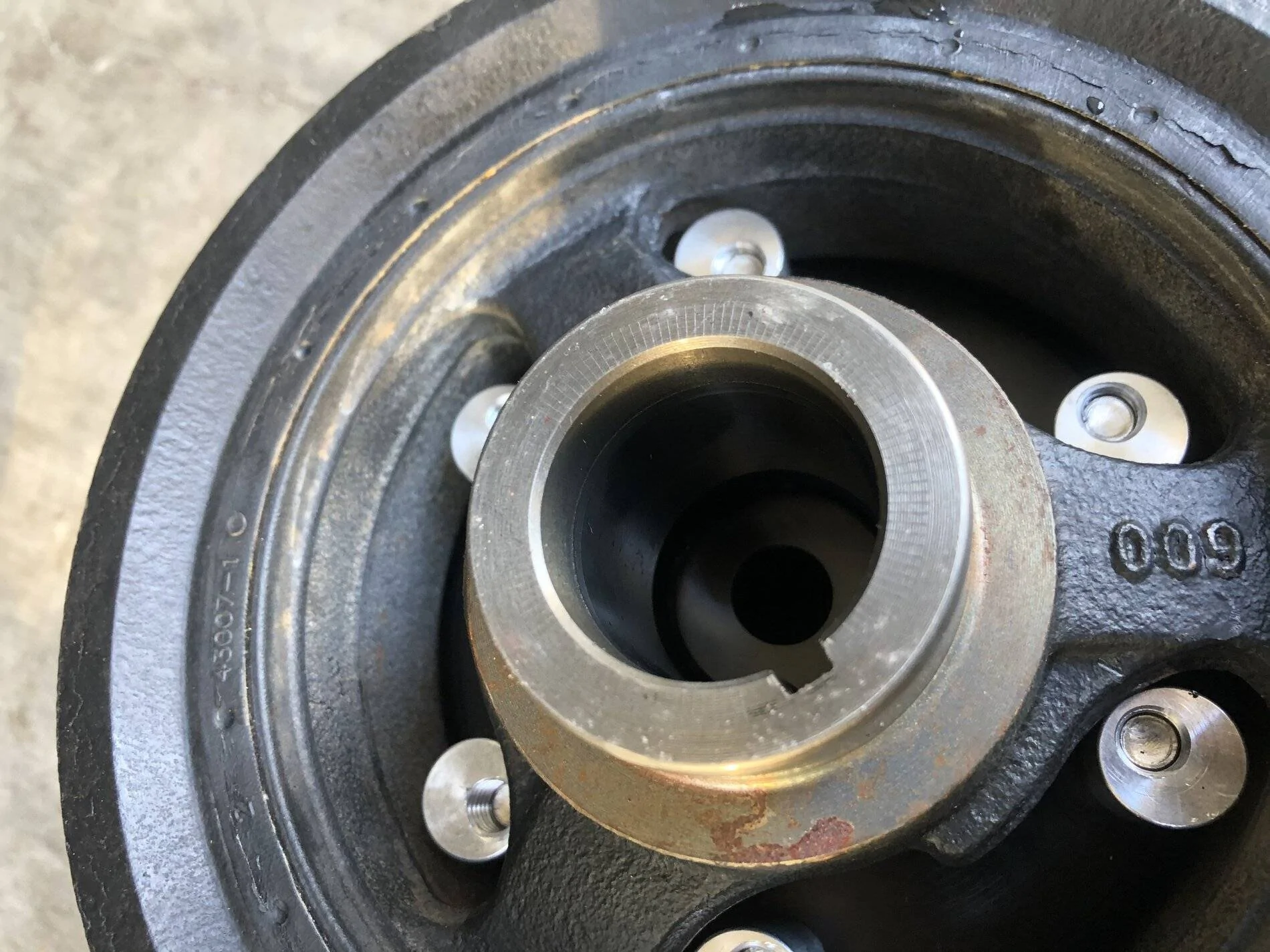

No personal experience but the shop that works on my car has this issue on a 2020 also. Crank pulley had to be machined. What does Procharger have to say?

Lets get some pictures and measurements. Give us something to help you with. What exactly doesnt fit???

Cam lockouts don’t seem long enough.

Pro charger is saying Ford changed the pulley on the 2020’s & they’re probably going to need me to send in my crank pulley for precise measurements.

I have a 2020 GT PP1 with the stage 2 p1x kit. My shop had to machine the pulley as well they said they tried everything to get it to fit but settled with the machine method. I was hesitant at first but everything seems to be working well, I’ve had the kit on two months now and daily drive the car.
hopefully procharger can get a fix out for the 2020+ cars.

Get in contact with pro charger, they will send you out a new machined one, the snout needs to be machined slightly to fit correctly. Yes it’s the same size 7.65
