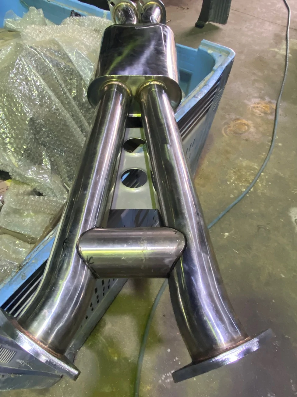

I would be interested if there was an option for a resonated version.

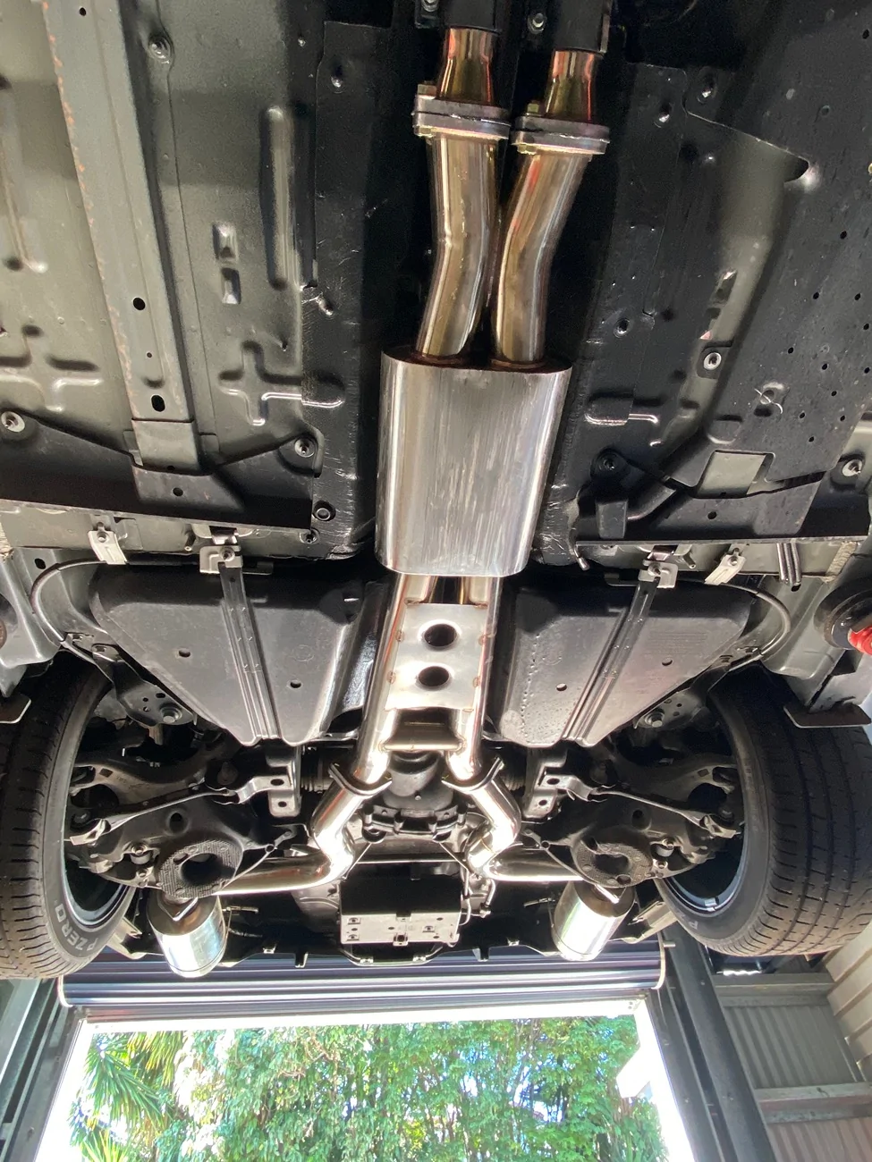

I recently made my own resonated X-pipe by just having 2 bottle style resonators welded in before the X. I also got rid of the neck-down in the stock exhaust where the clamps normally go

This is similar to what I did to my s550 X pipe set up and added a H behind the 3 inch straight though resonator. Deep tone , no drone.
It would be great if you did something like this and bring it to production. both with and without resonator.

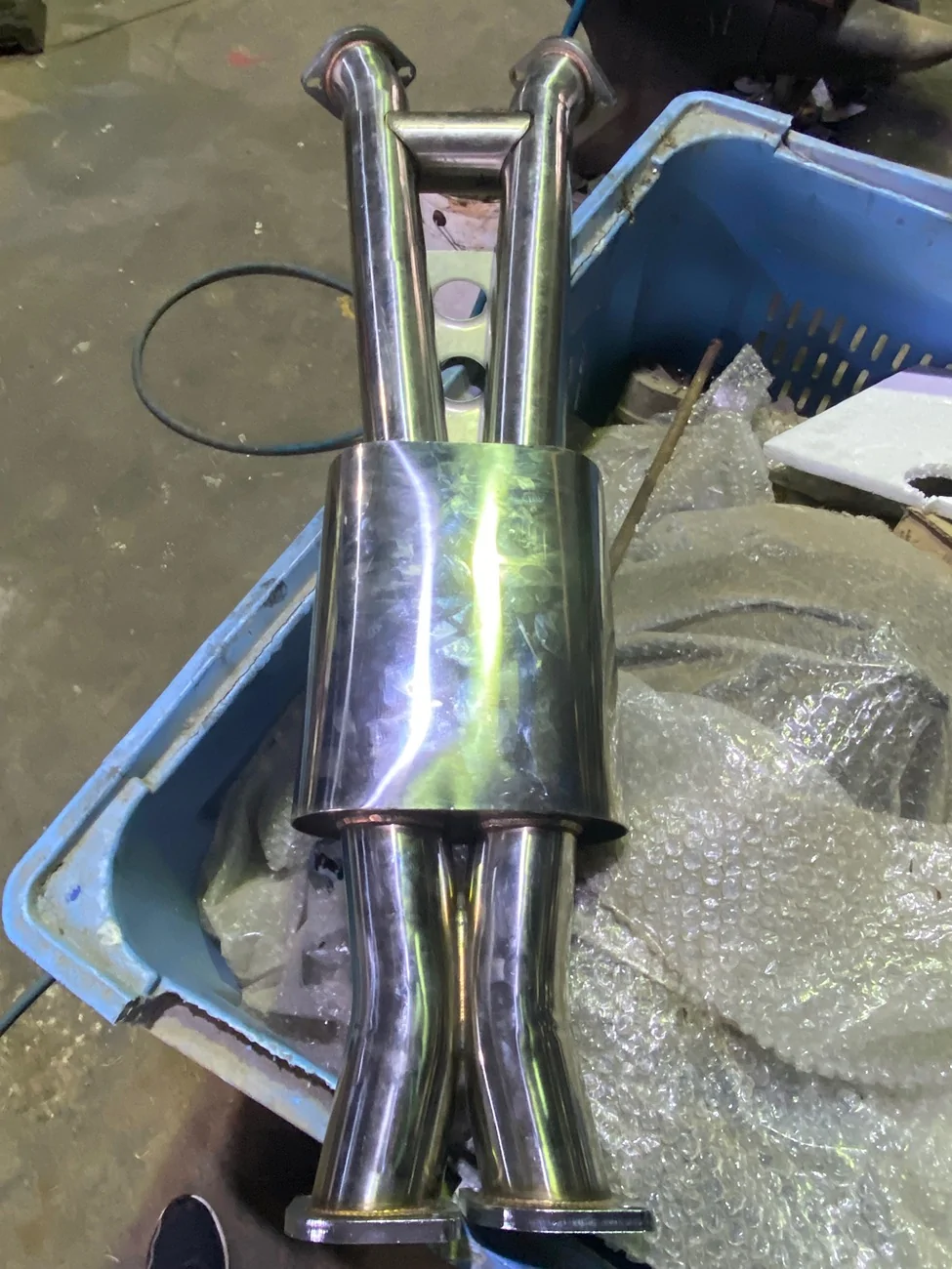

For those that had pondered changing the order, we did that too:
