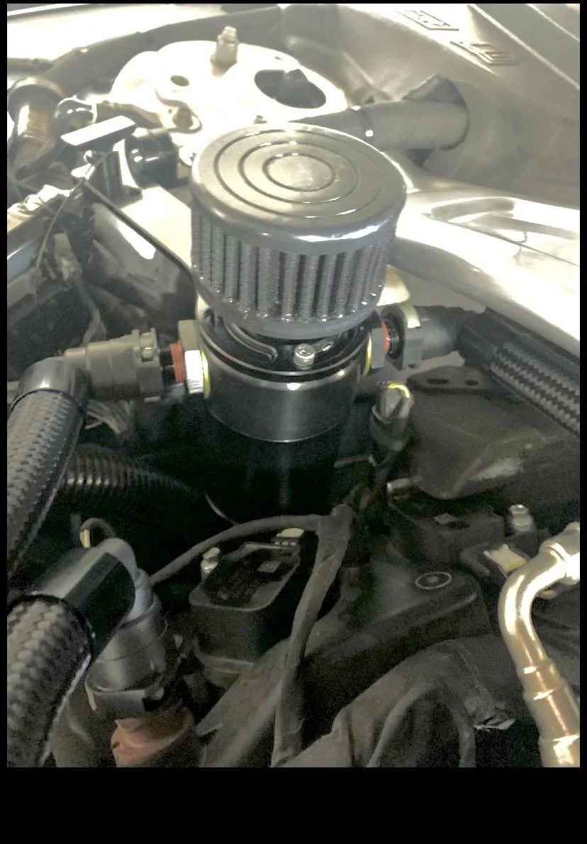

I am curious what benefit gutting the PCV has for these cars? I see some members recommend it when boosted and others don’t seem to think it matters.
For my specific setup I am boosted and I have a UPR dual vent catch can which routes both sides of the motor to a single catch can that has a breather on top of it (photo below).
My understanding is that gutting the PCV removes the check valve which is in place to allow air to escape but not enter the motor. So, if the PCV is only letting air out, what is the reason to gut it?

The PCV valve is a one-way device, but more importantly it's a restriction to limit the flow of crankcase pressure venting. If there is excessive pressure as in a boosted application the flow will leave both valve covers. Ideally you want a negative pressure in the crankcase which helps the piston rings seal and keeps windage to a minimum. Stock systems however don't maintain a true vacuum within the crankcase, if anything it's maybe just slightly below atmospheric. The drivers side valve cover draws in fresh filtered/metered air after the MAF from the intake tube. The passenger side is under vacuum from the manifold under part throttle conditions. In reality to increase vacuum in the crankcase you would place the restriction on the fresh air side of the engine and open the vacuum side to unrestricted manifold vacuum. In boosted situations, the easiest way is simply route both sides to a catch can with a filter on top as you have that will just vent to atmosphere, you would gut the PCV to allow maximum flow from the passenger side VC, but the crankcase would never have any vacuum, it's just simply vented to atmosphere.

Excellent response, thank you for the detail! Essentially, unless I want “max flow” my current setup is sufficient as both sides are routed to a catch can and vented to atmosphere. With both sides being vented, I assume that gutting the PCV would only provide a marginal increase in flow.
If both sides are vented to atmosphere you want to remove the valve, in that situation the valve is a restriction.

It's super simple, you no longer have a closed/recirculating system. All you have now is positive crankcase pressure at all times that should be vented, you wouldn't want anything that would limit that especially when boosted. There is no longer a vacuum there is no longer circulation/direction there is nothing that would be metered there is no reason in that situation to have a pcv valve.
Appreciate it! That makes perfect sense.

He's no longer using a controlled/metered recirculating system. Both sides are vented to atmosphere, the pcv valve is no longer needed.
If the tune was originally calibrated with the system functioning like stock then removing it in this way the tune will not need adjustment. If the tune was calibrated with the pcv set up improperly in a way that allowed a controlled air leak then it could be trimming out about 5 percent now.
