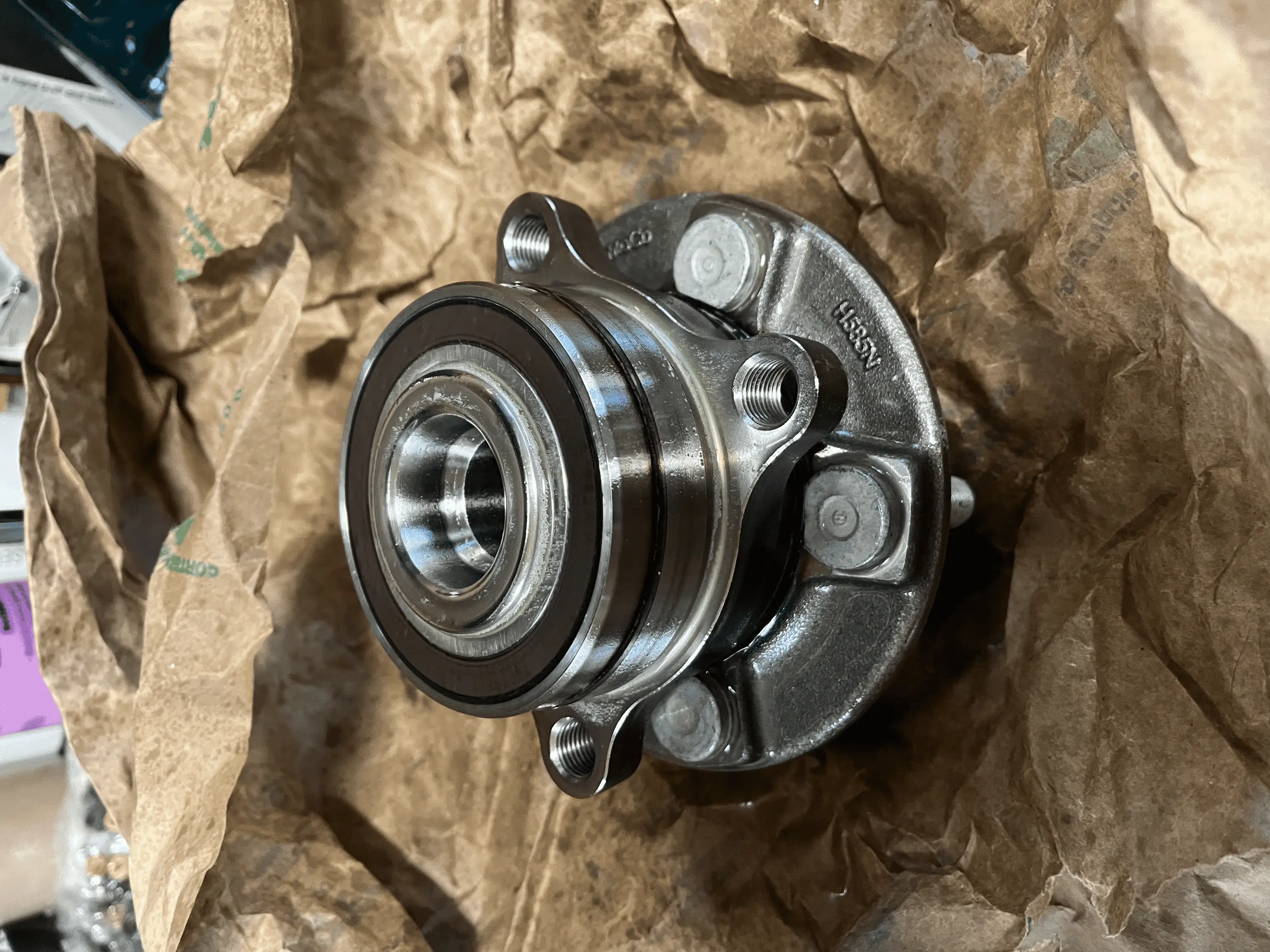

Was a really odd noise for a front wheel bearing, normally I have found those to make a groaning, whining or other type of continuous nose. This popping noise made me think CV but it wasn't. Always learning.

Was the FP replacement not an option for the M1? I believe they come with ARP wheel studs installed. Not sure if the bearing is an upgrade or if just the longer ARP studs are.

There might be replacement bearings with ARP studs pre-installed but there's not a "heavy duty" front bearing available for the Mach 1. This is per the Ford Performance info line (pretty good, knowledgeable folks).
